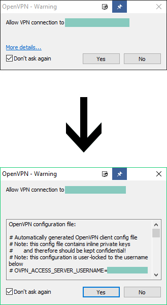

Hey guys,
I have successfully set everything up and it works perfectly. SSL and all. However, when a user connects and clicks "more details..." when asked "Allow VPN connection to...", the info presents the whole config file - something that doesnt feel right. Even the SSL information is there in plain sight.
Is that normal? Can one edit the data that is shown in this "More information..." thing? If so, how ?
I appreciate any help !
