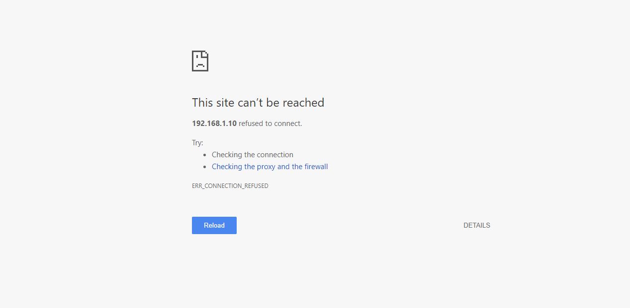

Hey all,
I'm trying to set up OpenVPN on my unRAID server, I'm following the video from Spaceinvader One (here), but when I try to open the WebUI I get the page below (The site cannot be reached) and I'm hoping you guys can help me out.  Sorry, I'm very new to unRAID and I've never used any type of VPN except what I use for work.  Any help would be greatly appreciated.  Thanks.
On 25.3.2016 at 1:45 PM, egtrev said:
I am unable to access the Web UI in Host or Bridge mode.
I noticed on my list of Dockers, that this one has nothing underneath "Port Mappings (App to Host)" and all the other Dockers do.
Could that be the problem?
On 25.3.2016 at 1:51 PM, Squid said:
In host mode you never see port mappings as the app has access to any port as it sees fit
I seem to have the same/ a similar problem as egtrev.
I tried reinstalling the docker but i honestly have no idead how to get it running/ to the web UI
These are my most recent Logs

6 hours ago, FraxTech said:
Hey all,
I was able to resolve my issue.  If you have bonding enabled to allow multiple NICs to work together, you have to set Key1 to "bond0" (or whatever the connection name is).  After doing this, I was able to get into the GUI w/ no issues.
