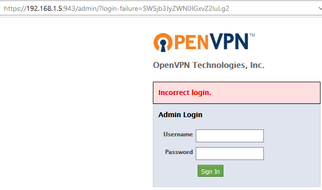

This is the 2nd time I've tried installing OpenVPN-AS, and I've had trouble logging in as any user other than default admin both times.
Here's my config screen:
Per the recommendations at Linuxserver's site, I've created a new users "localadmin":
I usually use KeePass to create long, complex, random passwords, but, because I've been having issues (which I thought may be related to pasting the password into the telnet session), I created a simple password for this account that I knew I could type correctly.
I've granted this new user admin rights:
I have authentication set to local so my users & passwords survive reinstall:
Yet every time I try to log in as my new "localadmin" I'm told that it's an incorrect login:
I've attached the log after the most recent login attempt.
If someone would point me in the right direction, I'd be most grateful!
I think you’ll find that the instructions linked in the OP are much more helpful-
https://hub.docker.com/r/linuxserver/openvpn-as/
Scroll down to the setting up the application section.
@gridrunner has also released a video-
https://youtu.be/I58LTMKyeYw
Its good for reference but a little dated with regards to admin user configuration.

Thanks, wgstarks. Seems I wasn't clear enough - those are the instructions I've been following (along with gridrunner's somewhat outdated video). I've done all these steps:
During first login, make sure that the "Authentication" in the webui is set to "Local" instead of "PAM". Then set up the user accounts with their passwords (user accounts created under PAM do not survive container update or recreation).
The "admin" account is a system (PAM) account and after container update or recreation, its password reverts back to the default. It is highly recommended to block this user's access for security reasons:
1) Set another user as an admin,
2) Delete the "admin" user in the gui,
3) Modify the as.conf file under config/etc and replace the line boot_pam_users.0=admin with #boot_pam_users.0=admin (this only has to be done once and will survive container recreation)
With the exception of #3 because the default admin account is the only one that will allow me to log in to the web interface.
I'd hoped that the screen shots provided would have shown that or shown where I thought I was following those steps but missed something.
I've created another user for me to use, but when I go to 192.168.1.5:943 to login using my user name and the password I created, I get a "Login Failed" message.
Doesn't matter whether I try "Connect" or "Login". (Still not clear on the difference - I'll get that sorted once I can actually log in.)
If you want to connect to the admin page you would use 192.168.1.5:943/admin
I tried that but it won't let me log in with my "localadmin" user:
Just to be sure, are you using this screen to create your local user?
Want to make sure you have set Authentication>General to local?
You entered a new user in the screen shown, with admin selected and a password in the proper field?
Saved the changes and updated the running server?
Nope, created the user from the command line as demonstrated in gridrunner's video. Nothing contradictory to that in the LinuxServer page, so I ran with it. Is it now preferred to create the users in the admin console instead of at the command line?
IIRC, using CLI doesn't create the user in the local database. Log in with the default admin user and then add the new user in the gui as I described. Once you have verified that that user is working delete the default admin user in the gui and run step 3 from the dockerhub page to be sure the default user doesn't get recreated during updates.
Let me know if this works.
That did the trick!
I really appreciate the work @gridrunner has done with his video, but it seems that it really needs to be updated. Additionally, since so many places around here point users to that video, it would be super helpful if the linuxserver page contained a couple of notes on what's out dated and the current best methods. (hint, hint, @CHBMB :) ).

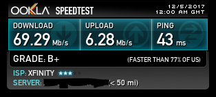

I've got port 943 forwarded to my server and from my phone (WiFi off) I'm able to browse to https://domain.com:943 where I can log in with my newly created user name & pwd. I downloaded the .ovpn autologin file, opened it with the Android OpenVPN client, but now it's timing out every time I try to connect. CPU load on the server ran about 25-50% with a few spikes to 60-75%. I've got decent network speed:
That's about normal for my hourly speed test runs.
