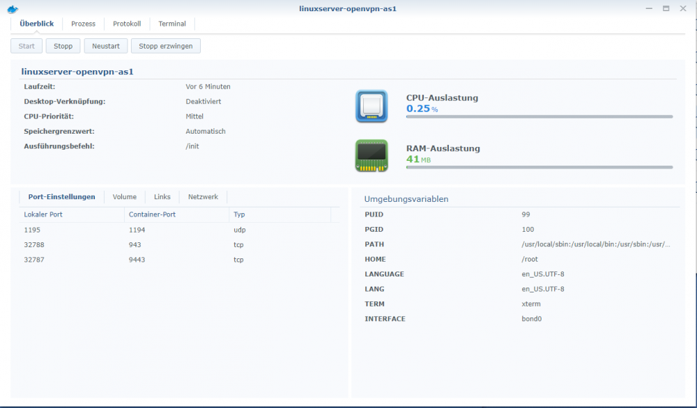

Hey guys,
any ideas? I'm always gettin connection refused on "192.168.1.35:1195/admin".
Also tried eth0 as INTERFACE variable.
I'm using Synology Docker with DDNS.
This is the unRAID forum. LinuxServerIO has another forum to support their dockers on other platforms. From first post in this thread:
On 10/6/2015 at 4:36 PM, linuxserver.io said:
If you are not using Unraid (and you should be!) then please do not post here, rather use the linuxserver.io forum for support.
