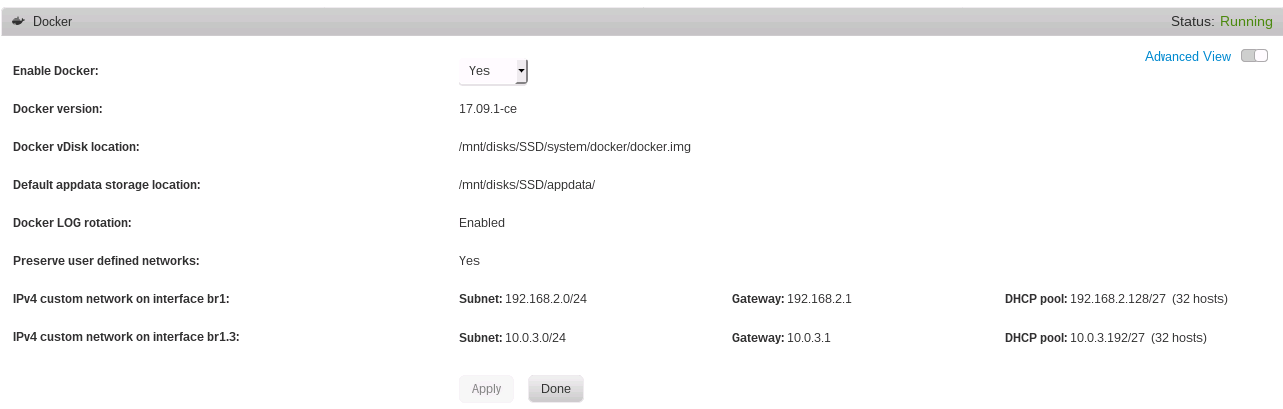

that's really weird. Can you show your network settings? and the docker network settings?

1 hour ago, jfrancais said:
Got a little further, when I set my OpenVPN-AS to TCP (disabled UDP) I can now connect to the OpenVPN-AS server from the outside world.  I have the exact same issue as before.  When I connect the OpenVPN-AS server docker container that is setup to use br1 and an assigned ip, VPN clients can talk to other docker containers on br1 but not unraid host, router or internet.
There should be no difference between the OpenVPN-AS container vs other containers.
are VPN clients assigned to a different subnet? please include that too...
