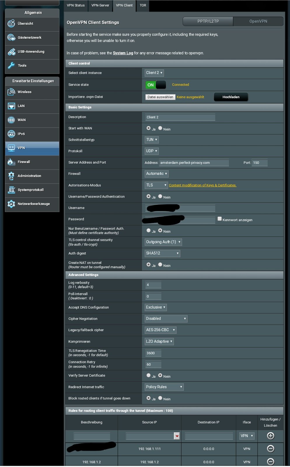

I've try this, openvpn docker as host.
If i start the other vpn client (on asus wrt merlin Router) i get no connection to unraid anymore.
(Because all traffic from unraid will go through vpn client)
Can i setup that only out going traffic throuh vpn client.

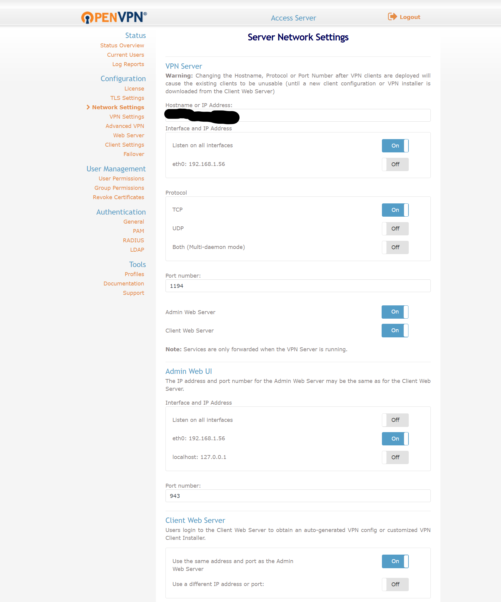

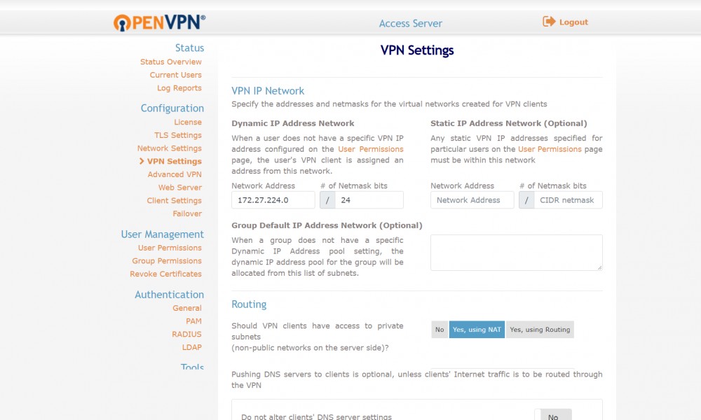

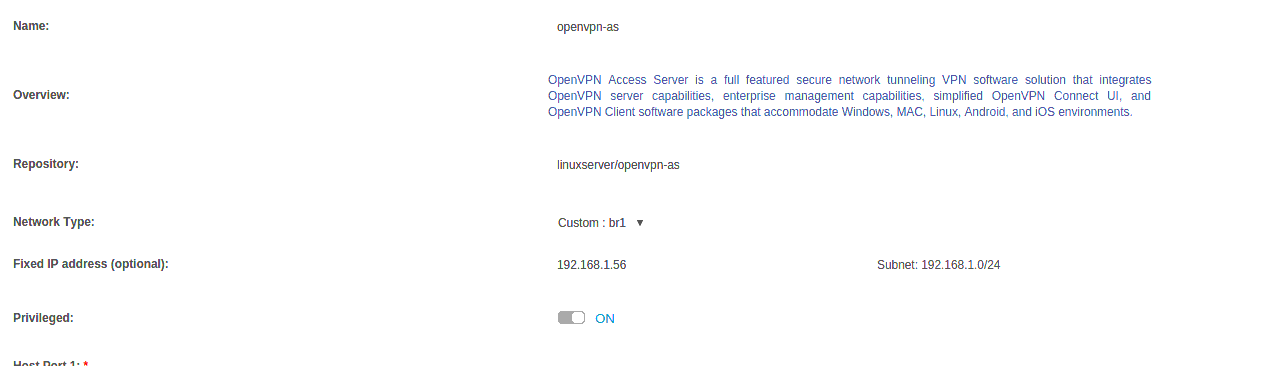

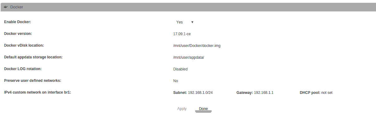

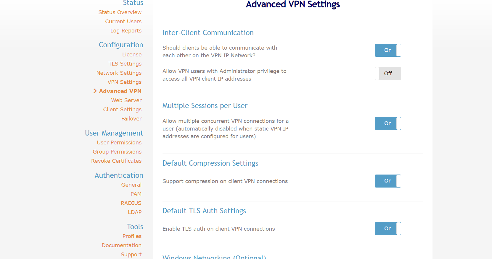

I still can't get this to work.
I can connect to the Unraid server's OpenVPN server. But none of the services on my home network are available. 192.168.1.1 (router) or 192.168.1.50 (unraid server) aren't available, neither is anything else.
Also after only about 2 minutes it disconnects me and says "Invalid credentials". Even though my credentials are fine and they work to login in the first place.

Also it seems to be assigning me some kind of local I.P. like 172.27.244.** when really I think I am meant to be 192.168.1.** or something.
What am I doing wong?

Ok, Sorry, I finally got back to this.  Just to rehash.  I now have 2 nics in my unraid server.  I removed the br0 network.  I created the br1 network with the eth1 nic in it (eth0 is the unraid server primary nic).  I moved all my docker containers with static IPs into br1.  I shelled into the openvpn-as container and verified I can ping the unraid host and my main network router by ip and by DNS name.  I can do dns lookups (dns server is my main router 192.168.1.1) so it appears I have the docker problem worked around.
Problem is, my openvpn connected clients still cant access resources.  Once connected to the vpn I am still having connectivity issues.  The VPN clients cant ping or access the unraid host (192.168.1.207).  They can ping my main router (192.168.1.1) and other docker containers by ip (headphones container at 192.168.1.57 for example).  They can't do DNS resolution at all (tried nslookup tool using 192.168.1.1 as name server but it times out, same as using 8.8.8.8 as name server).    I have attached screen shots of what I think would be useful settings.  Any assistance would be appreciated.  I'm banging my head against the wall on this.
@jfrancais Can you access the unRAID gui by going to 172.27.224.1?

I added the following in the NAT table from your last picture:
192.168.1.0/24
and I also added some other internal 172.XX. subnets based on other dockers
192.168.1.0/24
I dont follow you.  Where are you putting this?

I don't think it's two concurrent connections, but two concurrent users. You can have multiple devices/connections using the same user account. Iirc I tried connecting with 3 devices at the same time all using the same account and it was fine.
thanks for that!
@aptalca just tested this and it don't work for me - when i connect second device with same username, already connected device gets disconnected.. what i'm missing? i have checkbox in settings to allow multiple sessions per user...
Edited by uldise
14 hours ago, uldise said:
thanks for that!
I connect 2 devices through the same user account on a daily basis. It must be the settings.

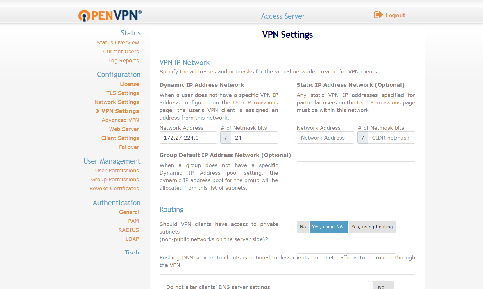

In either the user accounts under show more info
Or in the box at the bottom of the picture you shared.  In the routing box with yes, using NAT
Gotcha, unsure why that wasnt in my screenshot, private subnets should be given access to there is:
172.27.224.0/24
192.168.1.0/24
So I believe I have it set like you are suggesting and still doesnt work
i'm running on approx default settings, switched on google authenticator..
have you any clue which settings should i check?
