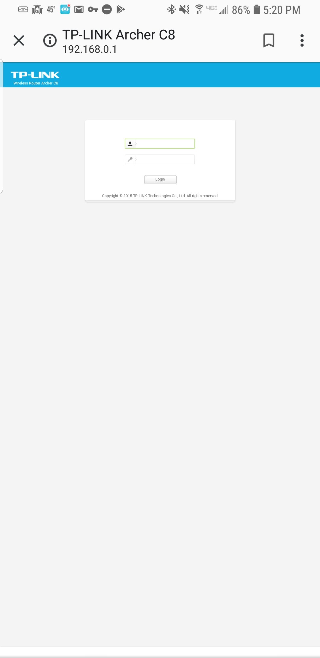

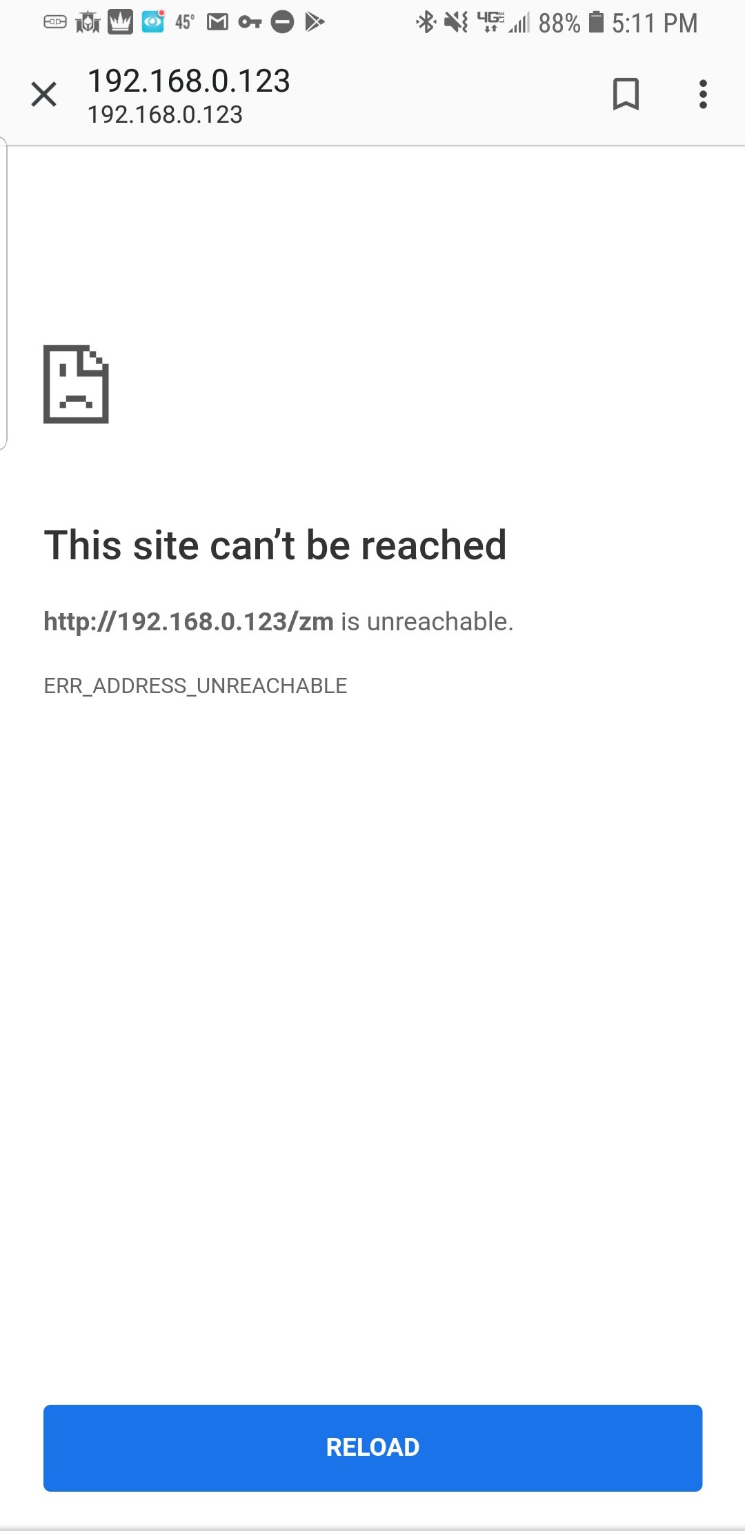

Hi folks.  I have this docker installed and mostly working.  It seems I can not access all of the IPs on my lan.  From outside my lan I can access my router and the unraid server but not other docker IPs.  I'm trying to get access to a Zoneminder docker with it's own IP but just get an error.  I can access the .123 address from within my lan and also if I forward my external IP port 80 to the .123 address but I would rather not have the port open.  This seems like a similar issue that jfrancais is having above.
I'm not sure what pages of the OpenVPN docker to post for info or if this is even the right place to ask for help with this.
Screenshot_20181112-172029_Chrome.thumb.jpg.164a27236722230f44d31c29bd0b9320.jpgScreenshot_20181112-171117_Chrome.thumb.jpg.4004e204021f8b2c9e1f2f8d9e47a2d6.jpg

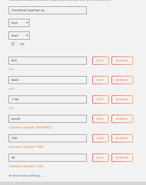

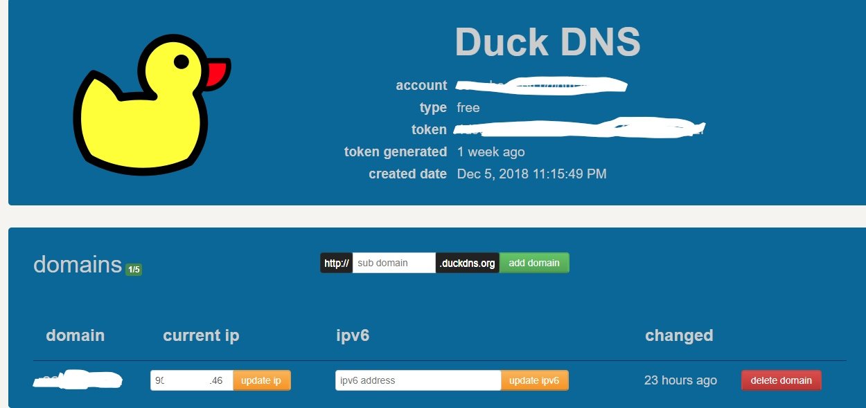

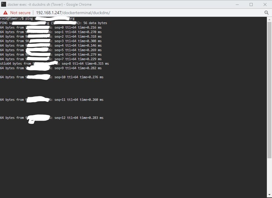

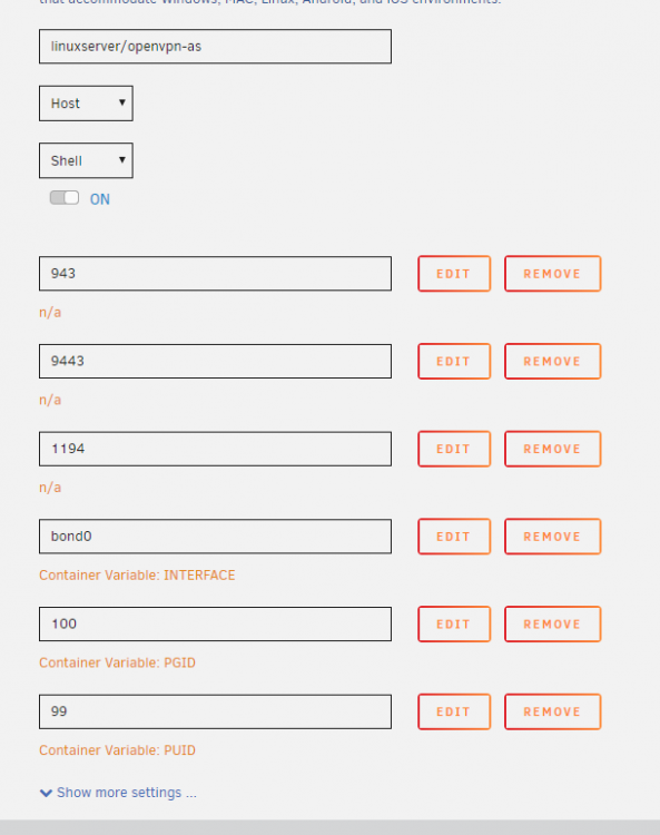

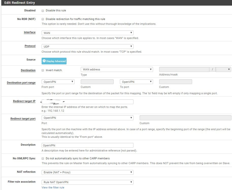

Hello,
I am also having trouble getting this docker to work.  I have configured the docker, set up a duckdns account, and configured OpenVpn.  I have forwared the port in pfsense and set that up, but i can not connect from a client.  It keeps telling me that it is unable to connect.  I followed the same tutorial that a lot of people on here mentioned posed by spaceinvaderone.  I am not sure where i am going wrong.  Any help would be appreciated.  let me know what information that i should post to help diagnose the issue.
Here are some screenshots of settings.  Any help would be greatly appreciated!!!
InkedSnipaste_2018-12-14_20-14-42_LI.jpg.77a0b65910416d4e096a8eb95a858f70.jpgInkedSnipaste_2018-12-14_20-21-15_LI.thumb.jpg.3ea9f44327dc29e158b939937a33ee73.jpgInkedSnipaste_2018-12-14_20-23-33_LI.jpg.c7f7a40c6a55aad1828a1388c74270b9.jpg

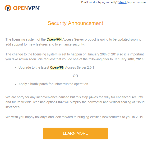

Not sure if anyone else pays for a licence but OpenVPN is changing their licencing structure and an update to 2.6.1 is required to support it when the change happens on January 20th 2019. Currently the latest version this app supports is 2.5.2, are there plans for an update before the 20th to at least 2.6.1 version?
Screenshot attached with the email from OpenVPN support. The link goes here: https://openvpn.net/security-advisory/action-needed-important-update-for-openvpn-access-server/?utm_source=sg&amp;utm_medium=Email&amp;utm_campaign=serverUpdate
Edited by k2x8
I use this docker app and here its running on 2.6.1 :S, i use CA Auto Update Applications to do fully automatic updates. didn't pay for any licence, the free version is enough for me.
