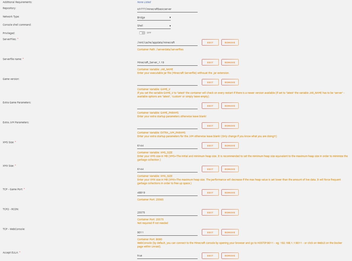

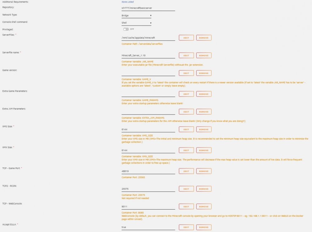

On 6/30/2022 at 8:51 AM, Welchiepoo said:
appdata use cache is set to "yes"
In your case this is really bad because how it's configured the Mover will move the files from the Cache to the Array.
You have two options, set the path in the template instead from /mnt/cache/... to /mnt/user/... or you can set the Cache to Prefer or Only.
I would also recommend that you remove the container, also the minecraftbasicserver folder from your appdata directory and then pull a fresh copy from the CA App with the changes applied from above, but please only one.

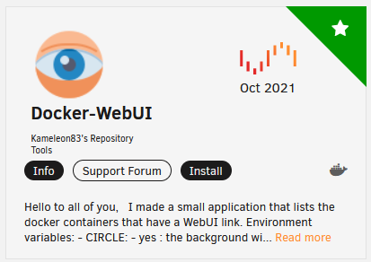

I think i need something to check if anyone is connected to the GameServer. If not it should stop or suspend. And if someone is trying to connect to the GameServer it should register it and start the GameServer again.
On 7/1/2022 at 8:34 PM, ich777 said:
This App is only to open the WebUIs from the Dockers.
Then you have to use RCON (if the game supports it) and make it dependent if someone is connected that a message is sent to the users that the server is restarted in n minutes and after that restart it.
Okay, then I can't help with that, maybe make a request for such on app an the Plugin Support forums.
Maybe someone is willing to create such a thing.
I have to also say that I really don't recommend that users can start/stop servers, can be very bad sometimes...

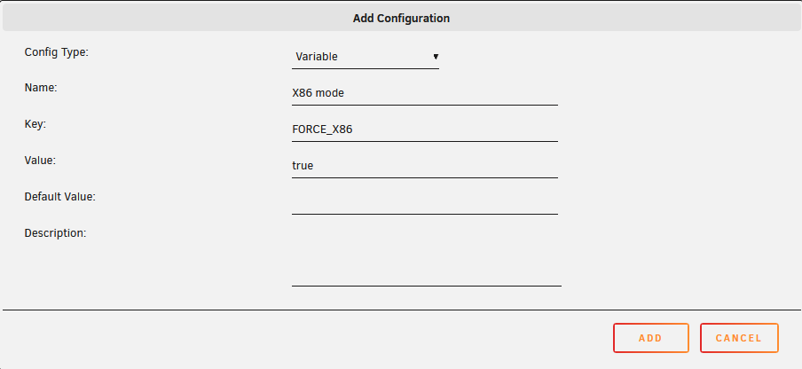

However, I'm running into an issue with your Arma 3 server unfortunately. Logs giving me the following error:
/opt/scripts/start-server.sh: line 63: 68 Segmentation fault ./arma3server_x64 ${GAME_PARAMS}

10 minutes ago, Snailpower said:
Any idea what could cause this? Do you or others have a similar issue with the Arma3 server app?
Yes, a user on GitHub requested that I should switch over to the 64bit version from ArmA3 by default, but that gives me so much trouble in the last time that I'm not sure if I should switch back over to the 32bit version.
You can do this manually by adding this to the container template:
Please report back if it fixes the issue.
Thanks for the super fast reply and fix, it boots succesfully now. I'm gonna try to add some mods to it using a previous post of yours. The one about adding a script to auto-update mods. Thanks for all the great docker containers and support! You're a real unraid hero :)
This worked.  Thank you!
