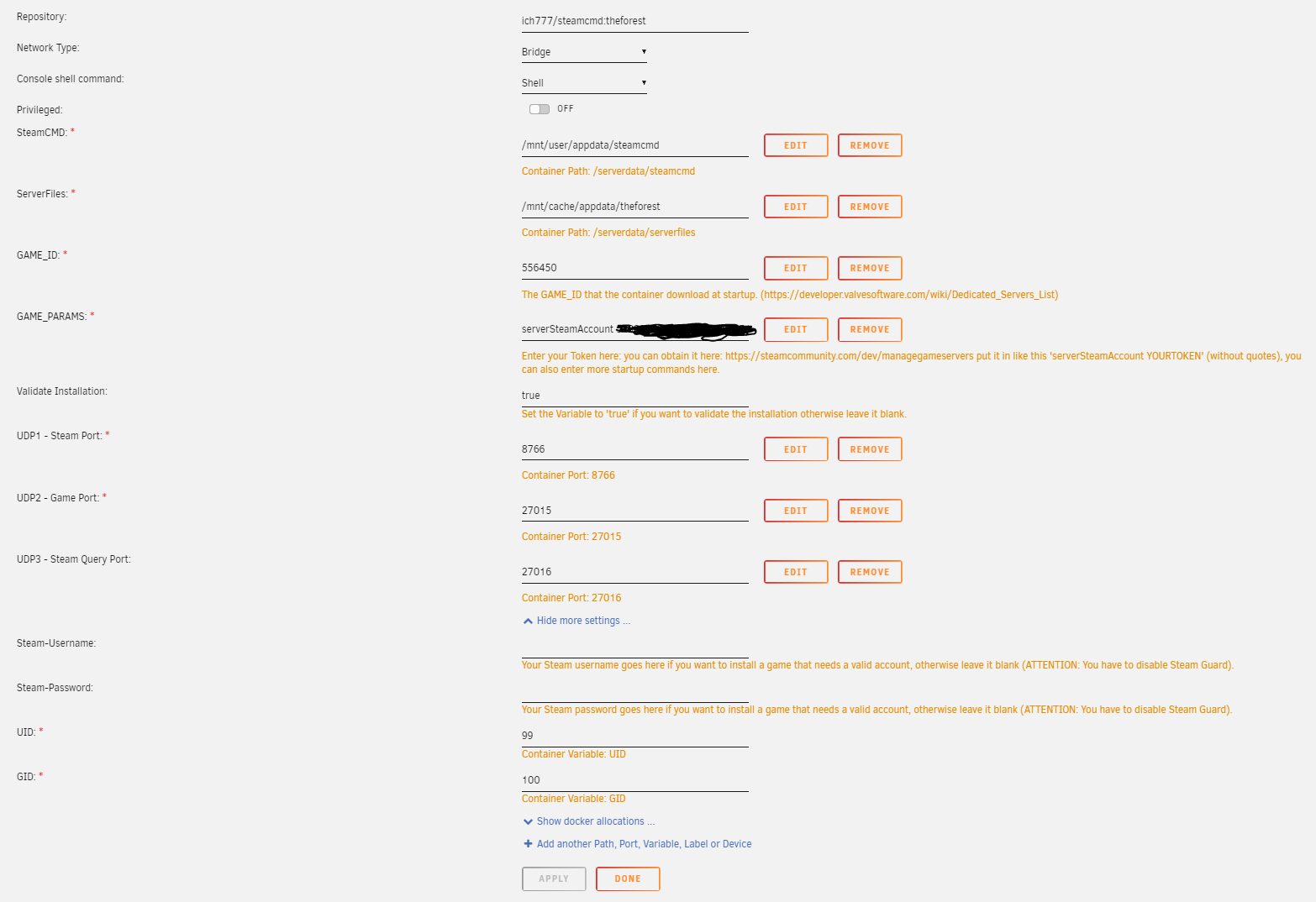

Hi ich777.
Firstly thanks for all the containers! They've been a godsend and make it super easy to run game servers
I'm currently running into an issue with the "The Forest" container though
It seems to  run into an error where it "Could not find dependent assembly L"Microsoft.Windows.Common-Controls" (6.0.0.0)
wine: could not load kernel32.dll, status c0000135"
It then resets the container in a never ending loop.

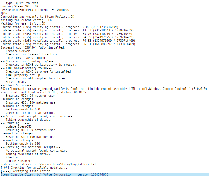

Logs (one loop):
Container Setup:
Please let me know if you need anything else for this, appreciate any support you can provide
Cheers,
Dr Rockso
Edited by DrRockso
Updating spelling, attachments and descriptions of files

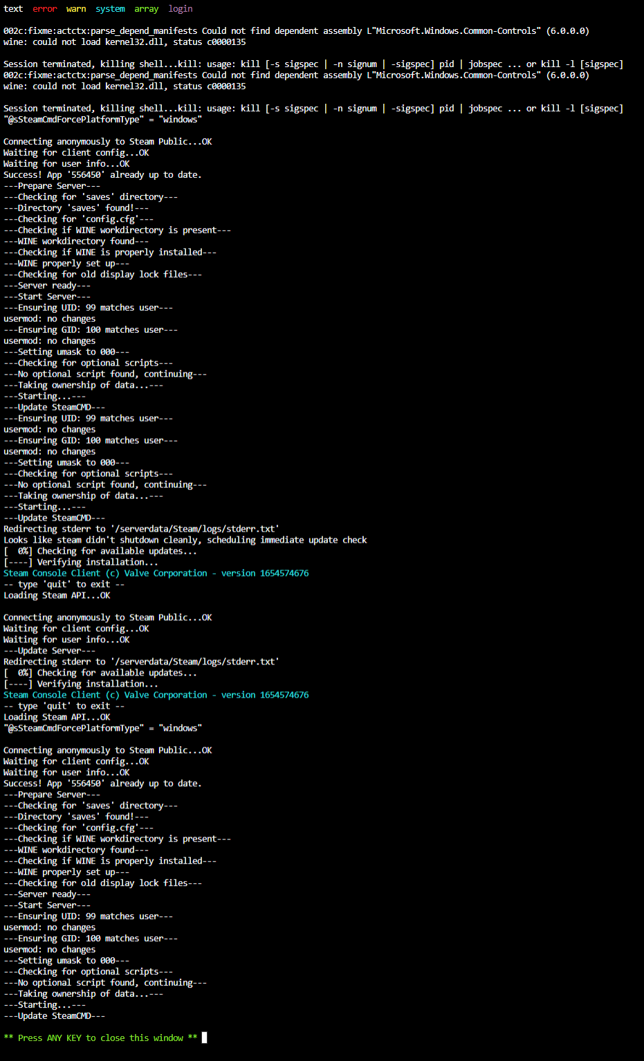

Thanks ich777, I've updated my Unraid version to 6.10.3 but unfortunately I still can't get the container to work
Container logs are:
After the cycle the logs page closes now
It still references the "Could not find dependent assembly L"Microsoft.Windows.Common-Controls" (6.0.0.0)
wine: could not load kernel32.dll, status c0000135" right at the top of the logs and seems to be the 'reset' point for the container
Container config has not been changed
Let me know if you need anything else
I will look into this shortly.
No issue over here:
I've also attached the log from my server startup, please keep in mind that this is a completely fresh install: TheForest.log
Maybe try to:
  1. Remove the container
  2. Remove the theforest folder that lives in your appdata directory
  3. Pull a fresh copy from the CA App
