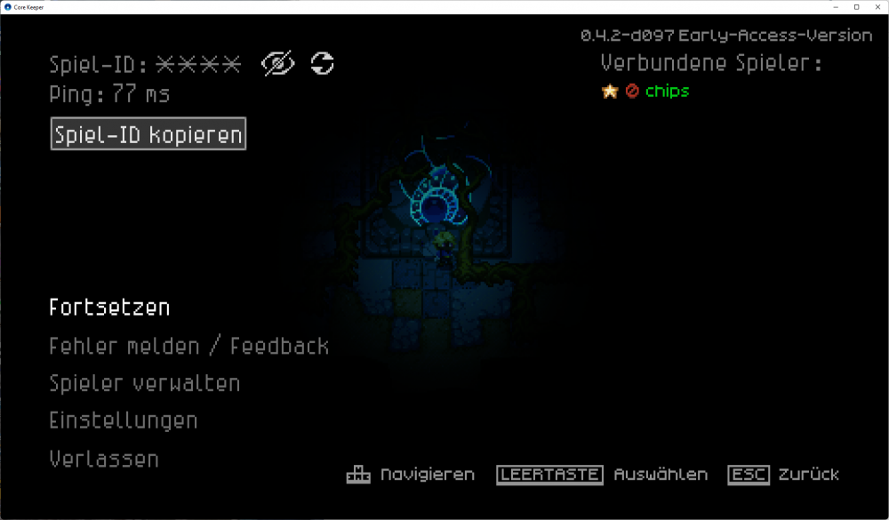

42 minutes ago, HubertusPrime said:
CoreKeeper connection issue:
Is your server still running?
Since you've posted a screenshot from your GameID I've tried to connect but it times out...
I've now pulled a fresh copy from the CA App and it works just fine over here.
Have you yet tried to validate the game files on your local computer? Maybe the game files are corrupt...
If you want me to try to connect to your server let me know and send me the Game ID or at least start the server so that I can try it.
You can also try to connect to my server if you want to but I think this is more of a Client side issue in your case.
Took a screenshot here:

Oh sorry! Didn't mention, that i blanked out half of the GameID for safety. I tried a bit and it's joinable from my laptop, but not from my Steamdeck. So maybe it's a Linux issue? I can PN the GameID if you want.
Thank you for helping
Sure thing... send me a PM, but I don't think that much will change...
I have to wait a little longer for my Deck to arrive since I've preordered a little too late... :/
So I really can't tell what's wrong on the Deck.
Solved the problem! Preset it starts with the latest version of Proton on my steamdeck. Changed and forced this to use Linux Runtime, deleted proton files —-> works like charm!
thank you very much for your work 🙌
