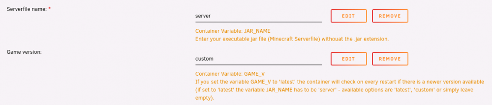

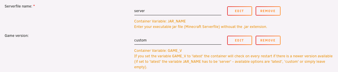

5 hours ago, maereax said:
Java, MinecraftBasicServer
That's actually pretty easy, let it pull the latest version and then change the game version to custom and make sure that the jar file in the main directory for the container is in there and named "server.jar", if you wan't to switch over to another version simply download the according server .jar file and name it "server.jar" and put it in the main directory by replacing the existing one.
You can of course name it differently but then you have to change the Serverfile name in the Docker template eg: if you name the file "mycoolminecraftserver.jar" you have to change the Serverfile name in the template to "mycoolminecraftserver".
Hope that helps.
