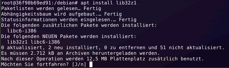

9 hours ago, capt.shitface said:
apt-get install lib32z1
Did you run:
apt-get update
in the first place?
This should give you this:
(sorry that this is in German but it should be similar in your case...)
By default I remove the package list before pushing the container to DockerHub and GHCR.
Please report back if this is working and solves your issue then I will add it to the container.

Im ashamed! Of course!
I blame it was late!
No worries... Happens to the best... :)
Updated the container and this library is now included. ;)

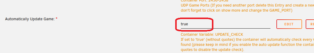

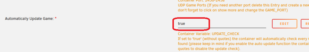

This container has multiple Auto Start/Restart things in place:
The first one is for the container itself is if it crashes or you are somehow able to end the container it will automatically restart:
The second one is that the container automatically checks for updates and restarts itself if a update is found:
And finally the third is what @exist2resist already pointed out that the container itself is started when the Array is started, but you have to enable this by default for the first time because autostart is always off by default:
