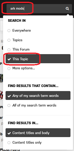

Unfortunately I can't search the thread or just don't know how too.
This should help:

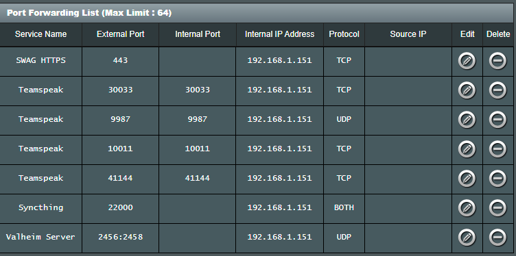

Reason I ask is because I am having issues accessing this from the outside world, locally it works fine. Port forwarding is setup, so it shouldn't be a problem but you never know.
Have you yet tried it from another computer not within you LAN?
I can confirm that the container is indeed working because I‘ve set one up on a friends server.

So connectivity is good.
Yes I tethered my Steam Deck to my cell phone and tried connecting to the server that way.
I just tested it again and it's working now, I didn't do anything so not sure what it was, maybe ISP or something.
