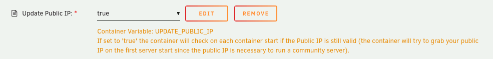

Found what might be my issue with people outside my network connecting. I'm using cloudflare. When I check in the logs for palworld and Battle metrics, it shows my server as online and shows public ip we will call IP1. When I check my server domain Ip on one of those IP lookup sites, I get a different public Ip we will call IP2. I'm not sure which one is actually my correct public ip for people to connect to.
Are you sure that you are not behind a CG-NAT?
You can change this to true in the Docker template and it will obtain your public IP on every start which is also displayed in the log from the container:

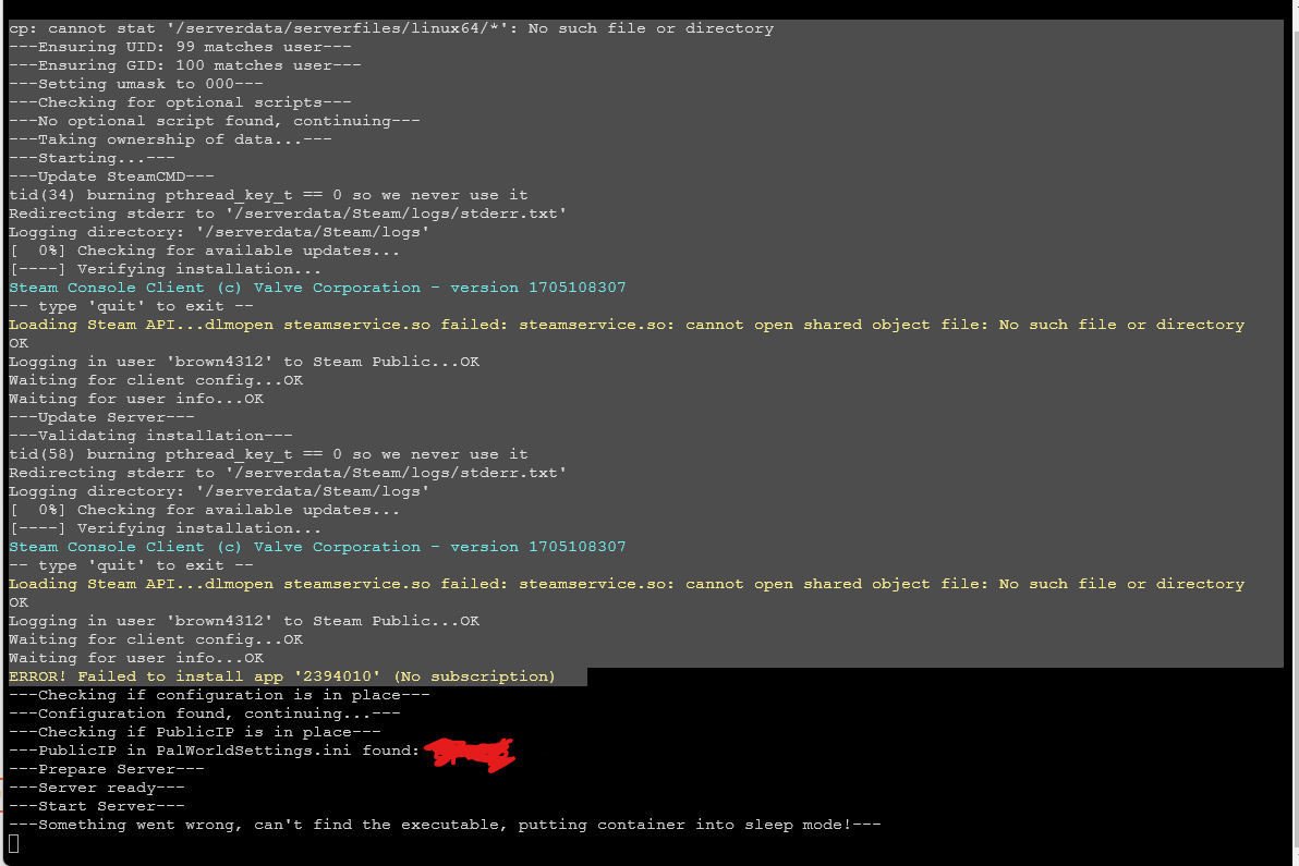

Hi, thanks a lot for your work on all those docker server.
I might be dumb but I don,t get what I'm doing wrong here, any help would be appreciated, I tried checking if any other had the same issue couldn't quickly find it. If a thread is already there for that could you point it out and I will read it.
thanks for anyone time.
Why did you added Steam credentials? They are only needed if they are not hidden away under the "Show more settings..." and marked with a asterisk.
Please start over by, deleting the container, deleting the folder that was created for the container for palworld and pull a fresh copy from the CA App (without providing Steam credentials in the template).
