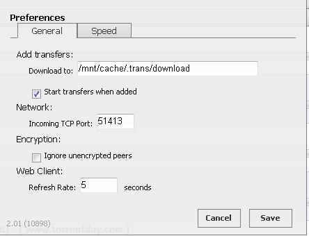

2. I noticed that the web ui has an Add Transfers setting.  Is it the torrent watch folder, the incomplete folder or the completed folder?  Does it override or replace any transmission setting - if so, which one?

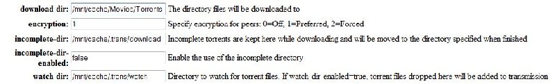

the Add Transfer will reflect the incomplete-dir if enabled.  I think if you change the one via the transmission webGUI it will be in effect.  It does not override the value in the settings.json file.
