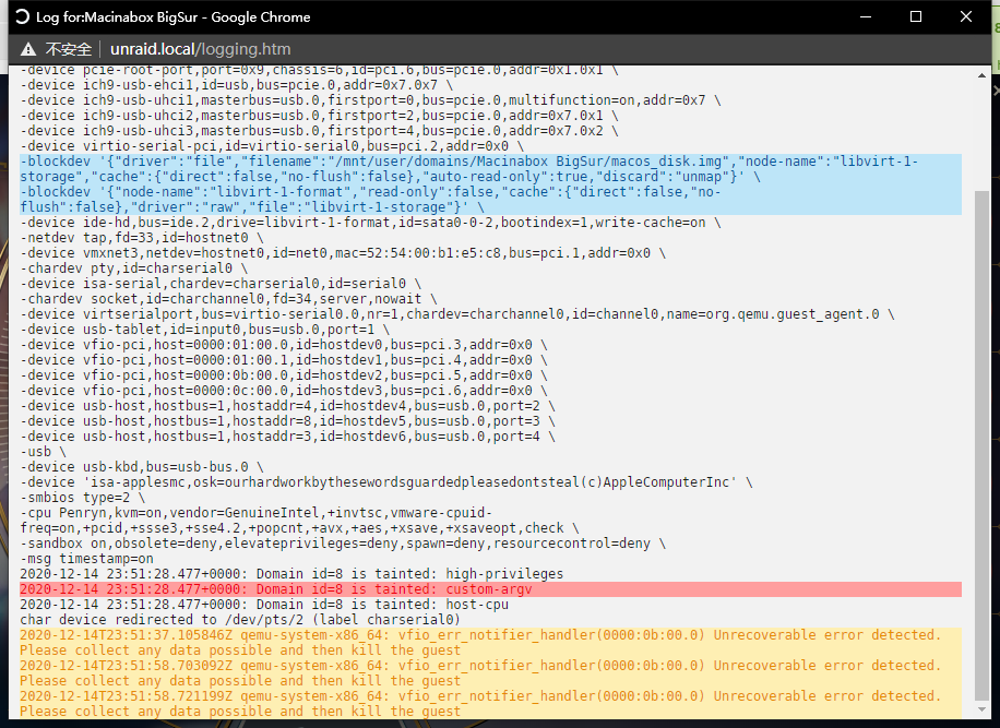

13 hours ago, mechmess said:
I've got a really strange bug.
I was able to successfully install and boot the VM to the desktop (Big Sur). I then proceeded to add two additional CPUs and my GPU, add the name of the VM to the script, apply the script, and successfully reboot.
Following this I then attempted to pass through my USB controller, following the same procedure applying the script after editing the VM, and then attempted to boot - my display then will not initialize and 1 CPU core is pegged to 100%.
Removing the USB controller from the VM and rebooting Unraid does not solve the issue. I also attempted to remove the GPU, and the VNC window then says that the guest has not initialized the display. I have deleted everything and started from scratch and the same problem pops up as soon as I pass through the USB controller. The only thing that seems to resolve it is deleting all Macinabox files and starting from scratch.
Here below is the log from when I have returned all VM settings to default, with the issue presenting.
ErrorWarningSystemArrayLogin

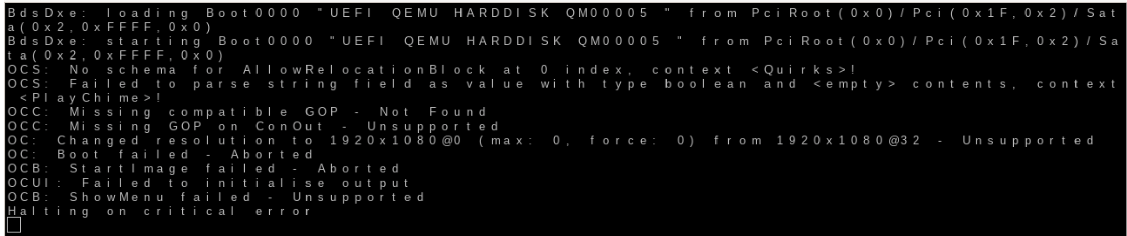

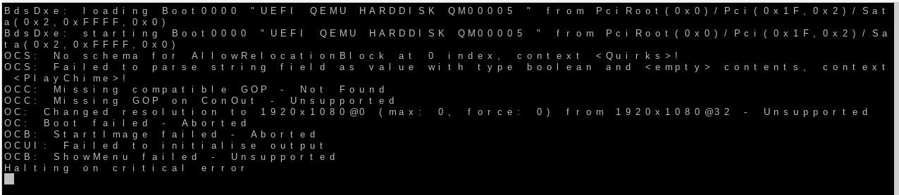

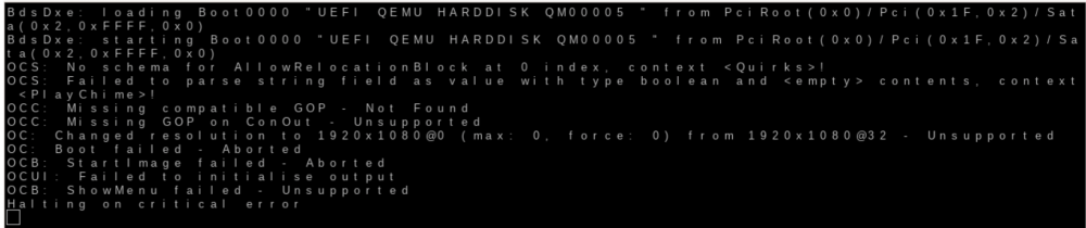

I and I have the same situation. When I use VNC to display, I can enter MacOS normally, but when I pass through the graphics card, I cannot enter MacOS normally, and then on the Dashboard of UNRAID, a CPU 100% condition will be displayed. Big Sur and Catalina are in the same situation.
When I use Macinabox's Docker GUI to view the VM, an error message of Missing comptible GOP-Not Found appears
CPU: AMD Ryzen 5 3600
MB: MSI B450M Mortar MAX
GPU: R9 370X

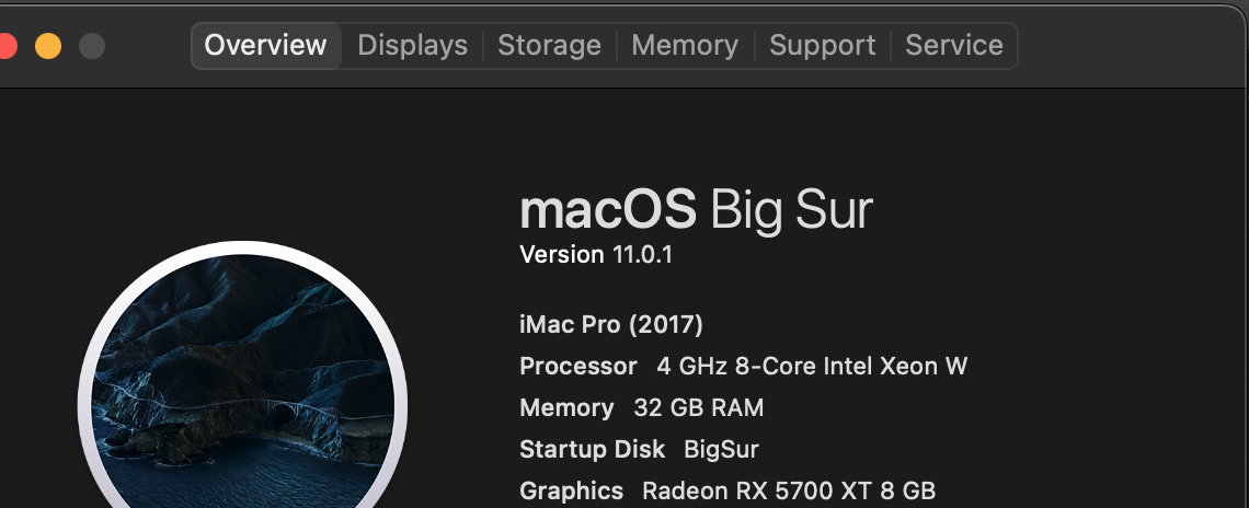

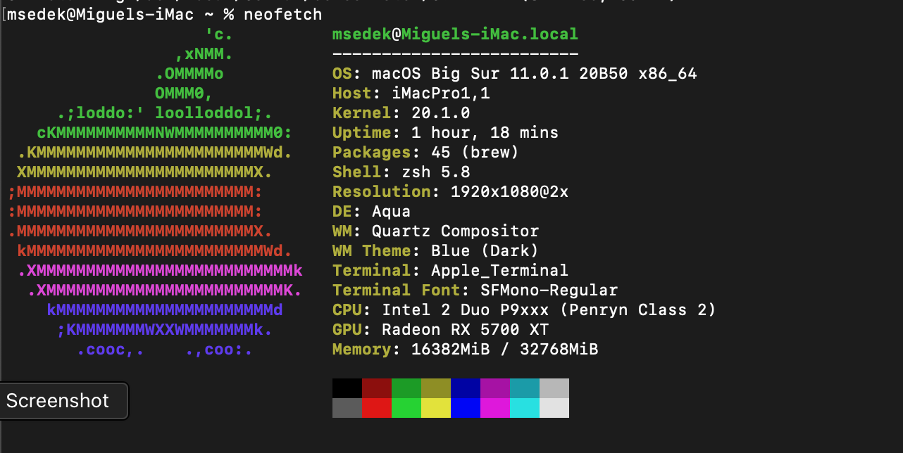

   successful install from scratch then used my timemachine to migrate all my apps and data from the old catalina.. thanks @SpaceInvaderOne
Edited by mSedek

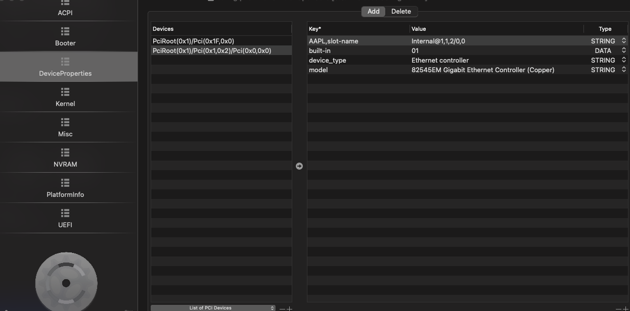

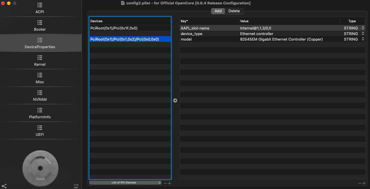

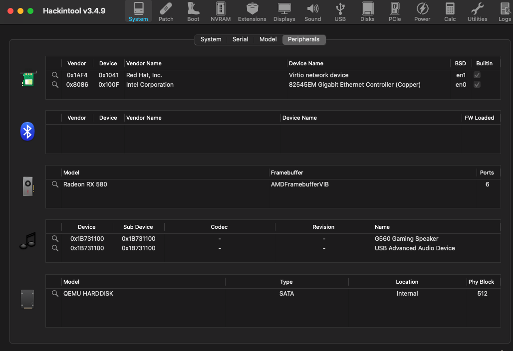

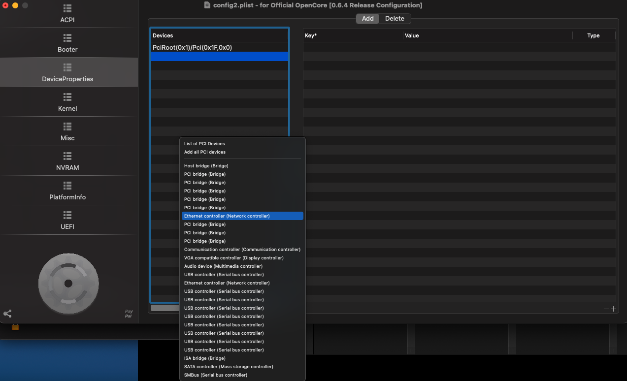

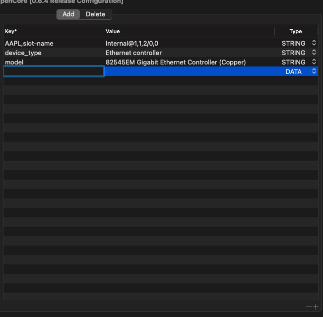

12 hours ago, Helmonder said:
Did anyone succeed in logging in to the appstore ?  Or is there another way to get apps in there ? I miss my office..
Yes you can fix that by doing the following
1. download hackintool    https://github.com/headkaze/Hackintool/releases/tag/3.4.9
2. Open it and goto peripherals
3. Your nic should be en0 and a virtual intel nic (you can have other nics but you must have en0 which is intel.
4. if your nic is not en0 then run the following in mac terminal then reboot the vm. Then it should be en0
sudo rm /Library/Preferences/SystemConfiguration/NetworkInterfaces.plist
sudo rm /Library/Preferences/SystemConfiguration/preferences.plist
5. You want the nic to say en0 and have a tick where it says built in as in the pic below
1548038261_Screenshot2020-12-14at20_38_14.thumb.png.425695e23ce337f89c446a54ea5a3623.png
6. If it doesnt then you will need to open your opencore configurator goto tools then open the efi partition and open the config.plist file with open core.
7. goto device properties then at the bottom click on the list of pci devices.
1916011518_Screenshot2020-12-14at20_56_02.thumb.png.0857bf669f619bec8bb199428360faa1.png
Find your network adapter and click it.
It will add it in as below
2103617263_Screenshot2020-12-14at20_56_58.thumb.png.b30d60838fcfade9a48a67f97edcf156.png
Now we need to click the plus button on the bottom far right of the screen.
It will allow us to add a key
Now we need to add the key built-in with the type set as Data and the value as  01
734704885_Screenshot2020-12-14at21_02_24.thumb.png.a632e20b70bf81e6a3db1675f8772bae.png
Now whilst here in opencore configurator double check that you do have a system definition defined in platform info.
Now save the changes and reboot the vm, check with hackintool that it now has a tick on builtin. Now log into apple services :)
I've got the same issue, though its related to my graphics card... I was able to get VNC working again by editing the XML and changing the 'bus' within the <video> tag to 0x00 from 0x0A.  I also had to change the slot to 0x02, but that might be particular to my system.
That allowed me to get VNC working again, but nothing I do can get the graphics passthrough working on my AMD R7 265.

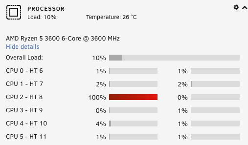

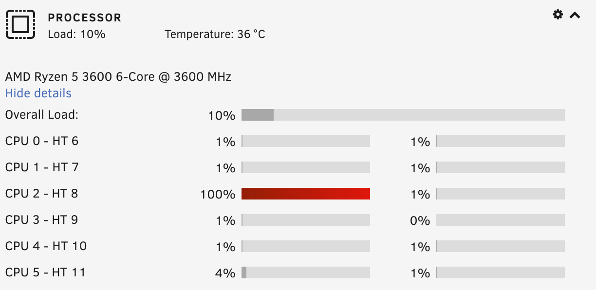

Does anyone have problems with the pass-through GPU card?
My environment is:
UNRAID: 6.9.0 RC-1
CPU: Ryzen 5 3600
GPU: Radeon 5500XT (just one GPU card)
MacOS VM: BigSur, Catalina
Then follow the video of @SpaceInvaderOne to create a new MacOS VM, and finally I can successfully log in to the OS in VNC mode and put in the EFI configuration file.
But when i shutdown the VM and edit the VM setting to passthrough GPU and GPU's audio, it's bring the black screen to me.
When my monitor is black, I can only use the WebGUI on the docker of macinabox to check the situation, and it's will show some error msg.
And at this time, there will be a situation where a CPU core is fully loaded.
I don’t know if it’s the macinabox problem or the opencore problem, because the clover version of macinabox can passthrough GPU normally.
Hope someone can help me, or is there a way to go back to the clover version of macinabox, thank you.
Finally, attach my XML file.
