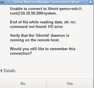

when i go to use virtmanager, it says no connection and i can not find out how to add one

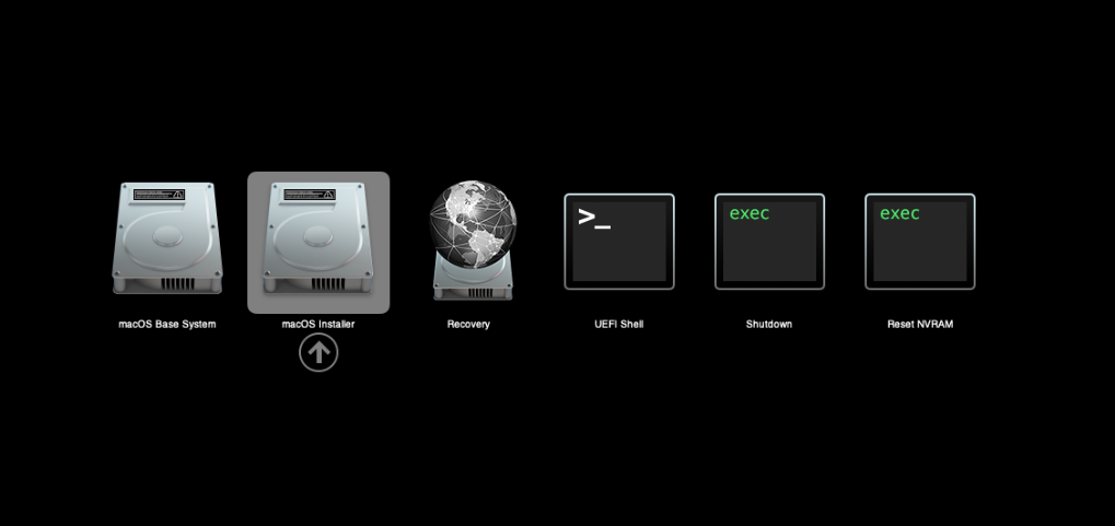

5 hours ago, SpaceInvaderOne said:
Yes.
Using opencore configurator. Mount your efi partition and open the config.plist with the configurator.
goto misc
and set as in this pic (check hideauxillary and uncheck show picker)
429713460_ScreenShot2020-12-10at17_13_33.thumb.png.2422d3ba33d3750cba0a578f950f3990.png

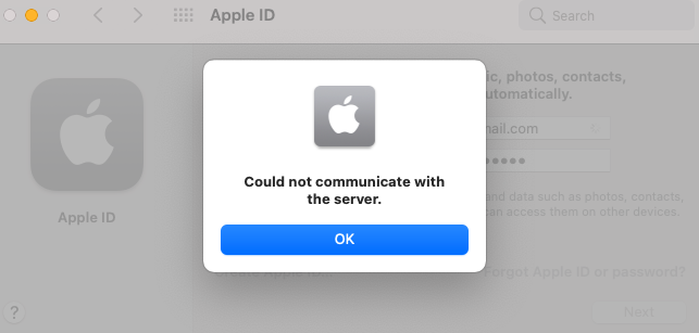

Have Big Sur up and running with passthrough gpu and nvme, everything is running fine apart from being able to sign into iCloud.
I can sign into the App Store fine just not iCloud, I get the following error "could not communicate with server"
I have tried with all different virtual NIC types and have even passed through an intel Nic that's working. Just no luck.
Have also tried different smbios.
Any help would be great as this is the last thing to get this 100%
Thanks in advance

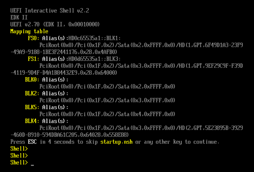

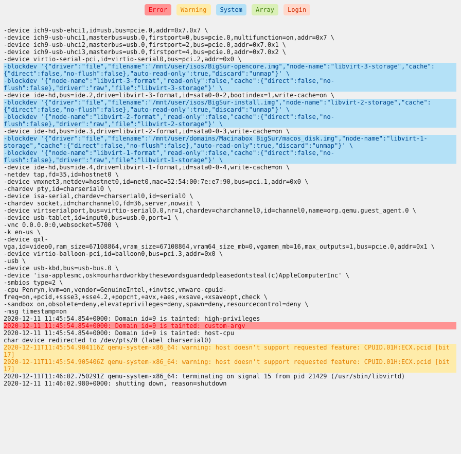

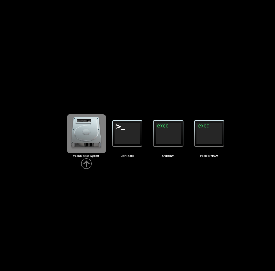

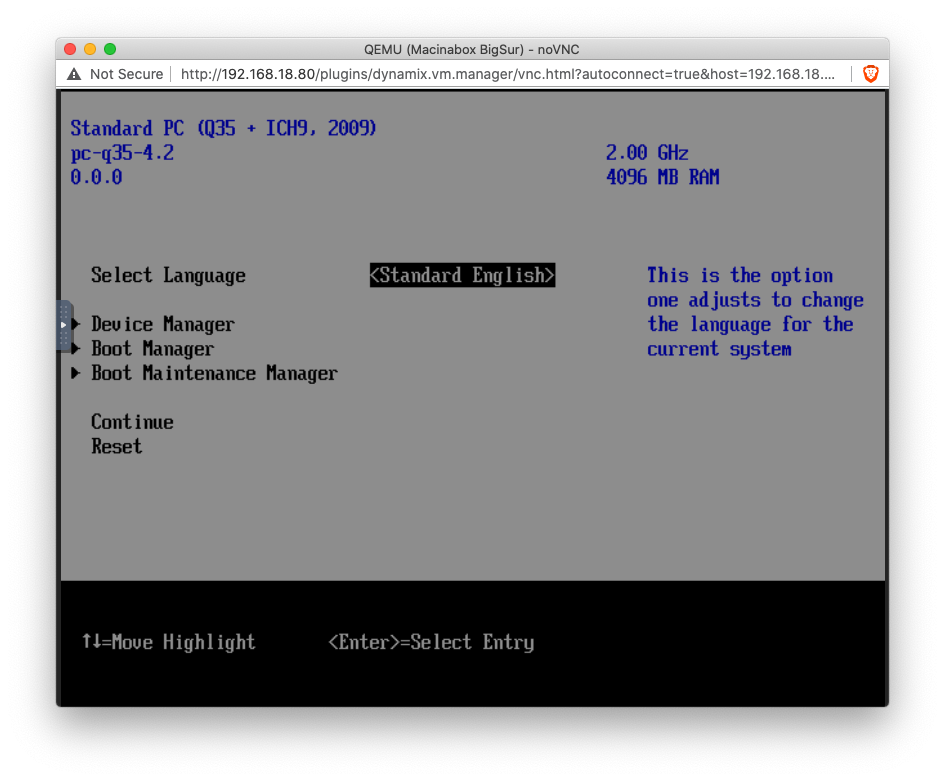

i have searched this topic with a few key terms and have not seen this come up but if it has please point me in the right direction :)
macinabox has installed the VM but upon boot it presents the UEFI shell and gives the option "Press ESC in 5 seconds to skip startup.nsh or any other key to continue"
I can't seem to pass this screen. If I press ESC then the Shell prompt appears. When I press "any other key" such as a physical letter key or even CTRL or ALT on my keyboard - it does not seem to affect the system in anyway. I also tried using the VNC buttons to press CTRL and ALT with no difference.
I AM able to issue the "reset" command at the Shell prompt which resets the 5 second count-down. i AM able to issue the "exit" command which put into a BIOS looking type of screen:
1927109268_ScreenShot2020-12-11at10_27_53.thumb.png.992e7d096f4ce7e85e642e36aa6c7cae.png
This is what the log looks like:
Any guidance is much appreciated :)
Second on the 'cannot communicate with the server'.  Last time we changed the network type to e1000-82545em  per this post here
However the xml is correct on this for the new version, but it is still not working. Any guidance would be awesome.  Thanks!
About this "could not communicate with server" error that I also have, I do not know if it is related but Hackintool reports "Standard PC (Q35 + ICH9, 2009)" as Model indentifier instead of the MacPro6,1 I defined in the config.plist...

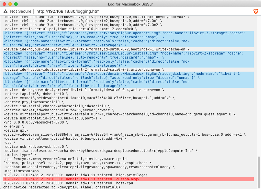

Could any one shed any light on the following error
Execution error
operation failed: unable to find any master var store for loader: /mnt/user/system/custom_ovmf/Macinabox_CODE-pure-efi.fd
This after install the latest version of macinabox

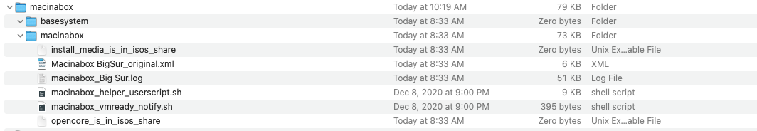

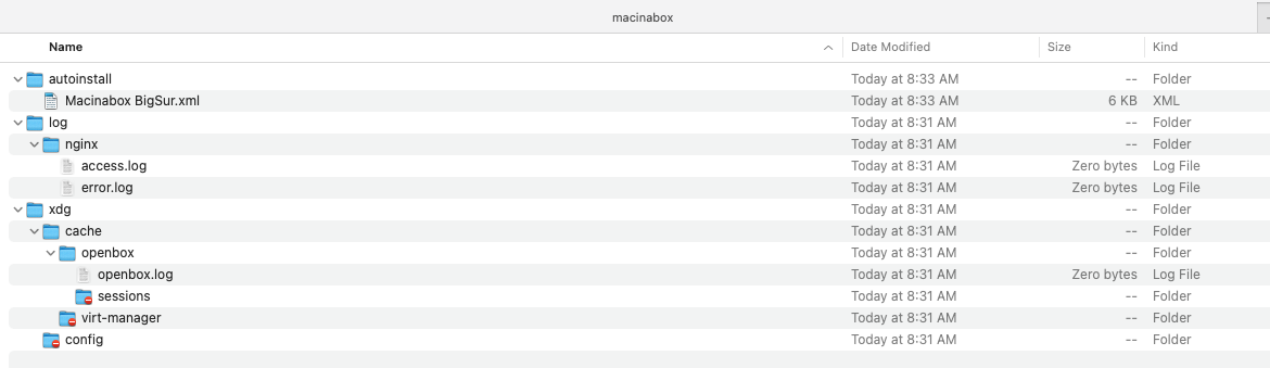

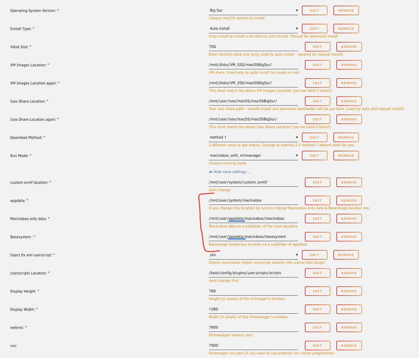

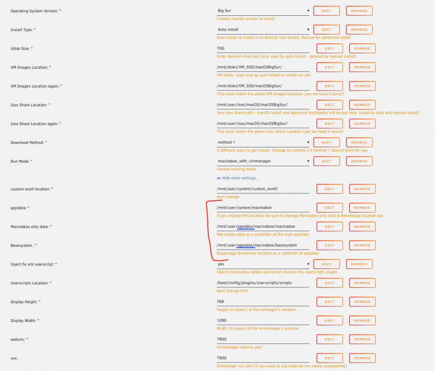

Hi Ed-
Thanks for offering your input.

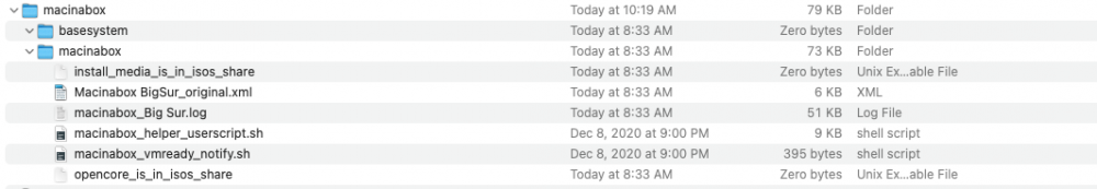

I checked the appdata folder and this is what I've found:  (the parent folder of this screenshot is /mnt/user/appdata)
2008284606_ScreenShot2020-12-11at10_20_28AM.thumb.png.872697b41fd163826bb28e4a8a1b3c20.png
Here is a screenshot of /mnt/user/system/macinabox :
222732596_ScreenShot2020-12-11at10_25_55AM.thumb.png.a86b74fb319f0d3f2a2a7572ee29086d.png
It looks like at some point I changed my Docker default appdata location to /mnt/system ? Not sure why I would have done this - but when I started learning Unraid a few years ago I definitely had some beginner mistakes and maybe this is a leftover error that I've just noticed now.
Anyway - I think I've found my error
103626487_ScreenShot2020-12-11at10_27_32AM.thumb.png.2b569558471fa52bdf1a07484f05a642.png
I believe the three directories outlined in my red annotation should read as follows:
appdata (leave as is) /mnt/user/system/macinabox
Macinabox only data: /mnt/user/system/macinabox/macinabox
Basesystem: /mnt/user/system/macinabox/basesystem
OR should I switch the first directory to:
appdata: /mnt/user/appdata/macinabox ?
and then leave other two as is?
Not sure which is easier but I think either way I will delete all and totally redo to ensure a clean install.
I deleted the docker, system/macinabox, appdata/macinabox, docker template, and re-did the whole process.
This time I edited the appdata path to read /mnt/user/appdata/macinabox instead of the /mnt/user/system/macinabox that my server defaulted to.  Went over to user scripts and ran the notify and it was ready almost instantaneously.  Finishing the rest of the process now!
Thank you again for all you do for our community.

Progress update
Sooo... I might be of some help, for a change.
I had the problem with login to my Apple ID and had various error messages like "could not communicate withe server" or "this computer already registered to many ID's" (or something like that.
I did two things :
1 - I fixed the En0 following this guide.
The problem was thas I had a network adapater as En0 but it was not marked as built-in.
2 - I notice that even if I filled out the "PlatformInfo" tab in the OpenCore Configurator as shown in the video (with mac model, serial number etc...) when I clicked on "About this mac" I had no model specified... just "mac". And Hackintool also showed Standard PC (Q35 + ICH9, 2009)" as Model indentifier.
The error I made (or the thing I did not corrected) was that under the PlatformInfo tab the scroll down menu on the bottom right was set to "Overwrite"... But it obviously had nothing to overwrite and changing it to "create" did the trick ! On reboot I had the right model identifier and I could log in to icloud with no problem...
Hope that will help someone !
1 - How far did you have to go?  I also don't have a check-mark under built-in.  I'm not sure how to go about:
If this doesn't work, add NullEthernet.kext (opens new window) and ssdt-rmne.aml (opens new window) to your EFI and config.plist under Kernel -> Add and ACPI -> Add respectively. The SSDT is precompiled so no extra work needed, reminder compiled files have a .aml extension and .dsl can be seen as source code.
2 - Mine shows as Mac Pro (Late 2013) so I think I'm good there.
I did not add NullEthernet.kext and ssdt-rmne.aml. I just added a line in DevicePropreties (in config.plist using OpenCore Configurator) as I just learned here.
The method explained here aslo helped. It's doing the same thing, differently ^^

I am trying to install Macinabox Big Sur, too.  The problem I am getting is that when I have downloaded opencore configurator and mounted the QUEMU hard disk media EFI, there are no files to copy to the desktop.
Where could they have got to?  I'm seriously looking forward to not having to replace the custom XML everytime I tweek a setting on a VM.  Thanks so much for your great work Spaceinvaderone!
I'm in a working Mac.... Yay! Thanks Ed
Following up with the VirtManager example, I get the following screen thrown up.......
Any ideas gratefully received thanks...........

i tried everything like shown in the video but the install and open core images are not loaded. All files are in the right place
@SpaceInvaderOne any idea why the two images are not loaded?
exact same problem and exact same log
I've got a really strange bug.
I was able to successfully install and boot the VM to the desktop (Big Sur). I then proceeded to add two additional CPUs and my GPU, add the name of the VM to the script, apply the script, and successfully reboot.
Following this I then attempted to pass through my USB controller, following the same procedure applying the script after editing the VM, and then attempted to boot - my display then will not initialize and 1 CPU core is pegged to 100%.
Removing the USB controller from the VM and rebooting Unraid does not solve the issue. I also attempted to remove the GPU, and the VNC window then says that the guest has not initialized the display. I have deleted everything and started from scratch and the same problem pops up as soon as I pass through the USB controller. The only thing that seems to resolve it is deleting all Macinabox files and starting from scratch.
Here below is the log from when I have returned all VM settings to default, with the issue presenting.
