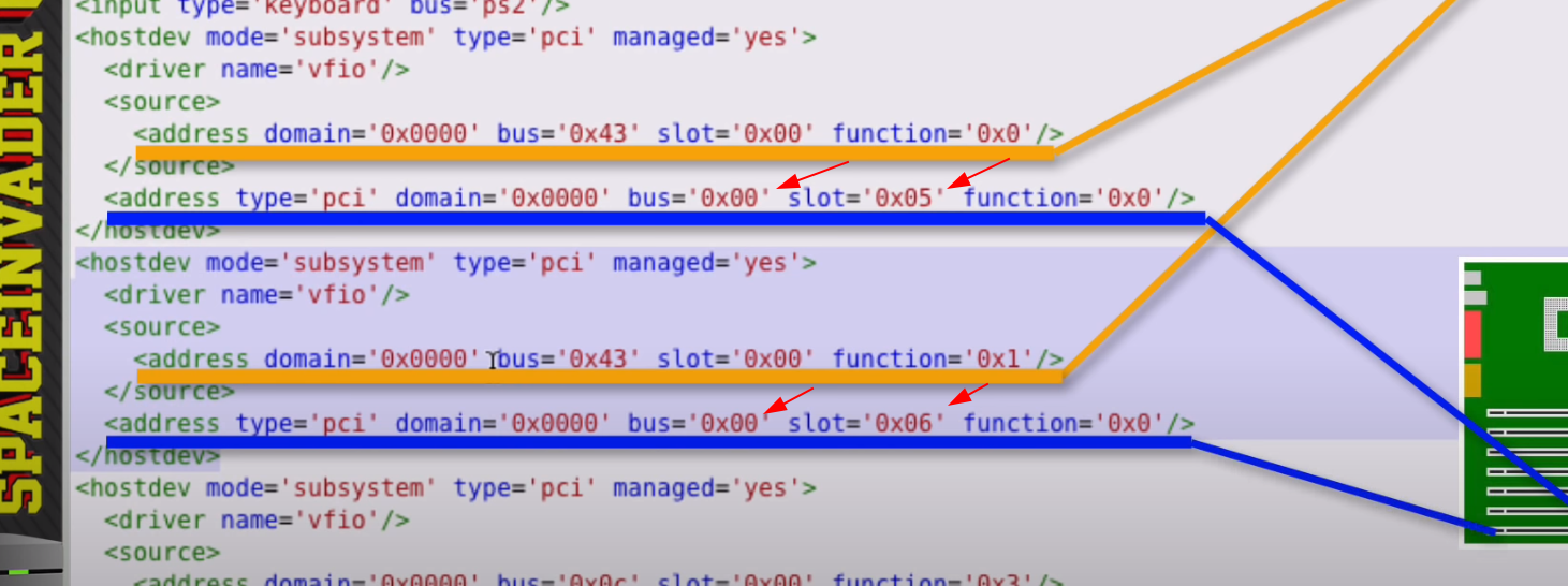

15 hours ago, SpaceInvaderOne said:
Try setting the nvidia gpu as a multifunction device as in this video here
i gave it a try, but either i end up with no sound or no picture ;) i guess its due the busses are different then in your sample video
here how it looks like by default when i add the gpu (video & audio)
      <driver name='vfio'/>
      <source>
        <address domain='0x0000' bus='0x04' slot='0x00' function='0x0'/>
      </source>
      <rom file='/mnt/vms/VM/bios/bios_1030.rom'/>
      <address type='pci' domain='0x0000' bus='0x04' slot='0x00' function='0x0'/>
    </hostdev>
      <source>
        <address domain='0x0000' bus='0x04' slot='0x00' function='0x1'/>
      </source>
      <address type='pci' domain='0x0000' bus='0x05' slot='0x00' function='0x0'/>
    </hostdev>
in your sample the busses are equal and the slots have to be adjusted, in my usecase the defaults are vice vers
so i tried adjusting as sample by editing the bus but also no audio device found, i guess its by macos design mit a 10xx card ?
      <source>
      </source>
      <alias name='hostdev0'/>
      <address type='pci' domain='0x0000' bus='0x04' slot='0x00' function='0x0' multifunction='on'/>
    </hostdev>
      <source>
      </source>
      <alias name='hostdev1'/>
      <address type='pci' domain='0x0000' bus='0x04' slot='0x00' function='0x1'/>
    </hostdev>
if you think there is a solution, thanks ahead
Edited by alturismo
inserted edited xml part

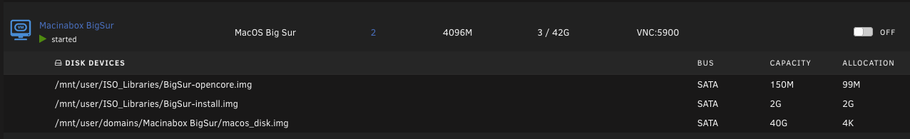

@SpaceInvaderOne I just pulled down your latest container and trying to install Big Sur it actually runs the Catalina installer.
I've deleted everything and started over a few times (with unraid reboot in between for good measure) with the same result, is there a bug in the latest image?
The installer is correctly named BigSur-install.img but when you run it from the new VM it is definetly trying to install Catalina:
Hey,
I did the same thing earlier with the same result.
I tried deleting the Big Sur image files and changing it to method 2 which then grabbed the correct Big Sur image file from Apple.
So yeah, I'd say workaround-able bug to be fixed when there is time to.

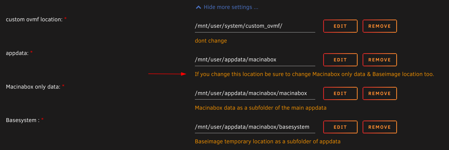

I've been spending a few hours on it, but somehow cannot get it to work.
I believe one issue is that I should have switched to method 2.
I am also confused though about the folder mappings in the docker and cannot figure it out from the video:
1) VM Images Location, VM Images Location again, Isos Share Location, Isos Share Location again
All four locations set to "/mnt/disks/NVME/VM/". This should be fine
2) custom ovmf location
It says that I should not change it, so I have not changed it. It is per default set to "/mnt/user/system/custom_ovmf/", which is not preferred by me as it places the files on "/mnt/disk1", which is not ideal. Any idea whether I can change this would be great. For now, left unchanged.
3) appdata, Macinabox only data, Basesystem
It says the three should be the same. However, the default shows the first in the docker folder, while the other two in a user folder. Assume there is some mistake here? How to best set this up?
Thanks for your help!
And yet another issue:
2020-12-20 18:18:35,036 Selected macOS Product: 001-86606
/Macinabox/unraid.sh: line 273: /Macinabox/tools/FetchMacOS/BaseSystem/SharedSupport.dmg: Permission denied
It seems to be working for all of you, so there must be a user issue on my end stopping me. Maybe because of my docker settings? Any thoughts on how others have configured it? Thanks for your help!
you may should consider leaving them default, you know when you done u could just delete all that stuff die its needed for installing only ...
by adjusting all kinda volumes etc there might be a small issue somewhere which stops you.
also, you could start moving AFTER you done installing ...
Thanks. I think this makes a lot of sense. Can you confirm that your default setting for "appdata, Macinabox only data, Basesystem" also points to very different paths?
i left them all untouched AFTER i removed the old macinabox docker AND appdata folder ... and all is good, way easier then 1st approach, may also consider removing the user scripts so macinabox creates them for you
Is there some sort of trick to get audio working on BigSur by changing the bus or function for my GPU?
Everything else is working perfectly with an RX570 passed through, just no audio output option.

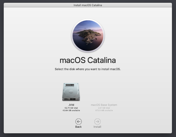

anybody else lose keyboard/mouse input when trying to install Big Sur?  Catalina seems to work fine.
Hey,
I don't know if I'm doing something wrong, I set bigsur in macinabox, but it's still installing catalina, is this right? I used method 2. bc 1 doesn't work at all
Can confirm: using Method 1 would try to install Catalina. I switched to Method 2 and it is now installing Big Sur.
Well i tried both and both gets me Catalina. Finally, i got it, i had to delete everything from macinabox
Edited by txcpaul
