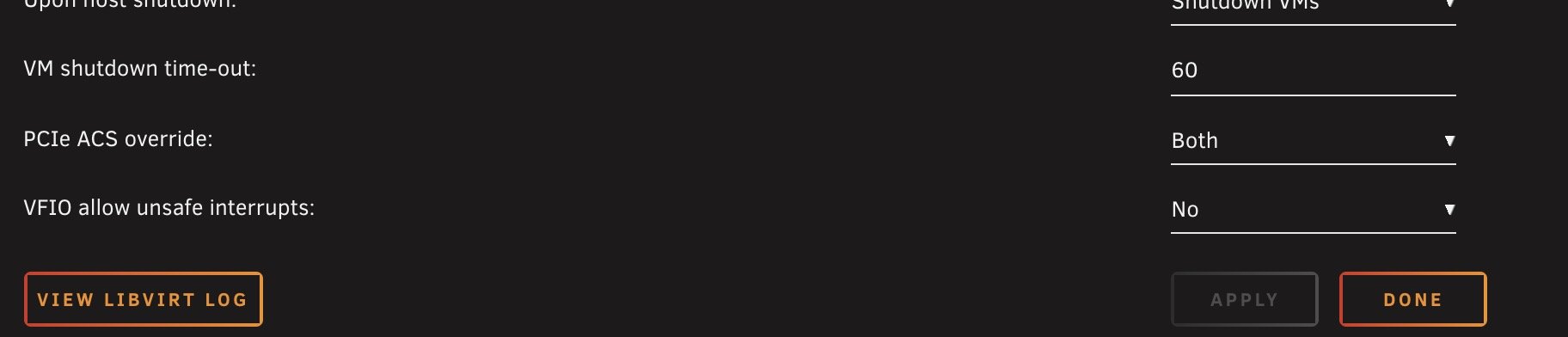

The bus is the same, cause it is set to multifunctional. So no worries there, just have an eye that the bus is free for GPU and HDMI-AUDIO and not booked by another PCIe device!
My VManager ist set to "both". I would recommend you try "multifunctional" first and see how your IOMMU groups look like.
If all is good separated, then you are fine. I you need a better split up, try "both"!
Thanks for your help.
How can I check whether the bus is free?
My PCIe ACS override is set to downstream right now.
As mentioned above, both are "alone" in group 29:
Group 29
[removed] VGA compatible controller: Advanced Micro Devices, Inc. [AMD/ATI] Ellesmere [Radeon RX 470/480/570/570X/580/580X/590] (rev e7)
[removed] Audio device: Advanced Micro Devices, Inc. [AMD/ATI] Ellesmere HDMI Audio [Radeon RX 470/480 / 570/580/590]
Anything else to try? Shall I still switch to "both" although no isolation seems required?

GPU alone sounds perfect and you can try your passthrough. The best view of your groups you have with the Unraid VFIO plugin or menu Tools > System Devices:
Simply try a bus. If the bus is not free, you will get a warning when you trying to save your plain text XML under the VM tab.
