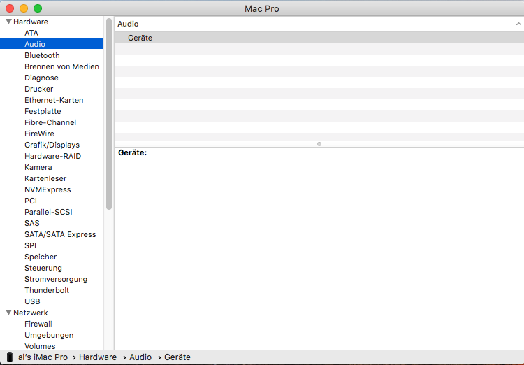

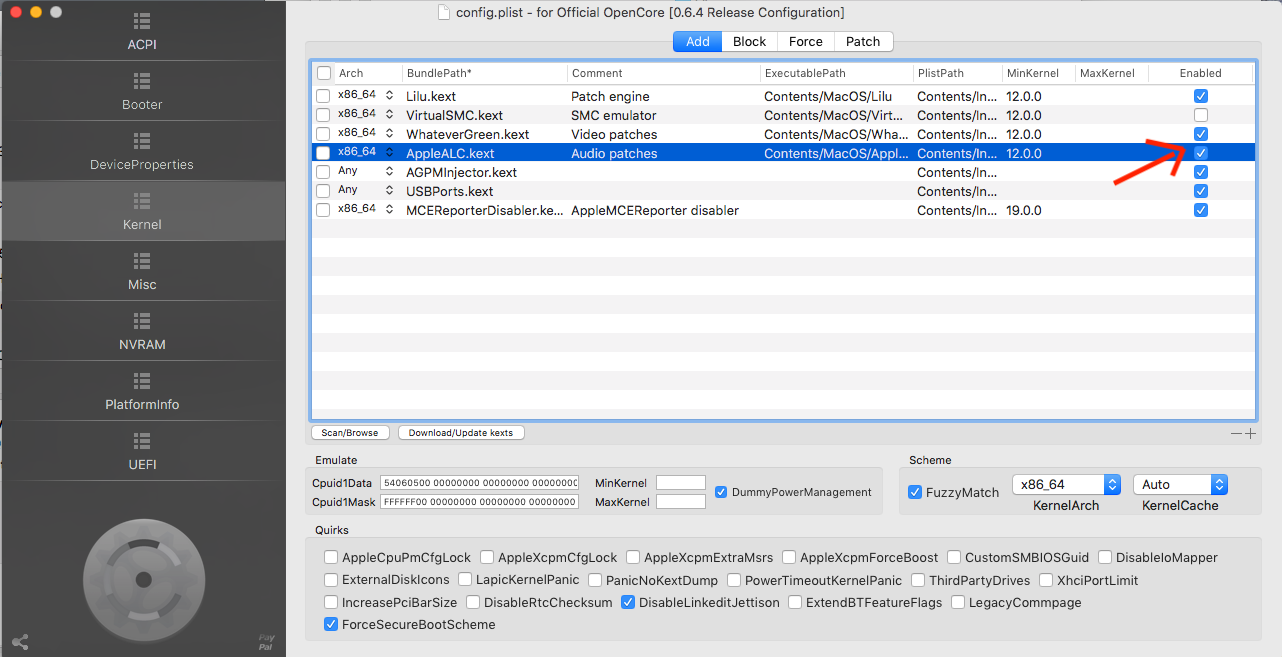

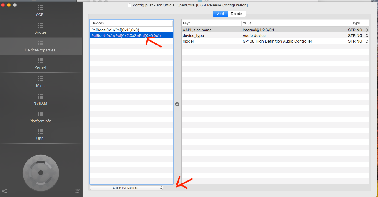

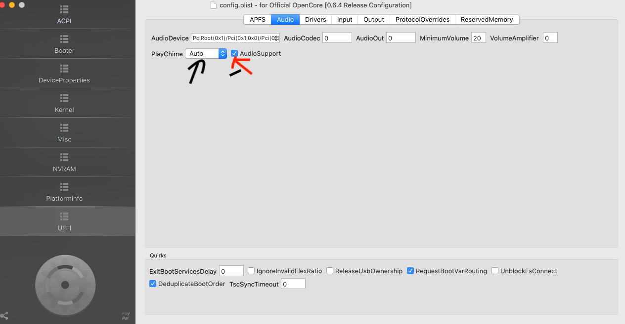

ok, after some reading and may taking a look what could be the reason(s) for no audio, here some things i tried in opencore configurator after changing to multifunction like @SpaceInvaderOne suggested.
under Devices i added this device (was not there)
under Kernel i enabled this Audio patch, was disabled before
under UEFI i setted PlayChime to auto (was off before) and ticked AudioSupport
of course rebooted after each step

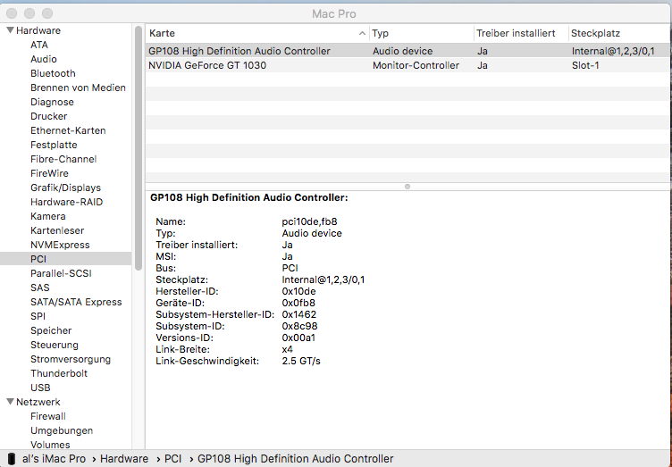

so now i am at the end what u unknown apple user could look for ;), under devices in macos overview there is still no audio device listed
i also reinstalled the driver once, tested on hdmi and DP, but as there is not even a device listed i guess makes no sence to look for drivers or connections,
even its listed as PCI device now ... but not as audio ...
if somebody has another idea ;) thanks ahead

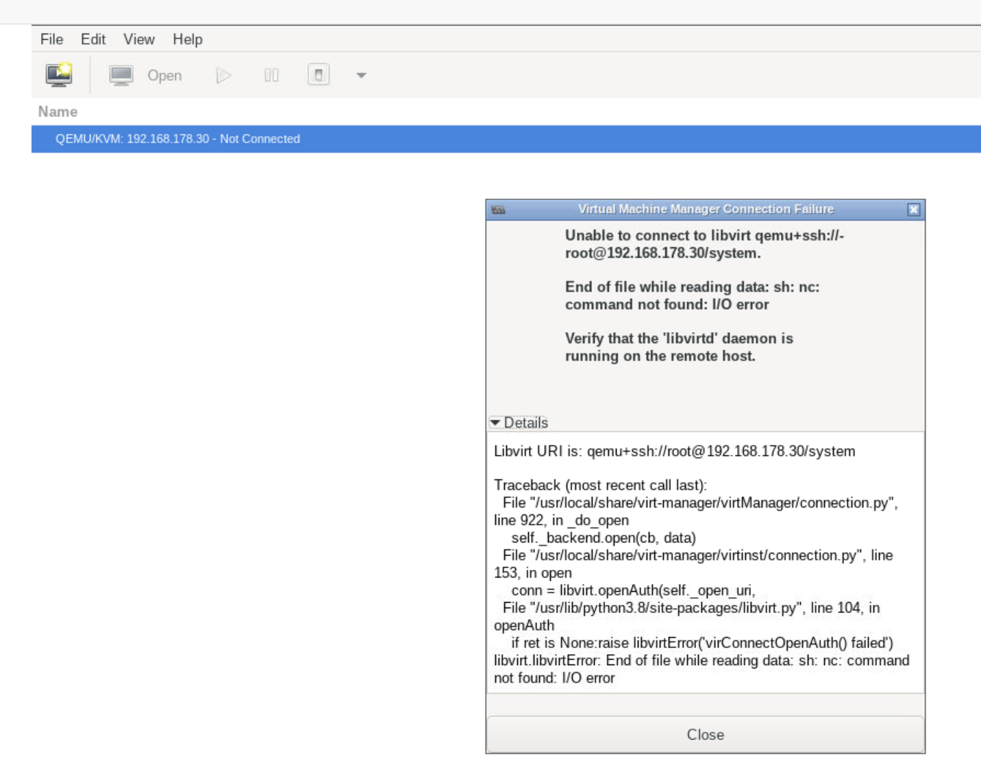

I get an error when I try to use the VM Manager. Any idea how to solve this?
I have the same exact error, please help !
need to install NC or netcat, from Nerd Tools Plugin
thanks to @derpuma who pointed me to voodooHDA to bypass now the issue and audio via hdmi is working without any changes needed to EFI etc ... works directly after installation and reboot. tested with a fresh install (without all my already done mods).
so in case anyone has also no hdmi audio issue with nvidia 1030 on high sierra and cant find a solution ... may as hint thanks to @derpuma
thank you! It works
