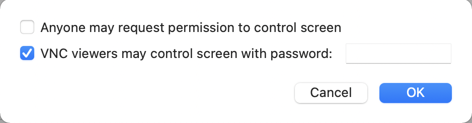

2 hours ago, John_M said:
 no Apple Screen Sharing client for Windows, which is also a shame.
You should be able to connect to Mac Screen Sharing with a VNC client on Windows if you allow that from the Mac side.
Also, this solution claims to be the best (and may work without the above option), Remotix: https://remotix.com/remotix-win/
Edited by Espressomatic
I tried it, but unfortunately it does exactly what a regular VNC software does. I cannot get more than 1 screen working.

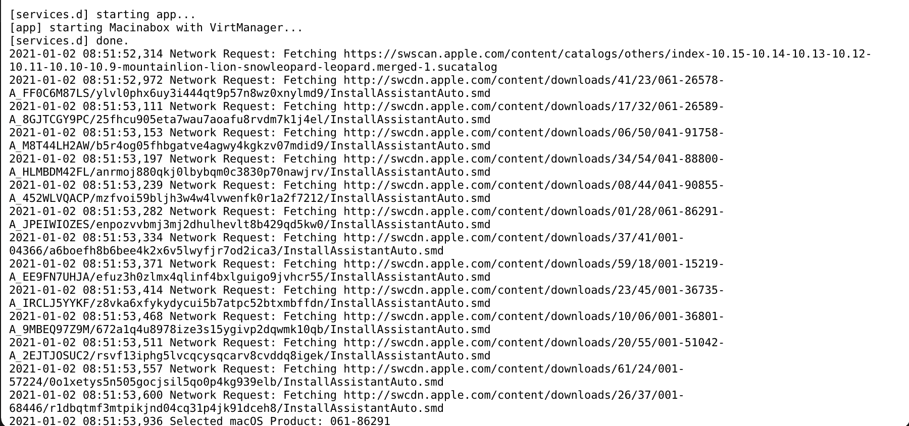

I have tried installing both Catalina and Big Sur with the macinabox docker, each time it seems the install image that is downloaded stops at 2.15GB and does not increase in size. With the Catalina install, I left it overnight and the image file size was still 2.15GB. Tried Big Sur this morning and after about an hour and a half the install image file size is still 2.15GB. Am I doing something wrong? When I look at the macinabox docker log, it still indicating that it is downloading.....
Do you have the helper script and does it report that it has finished downloading?
Try deleting everything in the folders you see the Docker container points to locally, if they are associated with the Big Sur or Catalina updates. For Big Sur I am pretty sure you need Method 2, because Method 1 downloads Catalina regardless of what you pick.
I think I figured it out, issue on my end, trying method 2 now.
But now I see this in the docker log?:
Macinabox/unraid.sh: line 273: /Macinabox/tools/FetchMacOS/BaseSystem/SharedSupport.dmg: Permission denied
Tried again and got this:
2021-01-02 10:59:42,451 Network Request: Fetching https://swscan.apple.com/content/catalogs/others/index-10.16-10.15-10.14-10.13-10.12-10.11-10.10-10.9-mountainlion-lion-snowleopard-leopard.merged-1.sucatalog
2021-01-02 10:59:43,091 Selected macOS Product: 001-86606
/Macinabox/unraid.sh: line 273: /Macinabox/tools/FetchMacOS/BaseSystem/SharedSupport.dmg: Permission denied
ERROR:
Unexpected end of input stream
ERROR:
Do you have the latest unRAID version? unRAID Version: 6.9.0-beta35 or above
No I am actually on unRAID 6.82 do you think that matters?
Updated to 6.9RC2 - getting this error?
Edited by ashman70
I see that SpaceinvaderOne just commented on a pull request to fix said issue: https://github.com/SpaceinvaderOne/Macinabox/pull/34
He said it has been merged. Can you try again? If it's merged, it should pull the latest code and should fix your issue.
Trying now, thanks
Still getting this error, this is under unRAID 6.82, I tried upgrading to 6.9RC2 but it broke my VM which I need.
