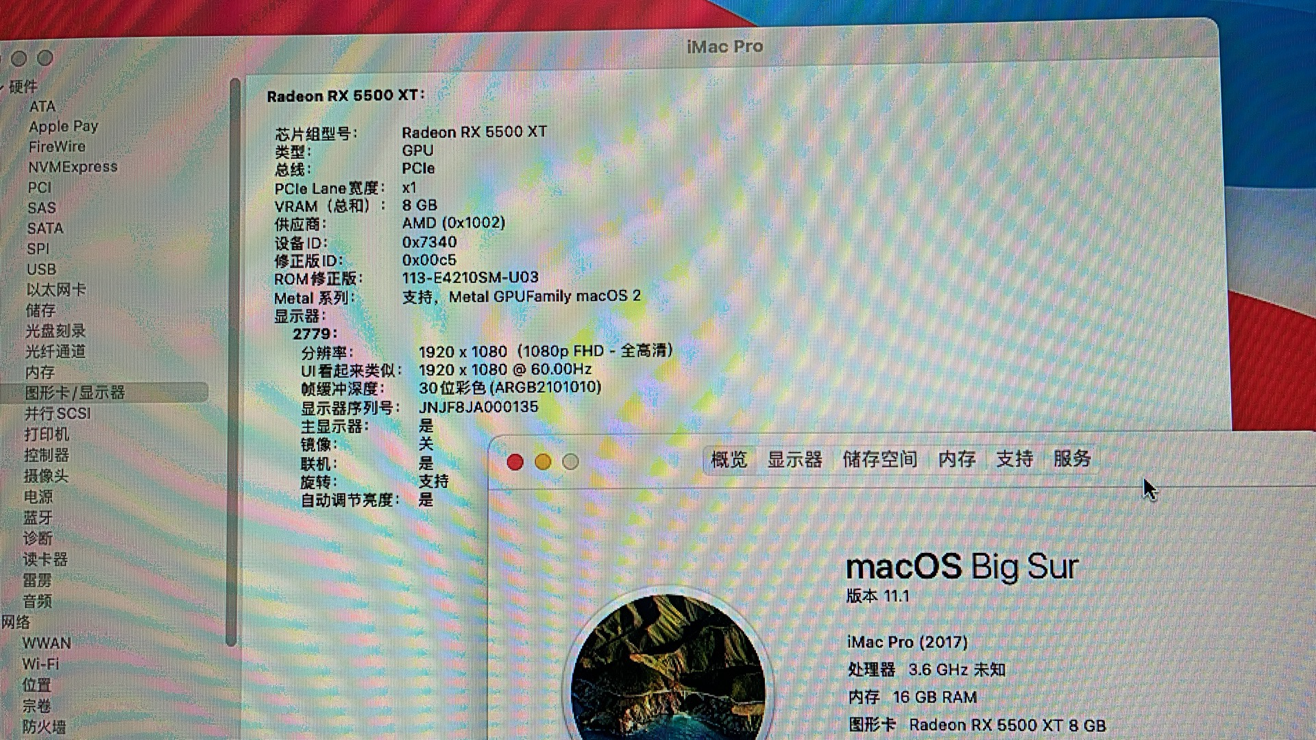

Has anyone got the intel uhd 630 passthrough to work with a macinabox so that It outputs to the motherboard hdmi port?
OH!! GOD!! I think I solved the problem of Missing GOP in GPU passthrough on my PC.
I am very excited at this monment, So let me talk about what I did
  1. My MB is MSI B450m Motar MAX, it's doesn't need to close CSM, just boot unraid in UEFI mode :)
  2. My GPU is RX5500 XT so i add agdpmod=pikera in the NVRAM boot-args of the config.plist
    i have add the vbios in the xml config(but i don't think so it's the reason) from TechpowerUP
  3. I append video=efifb:off to syslinux.cfg and reboot, it's like:
    kernel /bzimage
    append vfio_iommu_type1.allow_unsafe_interrupts=1 pcie_acs_override=downstream,multifunction video=efifb:off initrd=/bzroot
    Without this, you will encounter this error message with white apple logo (vfio: unable to power on device stuck in d3)
  4. When I finished the configuration, I found a progress bar under the white apple logo, and then! I can enter the MacOS
Finally, attach my xml config
ahah I can understand well...I remember when I was able to do my first gpu passthrough to my vm in high sierra :D
when there wasn't whatevergreen because lilu didn't work for vm and all was a lot more difficult :P
Btw, the gop error probably means that a card lacks support for uefi, or that the system is booted in legacy bios mode: no need to disable cms, just boot unraid in uefi mode.
CMS disable disables at all legacy bios at the bios level, so if you have other os installed in mbr you may not able to see them at boot.
Edited by ghost82
I have confirm that, it's doesn't need to close CSM, just boot unraid in UEFI mode :)
I found some error with open the CSM, when try to restart macos it will show GOP Missing agin with CSM open
And the vbios is needed, or can't passthroug GPU again when reboot macos
now i used vbios is Sapphire.RX5500XT.8192.191111.rom
Edited by WeiYanZhen
