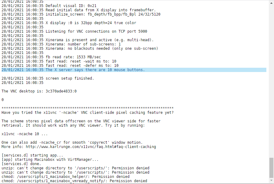

After install macinabox ,I met this problem .It seems like some sort of permission problem. Hope you can give me some guide to work it out.
"[services.d] starting app...
 [app] starting Macinabox with VirtManager...
 [services.d] done.
 unzip: can't change directory to '/userscripts/': Permission denied
 chmod: /userscripts/1_macinabox_helper/: Permission denied
 chmod: /userscripts/1_macinabox_vmready_notify/: Permission denied"
And I have to say it is so weird that I devote 3 days but still in van. I have tried reinstall ,changing hardware and reinstall unraid system. I HOPE SOMEONE CAN HELP!

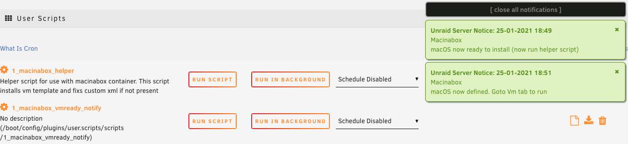

I've only just started, on a test server that has never had any version of MacInABox installed before and it's looking promising so far. I just accepted all the defaults and made sure Catalina was the macOS version chosen (it is the default).
1502438998_ScreenShot2021-01-25at18_52_36.thumb.png.873f94d19c36d8b85a2ed6f50de7221c.png
1850246141_ScreenShot2021-01-25at18_54_20.thumb.png.9241e7333e4091da97497580df70f30a.png
The VM icon is the default one because I don't use Ed's method. I'll add my own later.

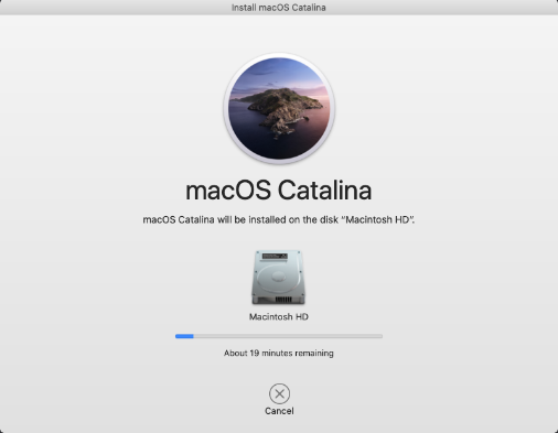

Well, that worked fine. It's all installed and it found a security update and a new version of Safari, which also installed without a problem. There's also an update to Big Sur offered but I'm ignoring that - other people have tried it and report that it trashes the existing Catalina VM.
358284968_ScreenShot2021-01-25at21_06_55.thumb.png.db58f3d74cffe9759ccb7fcd6f8aecb6.png

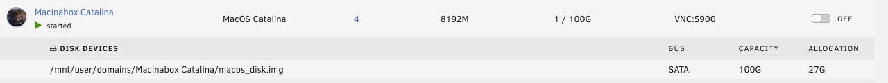

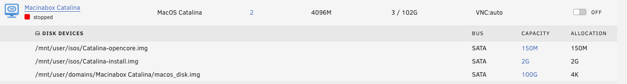

I just installed catalina, kept a copy of the vdisk and now I am upgrading to big sur. Will let everyone know if that works.
I have cleaned out everything, tried reinstalling with Catalina, with method 1 and 2 and still come to a point where I get the error "The recovery server could not be contacted" Is this some XML or something I am missing because this really doesnt seem like it needs to be this difficult. I follow the video to the word, so I don't know what I am doing wrong.
Logs from VM:
