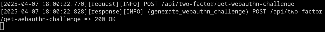

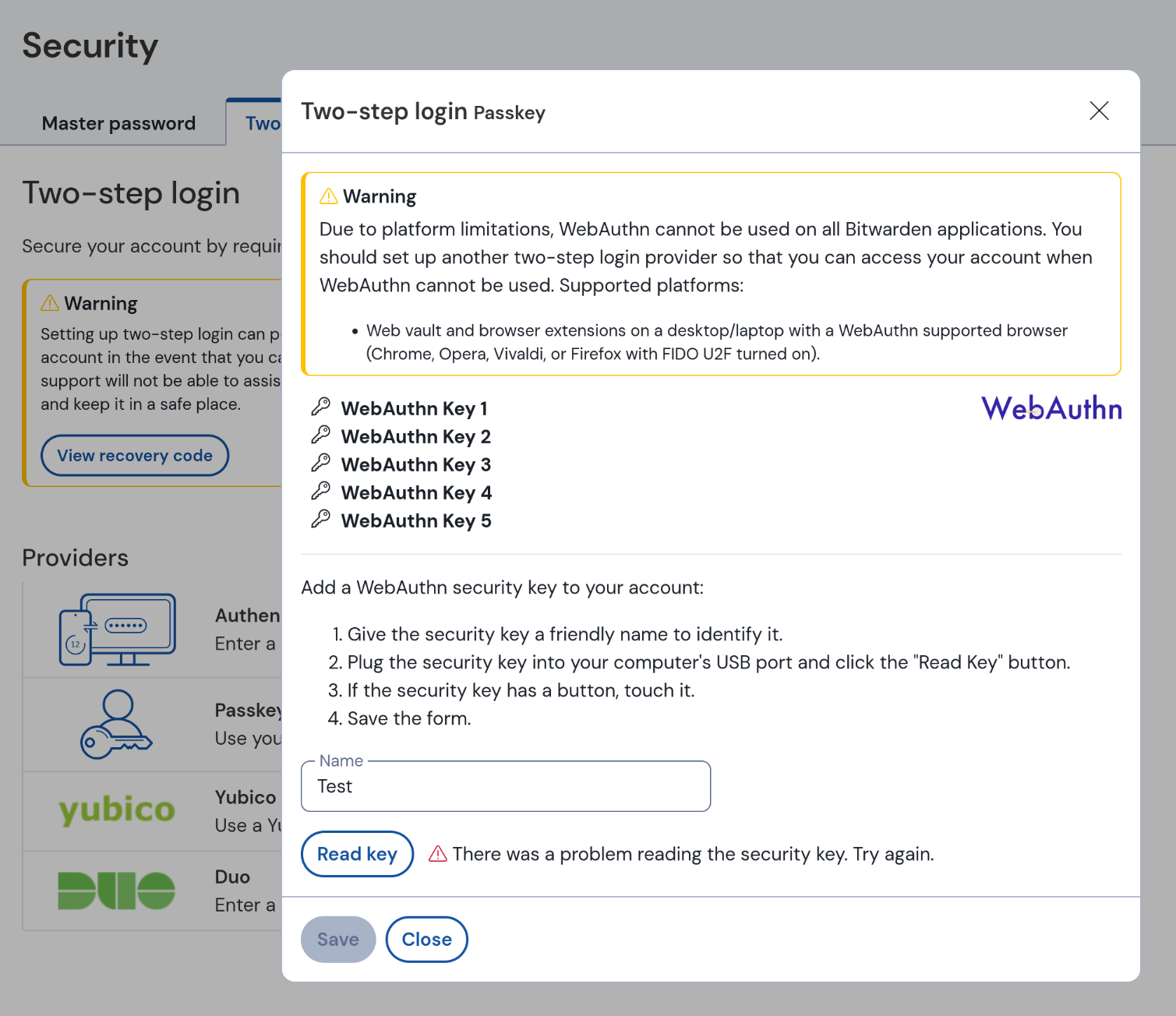

Have any of you ever gotten a FIDO key to run in vaultwarden? When I try to register my Nitrokey 3C NFC as a WebAuthn passkey and I click on “Read key”, all I get is “There was a problem reading the security key. Try again.”.

@Mark Augustin
I have 5 Keys registered in my Vaultwarden, 3 Yubikey 5C NFC, 1 Token2 Dual and 1 Token2 mini. Everything works like a charm.
Are there any infos in the container logs?
When I click on "Read key", this pops up in my container log:
Still, the webpage only shows me "There was a problem reading the security key. Try again.".
