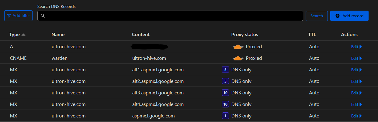

setting up reverse proxy: visted cloudflare > clicked on domain > dns records > added cname for warden

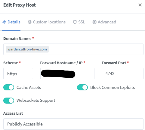

next I went to nginx proxy manager and added a new proxy host.

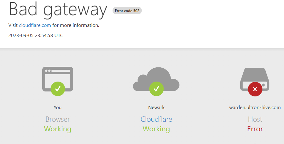

after which I click on the link and I get this error

Port 4743 is a HTTP port. Try to change it under Scheme in NPM and report back.
I attempted to use 8443 and I got the exact same results.
What port is in docker settings (see picture bellow). Do you use Let's Encrypt for your certificate? If it's the same as mine, change https to http in NginxProxyManager and save.
currently its set to 8443, as I mentioned. So, I reset it back to 4743, like yours. I then set nginx to 4743 again, but switched it to http. Which I've done in the past. However, I got the same results.
