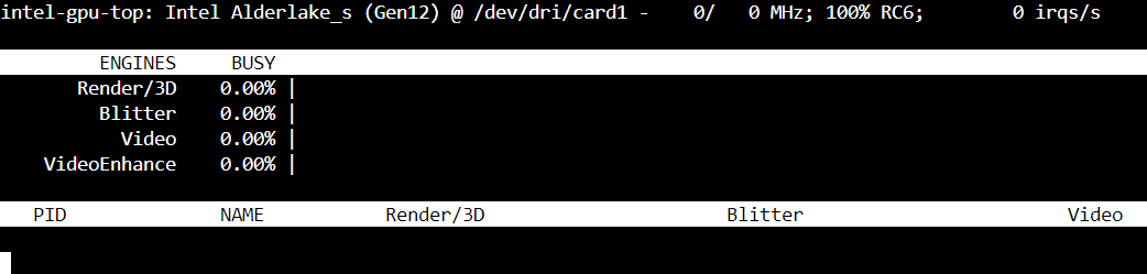

Hi @ich777
intel_gpu_top shows igpu interactively but doesn't see to create json. This was from one of the 13xxx machines.

can you provide intel_gpu_top -L and which cpu do you have?
does intel_gpu_top -Jo - -d pci:slot=0000:00:02.0 produce any output

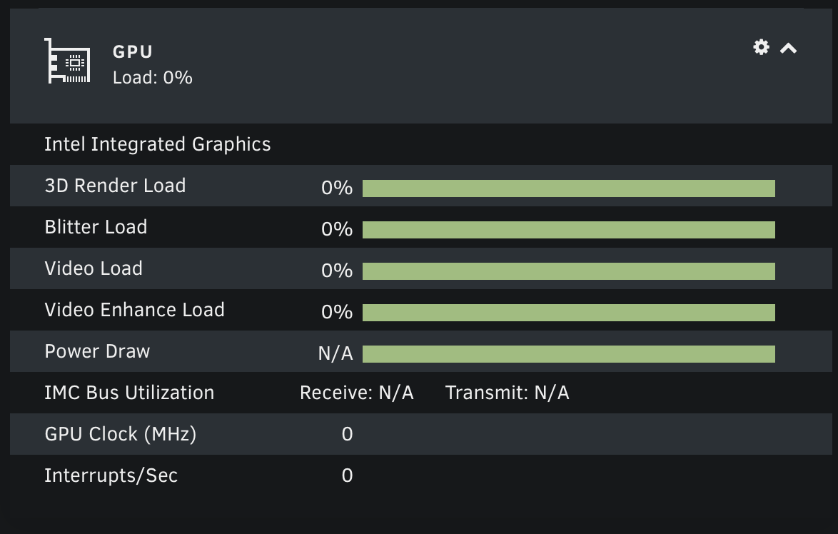

Does that planel work now in dashboard? can you provide cat /tmp/gpujson2 as that looks ok
No still N/A

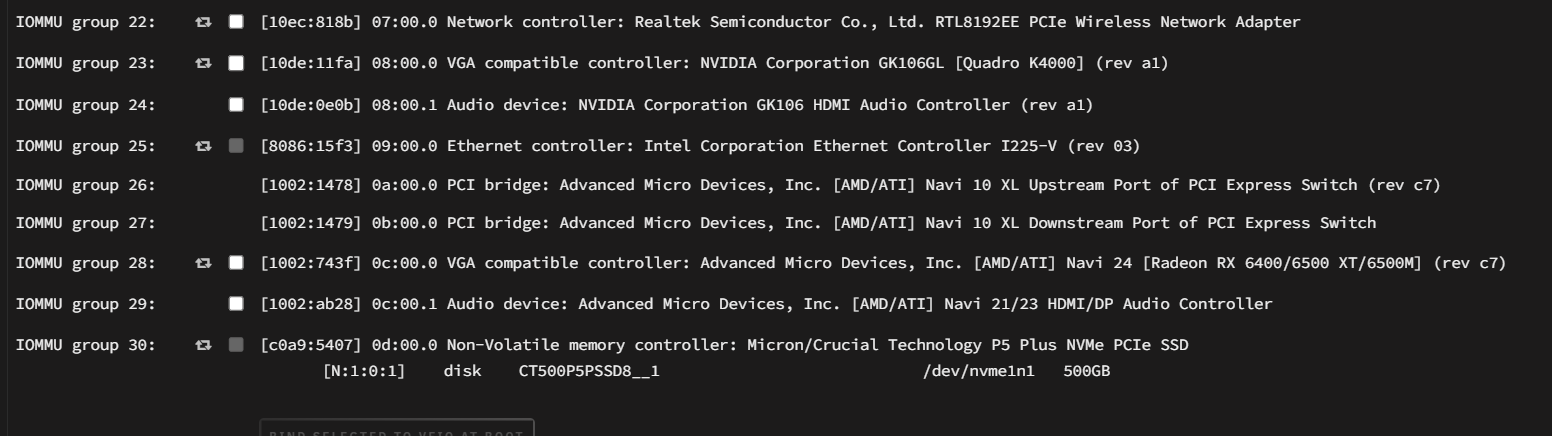

Ok just worked out what the problem is the AMD gpu is being picked up by the intel_gpu_top command hence no data, pre 6.12 it does not specify a card. Are you using the AMD for transcode, if not if you bind to vfio the command wont see it and it should show the iGPU in the dashboard.
Edited by SimonF
Added it for VM testing etc not for transcoding as I had a P400 for that which i removed.
How can i bind the Intel?
Goto tools=>system and tick the box next to the AMD cards to bind them to vfio. Was double checking your config, looks like there may be a bug writing the GPUID in the config file.
VENDOR="intel"
GPUID="0000-00-000-000000"
do nano /boot/config/pluging/gpustat/gpustat.cfg
change GPUID to be ="0000:00:02.0"
Dont bind intel to VFIO as the system will not see. But dont thing you need to do that now.

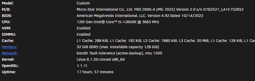

So  my system does not have check box options ( used to in older versions on unraid )
I modified the Config file ( FYI path is wrong you gave me, you ment plugins/ ) and added the 0000:00:02.0
Edited by CrazyBoyS
sorry about the path is it working now?
It will be because you have not enabled IOMMU function in BIOS which will be needed for passthru.
Yup realized that when I was writing the last comment. 😅
Forgot to enable VT ugh. Can't reboot atm wife on plex. I'll post as soon as I make the change.
