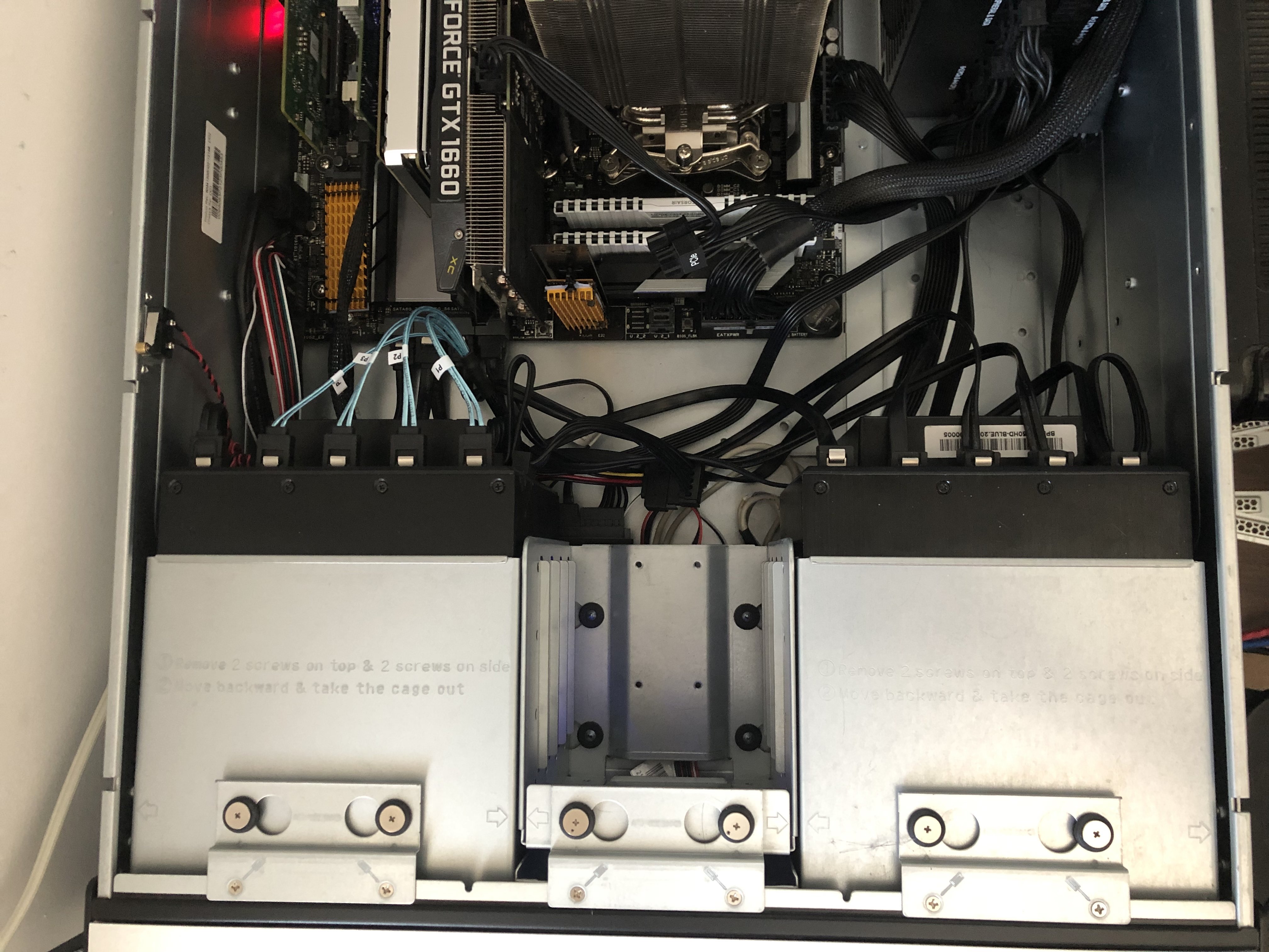

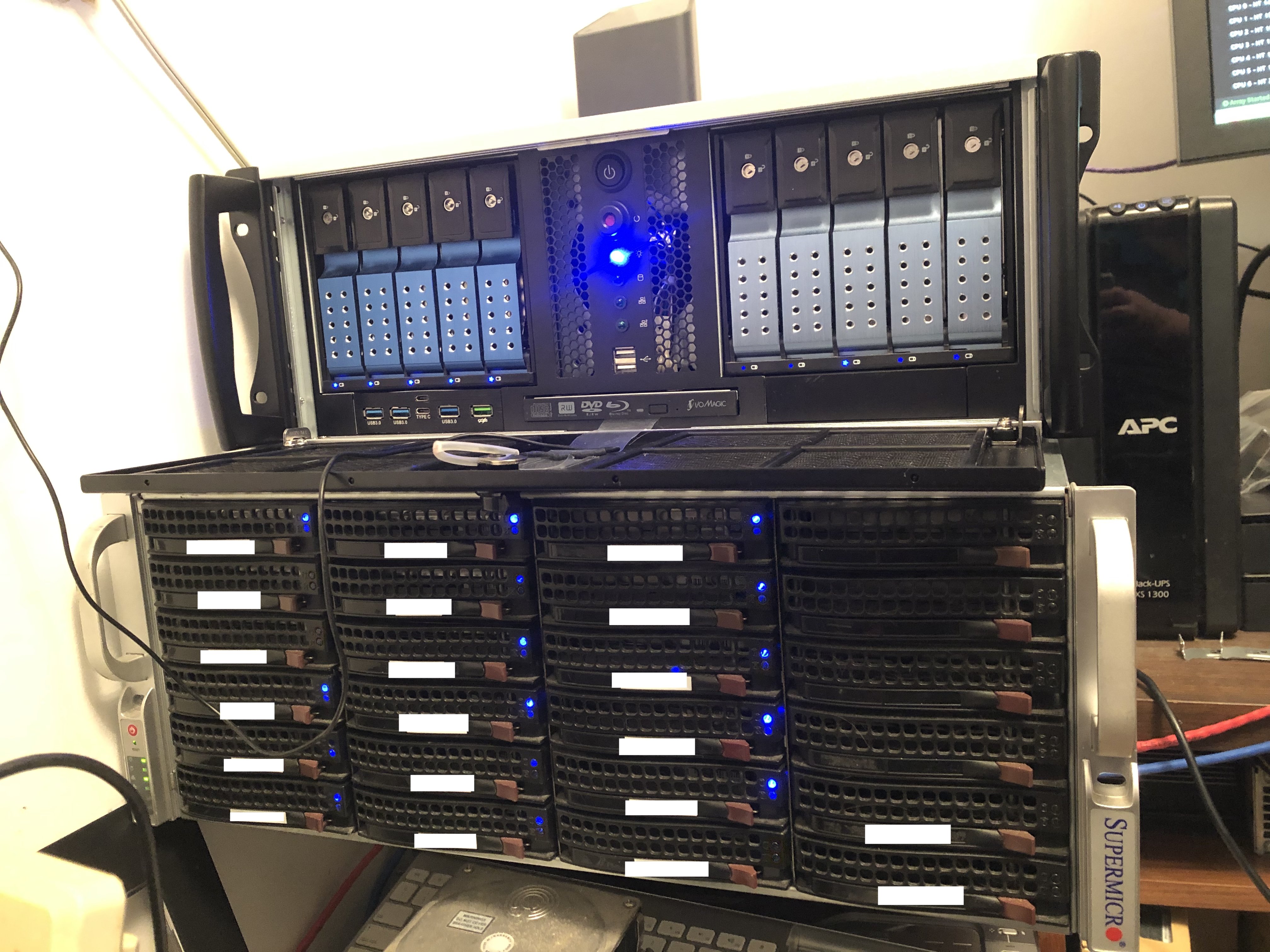

And yes, the RM42300 can hold 16 drives - 2 x 5 bay hotswap modules for 10 drives, 4 in the middle cage behind the front panel USB ports/LEDs/switches and 2 more in the 3.5" bays below the left and right drive bays. You will have to remove the fan module from the left side of the case, and purchase the extra 3x5.25" cage for the Chenbro.
The part number for the 2nd cage is 84H342310-003. It's the same cage that Chenbro provides for the right side and cost me $25 CAD from a local shop that carries the Chenbro line.
Note that if you do put another cage in and remove the fan module, you'll definitely want to get a decent 80mm fan for the rear of the case that pulls air from the front over the drive bays and motherboard compartment, and exhausts it out the rear. I haven't been able to install the 2nd cage on the left as my video card is too long, preventing the cage from being installed correctly.
As shown in the picture in my previous post, I used one of the bottom 3.5" bays for a front panel USB module. The RM42300-F1 has USB 2.0 ports in the center front section, but the RM42300-F2 has two USB 3.0 ports. I added the 3.5" USB module as I got the F1 version of the RM42300.
When I get the RM41300 with it's increased length (full size 4U, like the Supermicro CSE-847), I'll be able to install the left side cage that I've got waiting, also with 1 of the iStarUSA 5 bay hot-swap units. So my RM41300 will have 10 hot-swap bays at the front plus the 36 hot-swap bays in my Supermicro CSE-847.

The drive I'm using is a Matshita BD-MLT UJ240AS which is 12.7mm. It's this one: https://www.amazon.com/Notebook-Internal-Panasonic-Tray-Loading-Replacement/dp/B0822XG6G1

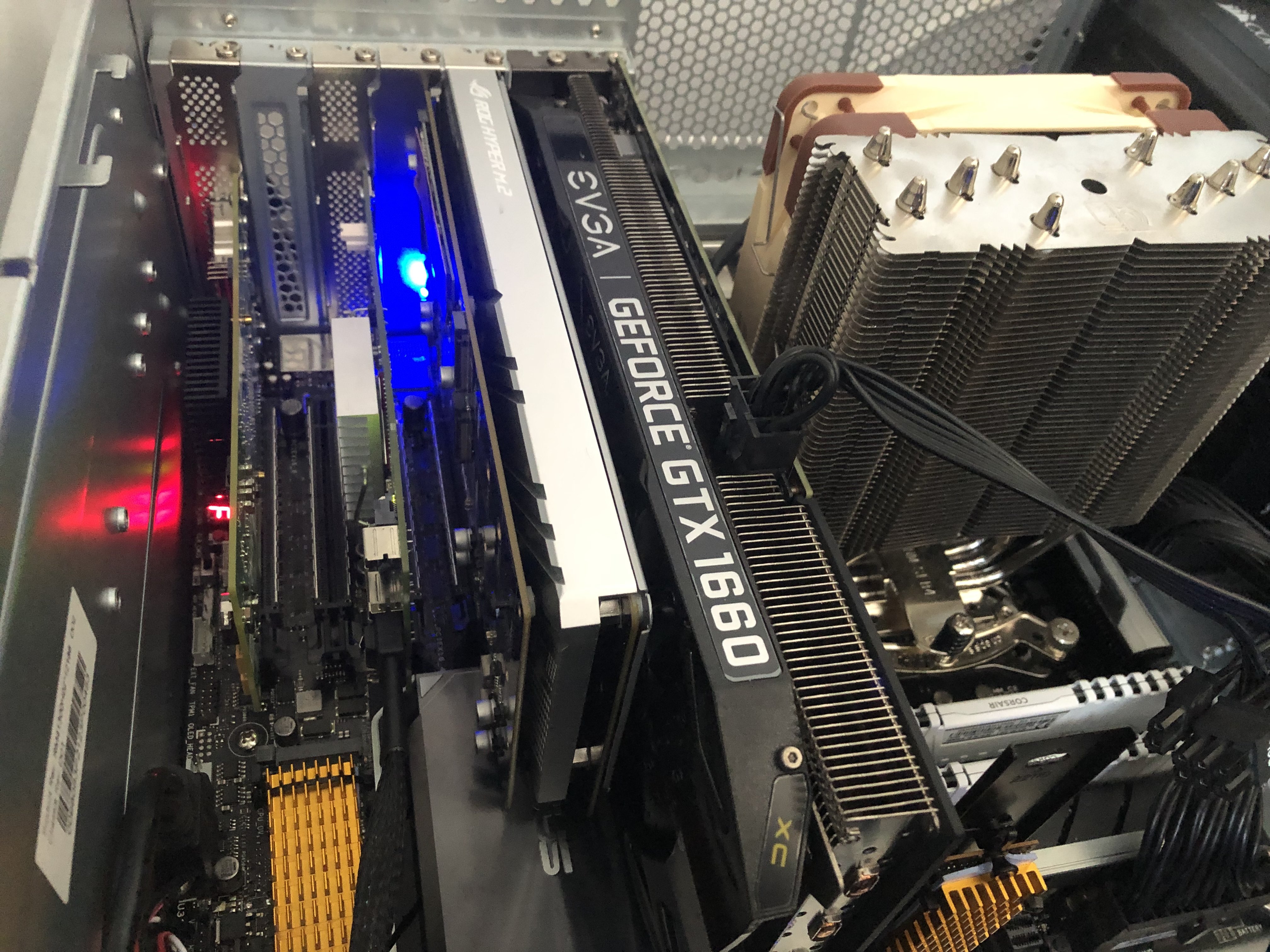

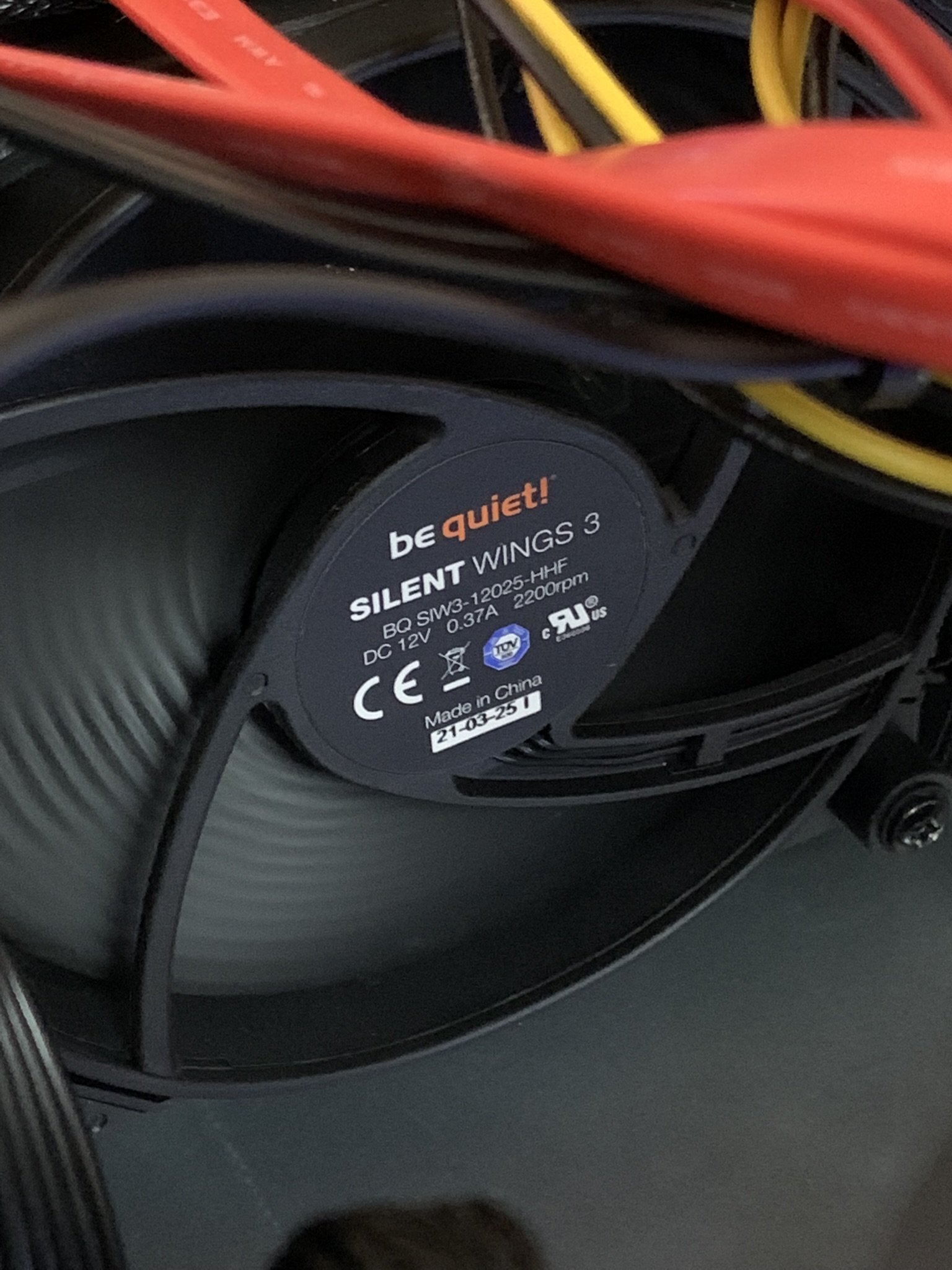

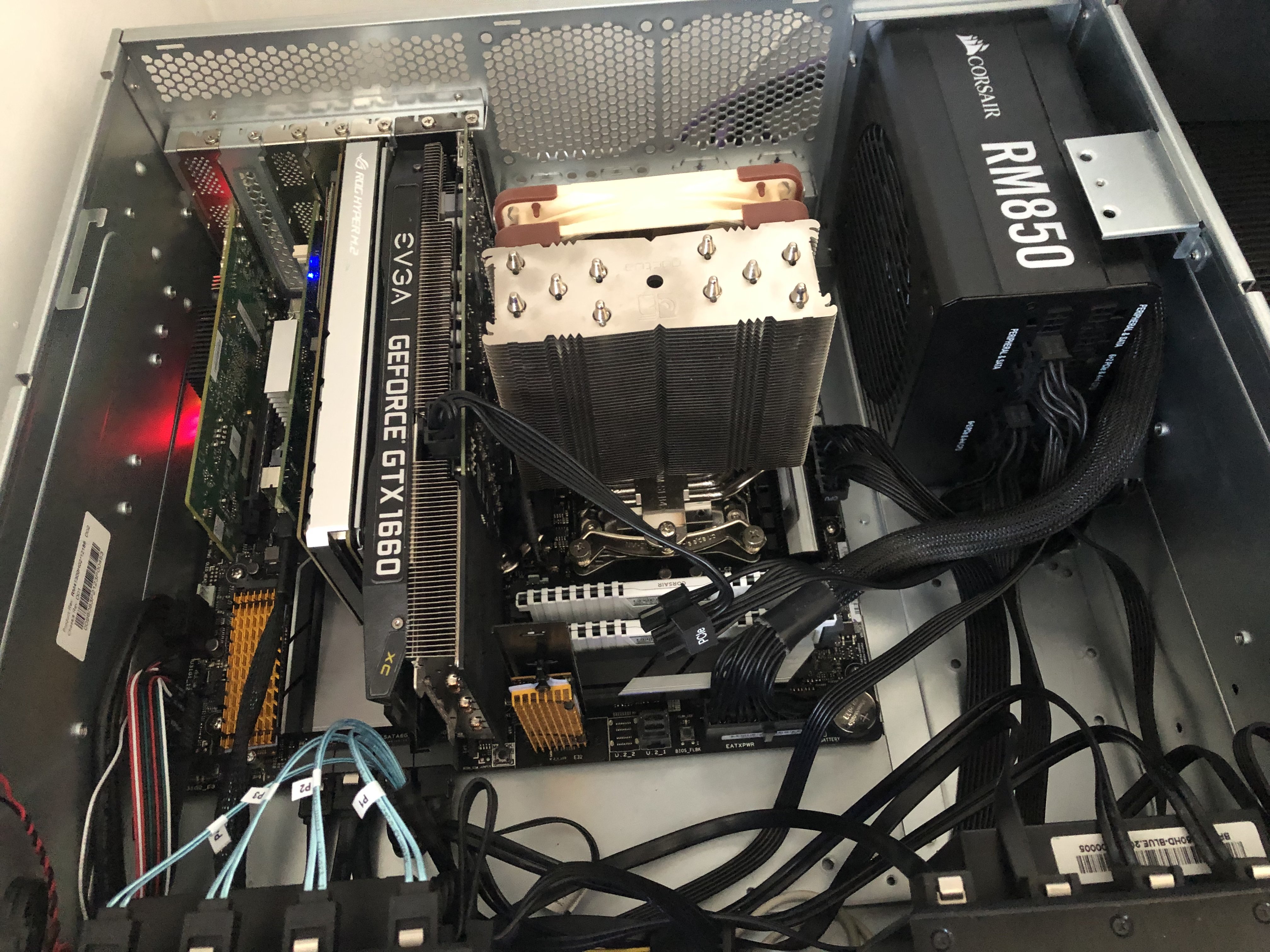

Ok took it apart to replace a broken fan (came that way) and added all the fans to a controller. The 120mm front fans have terrible vents and really should be 140mm or have a 3rd 120mm fan. The drive cage is as basic as it gets and you have to unplug everything to take the whole thing out to add or replace a drive. It's a budget case though and fine for what it is. Pics attached.
6b6ab6f0b4de2c112df47cf7fc334dd0.jpg92edc2c6583ba9a8aa08cc9d61cd08eb.jpg37cebefb1dfad0d361d62c518db9c672.jpgd105649a7b508cbaf08abe4e697cac59.jpg2a1ac1d426d37919faf78e1e3e7ed206.jpgb4458816be48f3198c547d8ef73d906e.jpg
Sent from my SM-G991U using Tapatalk
I could be wrong but it looks to me that some of your fans are blowing the wrong way.

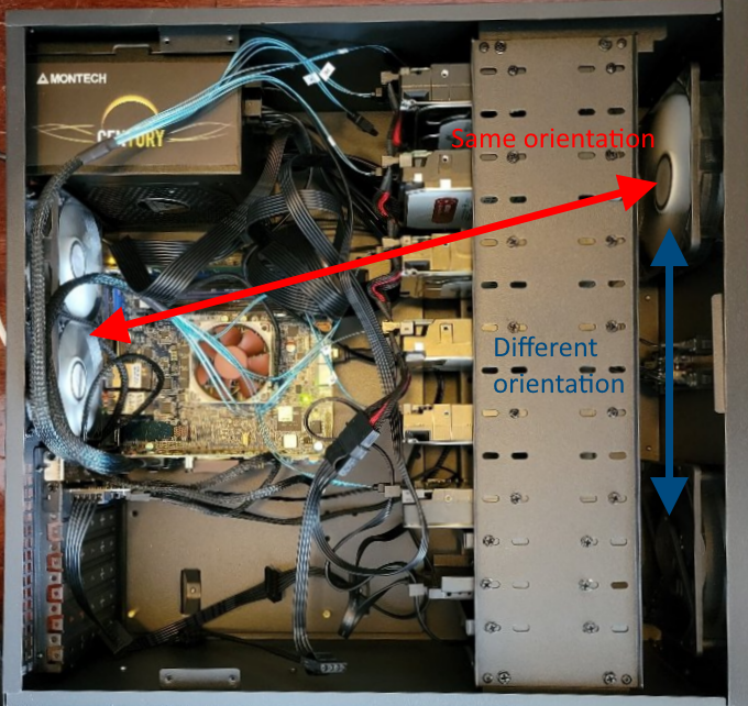

FYI, I've migrated my main unRAID system to a Chenbro  RM41300, essentially a full-size rackmount but uses the same drive cages as the RM42300. I finally added a 90mm fan to the middle 4 drive cage (not shown in attached pics) and one more 90mm at the rear of the case. There's room for one more but I didn't have another 90mm fan on hand and so far the temps inside the case are quite nice - 30 - 40C max. I'm holding onto my RM42300 as I have plans to migrate my 2nd unRAID system out of the Fractal Design Define 7XL.
Guess I'd better double check but I'm 99% sure the two fronts are intakes and two rears are exhaust.
I guess that JonathanM's comment was :
Exactly. Normally PC fans exhaust on the side with the motor mounting spokes, the fan in the top right of this picture appears to be blowing out.
@Smitty2k1, thank you for the excellent photos. They give me the information I need. There is less room under that cage then I imagined for cable management. But to your point, it's does it's job of giving a large quantity of drives in a cheap "no frills" case.
Thanks for the update and the photos. I'm quite jealous of that deeper depth. I'd give quite a bit for a few extra inches beyond the 20" maximum I have today. The RM41300 is quite well laid out for versatility, and those dual hot-swap cages are very nice.

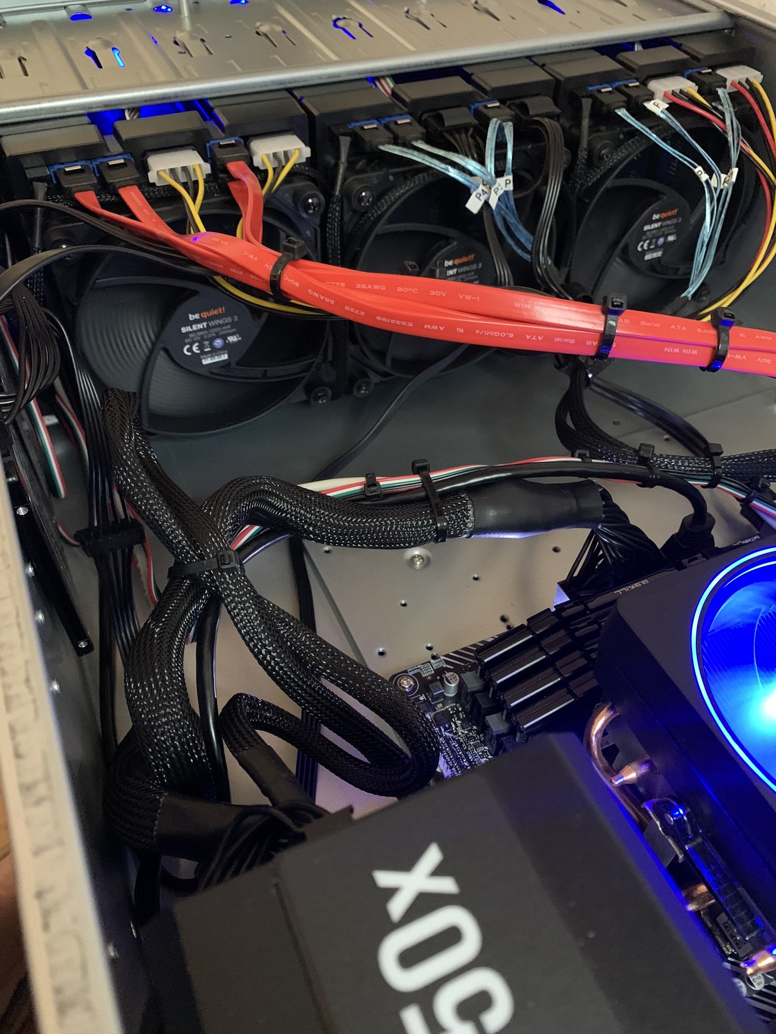

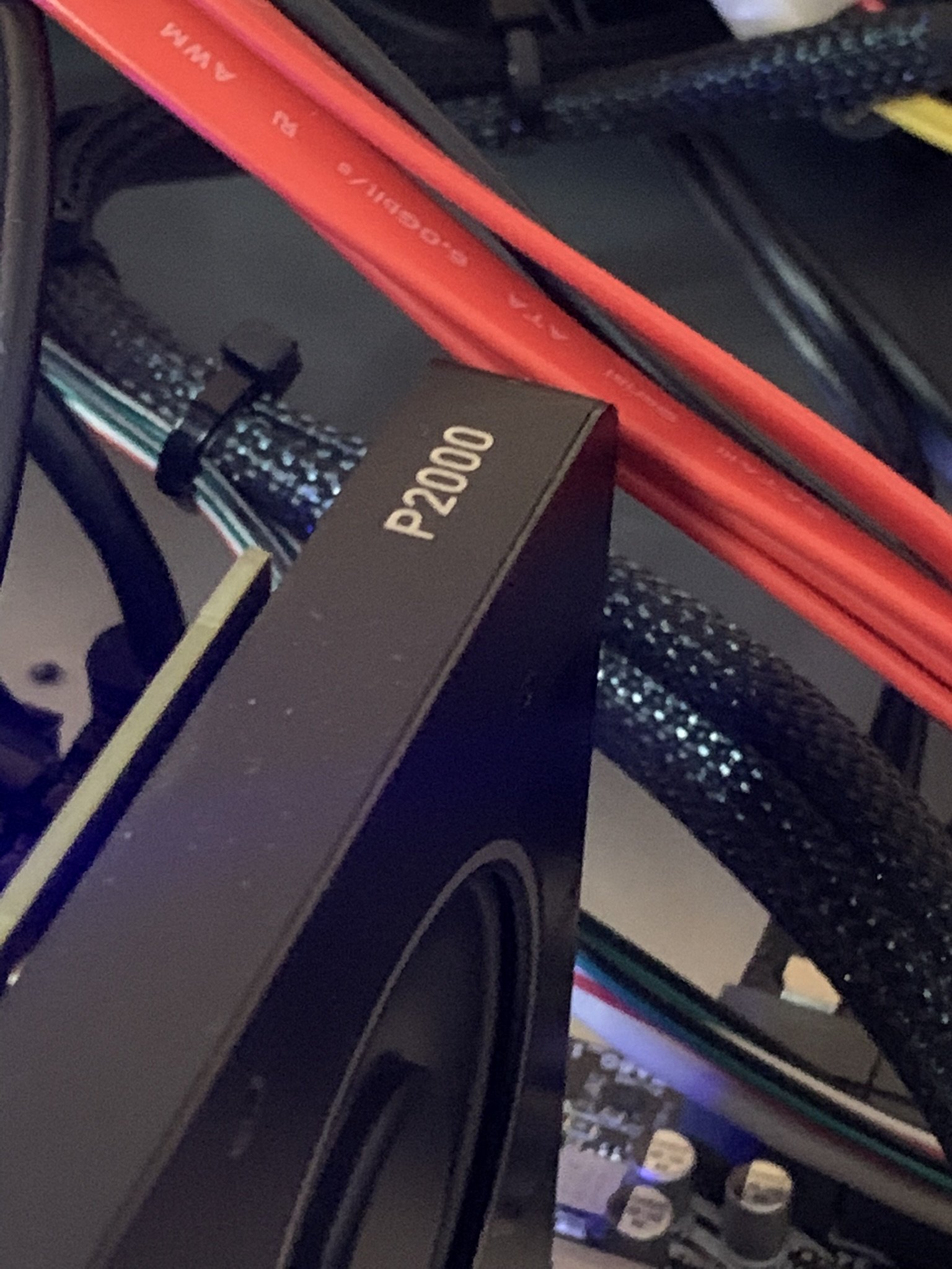

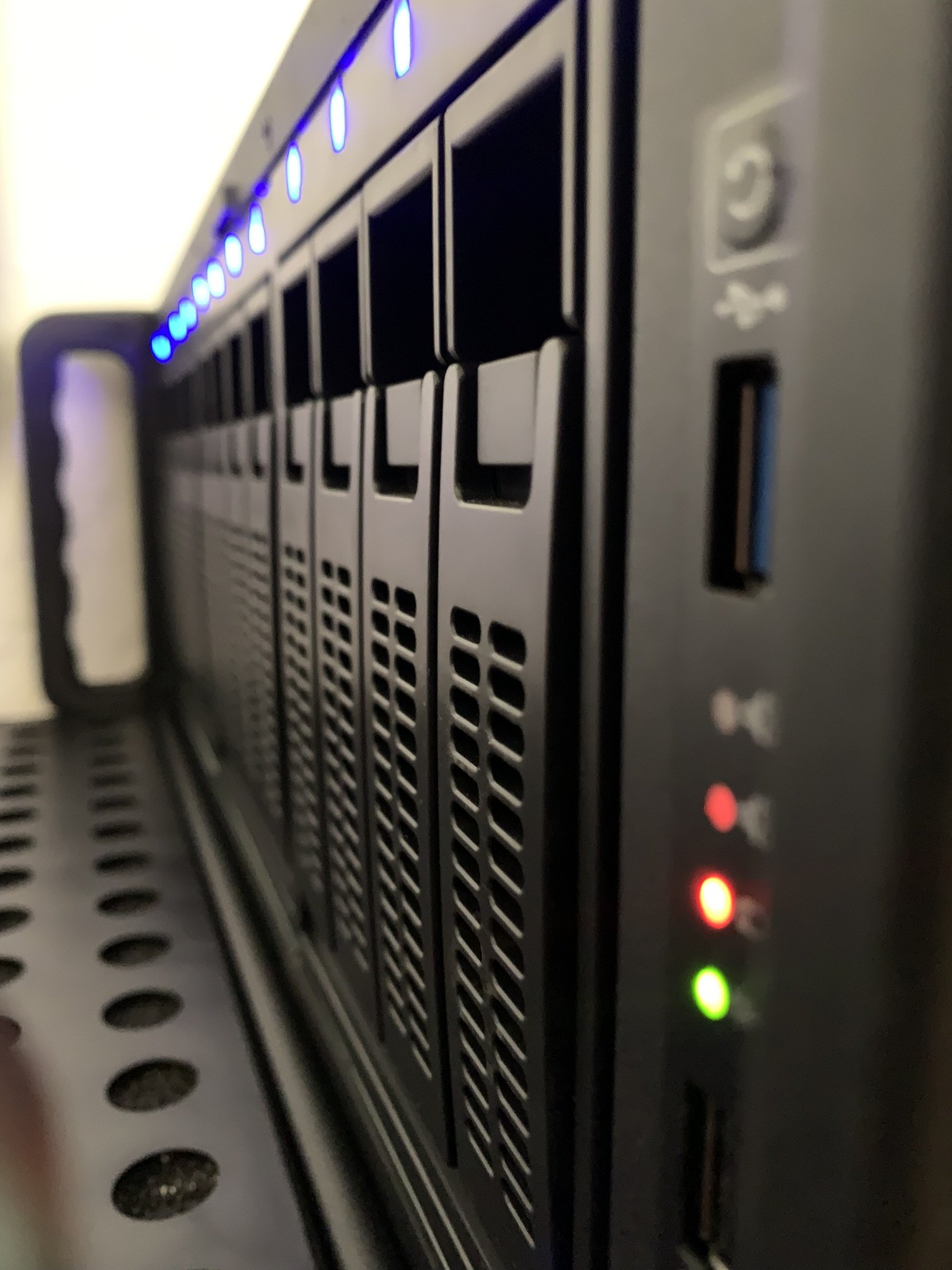

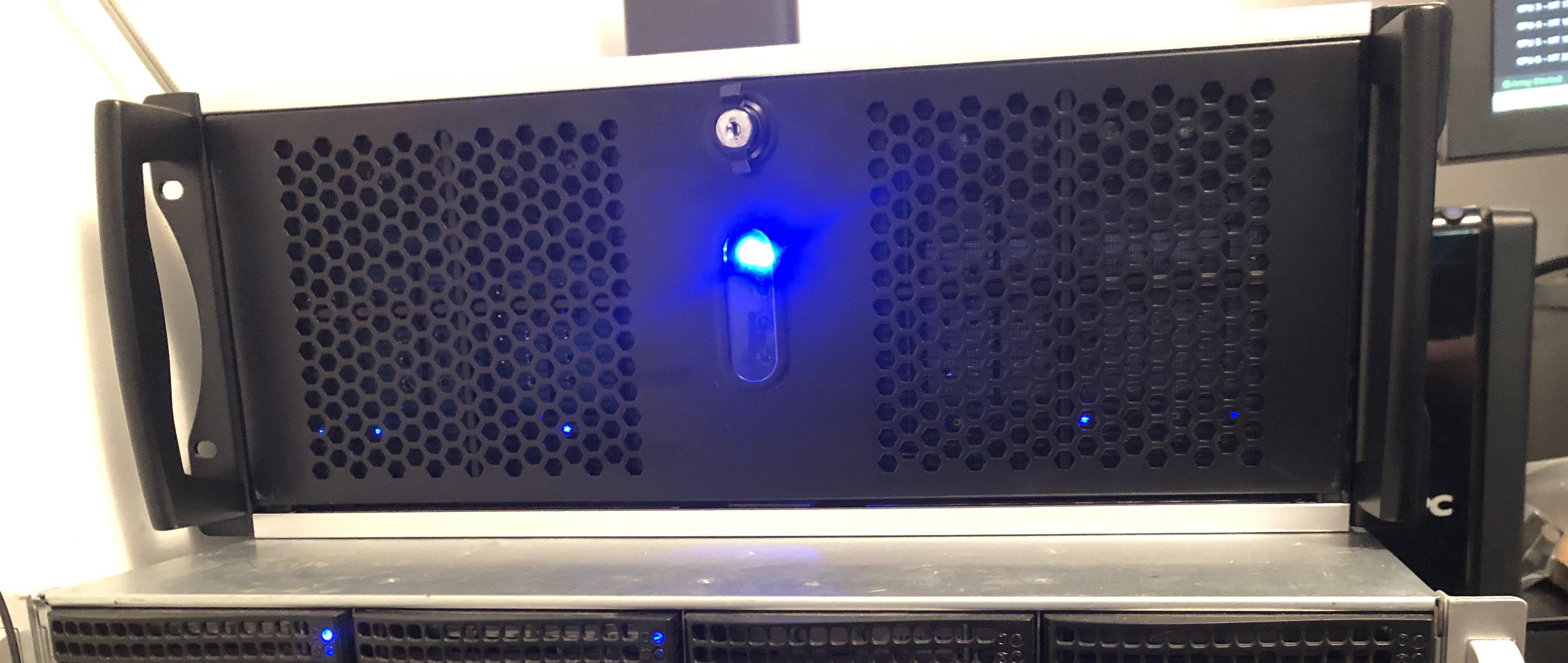

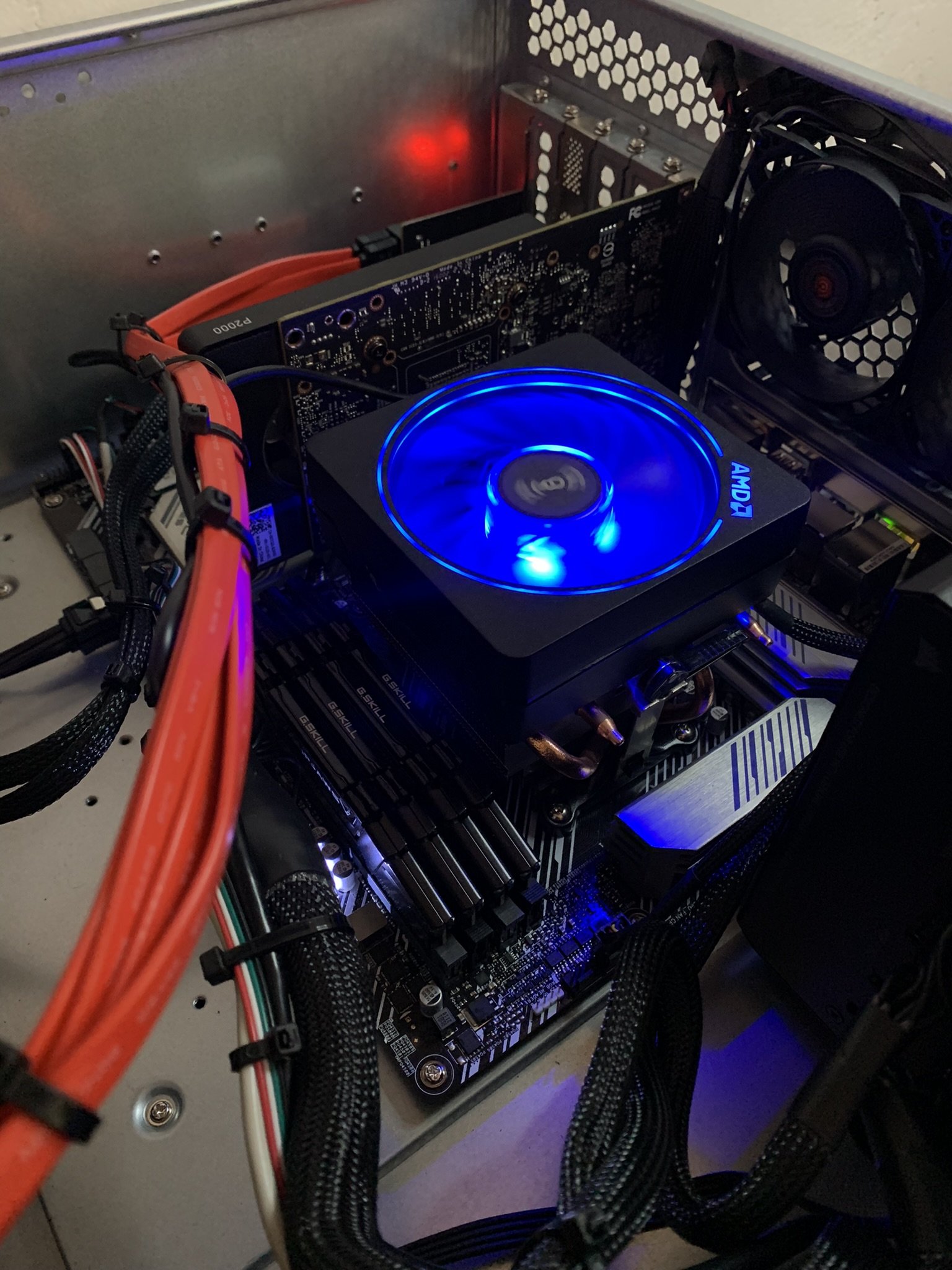

Just wanted to share the new setup I just finished upgrading too this past weekend. I previously had built a 2 in 1 system using a Phanteks Enthoo Case. But I finally pulled the trigger on a Rosewill RSV-L4412U 12 Bay Hot Swap server case.
Specs for the system are:
Hardware:
Asus Prime B550-Plus
AMD Ryzen 9 3900x Twelve-Core (stock speeds)
32 GB DDR4 3600 G.Skill RipJaws V Series
NVIDIA Quadro P2000
LSI SAS2008 PCI-E Fusion-MPT SAS-2
IO CREST 4 PORT SATA III PCI-E Expansion Card
Upgraded all fans to Be Quiet Silent Wings 3 3x120mm 2x80mm
Array:
1x WD 12TB (Parity) (Shucked)
1x WD 12TB (Shucked)
1x WD 10TB (Shucked)
4x WD 8TB (Shucked)
4x WD 4TB (Reds)
Cache:
2x 500GB Samsung 860 EVO SSD in Raid 0
Unassigned Device:
1x 1TB Intel Blue M.2 NVME (Plex_AppData)

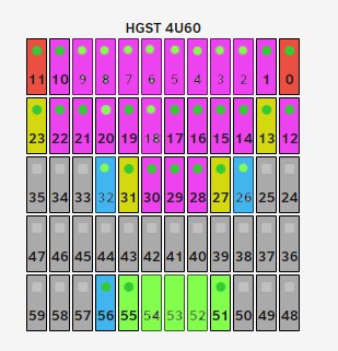

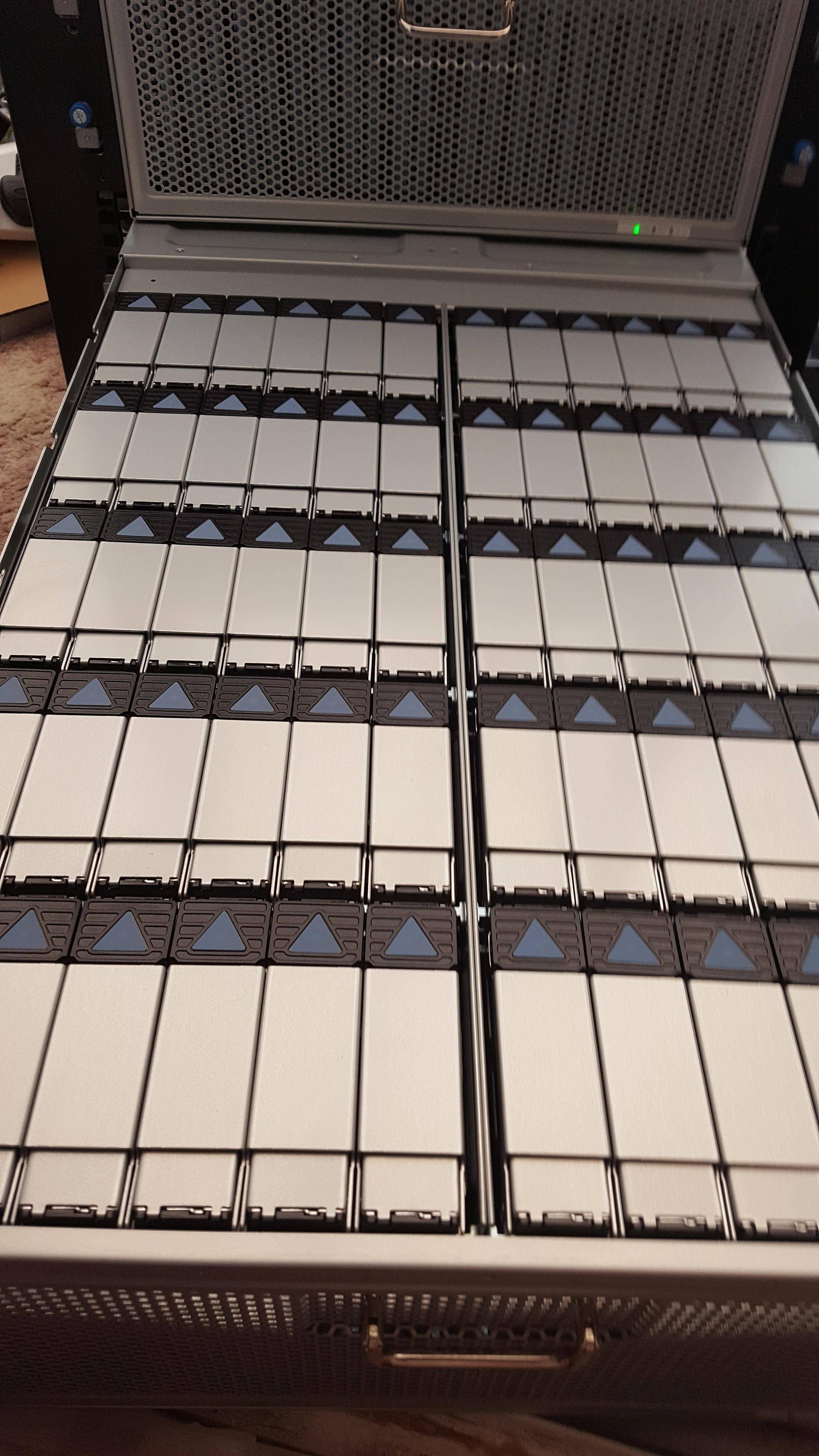

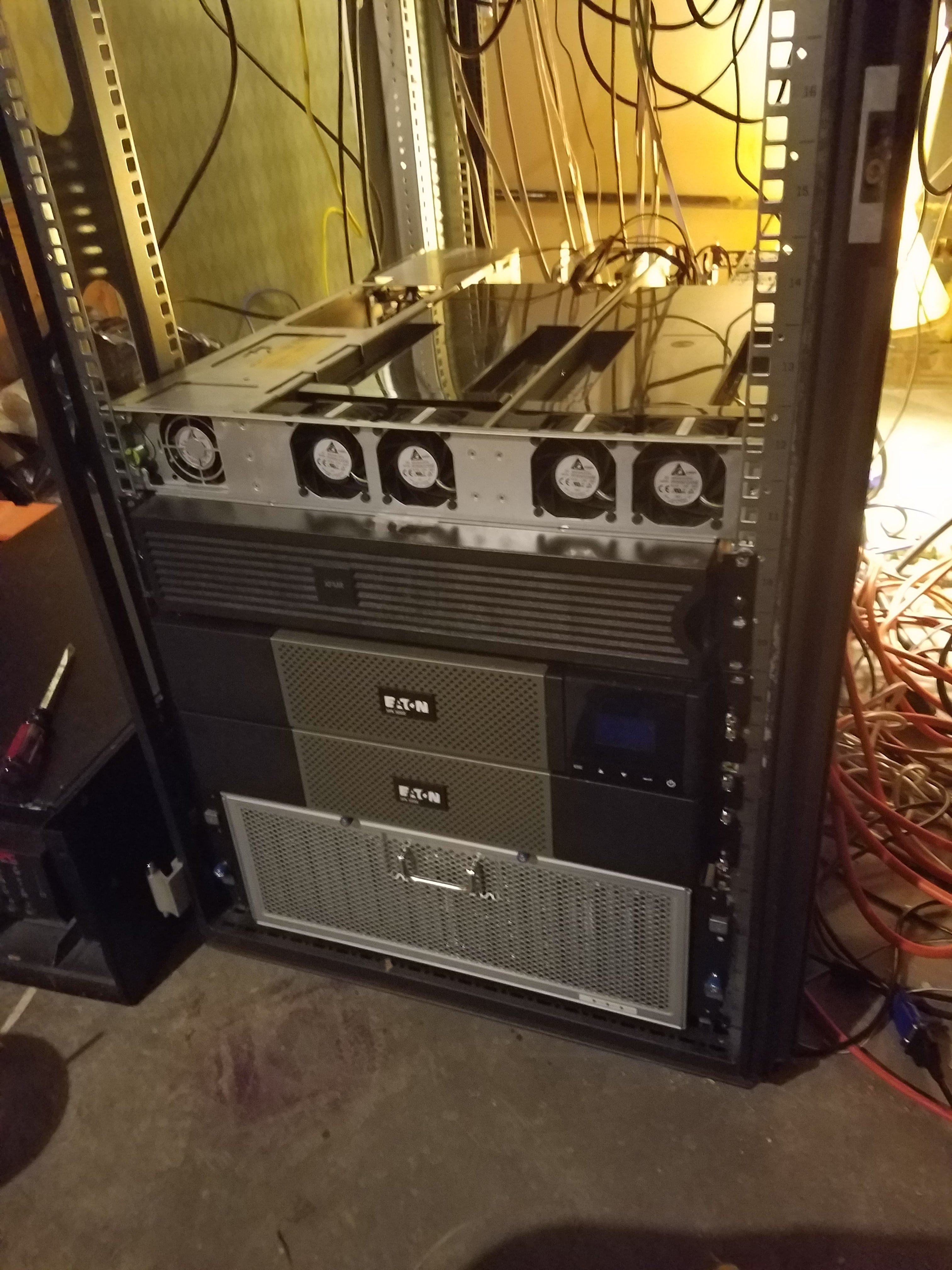

I have been super happy with a HGST 4U60 since 2016. 60 sas/sata drive slots in a 4u footprint and has an 80 watt idle with no drives if only using 1 of the psus. 12GB sas as well. There are some newer versions that are pretty much the same. I see them pop up on ebay occasionally. You probably would also want some kind of rack for it. It gets very heavy with drives
I did have to plan my server rack around having 240v power hookup as it is 240v only for power. There is one small benefit, 240v power is 3% more efficient than 120v so a little drop in the power savings bucket. That was most of a day running new electrical diy for that. But it has run flawlessly for years and years.
