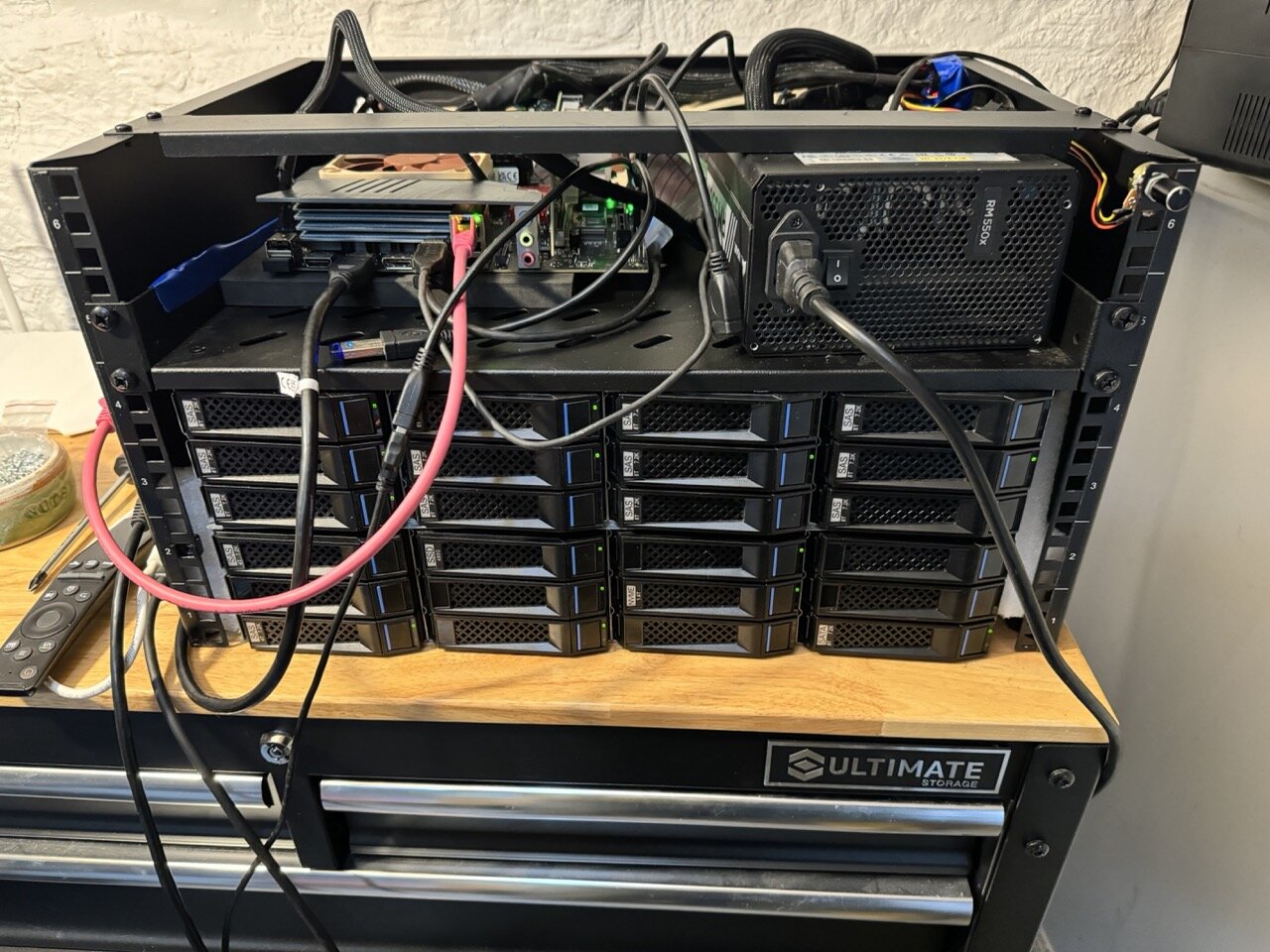

Re 24x case.
I DIY'd mine from a 6u rack on amazon with 2x 12bay sas chasis.
All in one motherboard & PSU sits on a shelf on the top 2u.
2x giant 200mm nocua fans cut into rear for cooling.
Very cool as its shallow depth case.

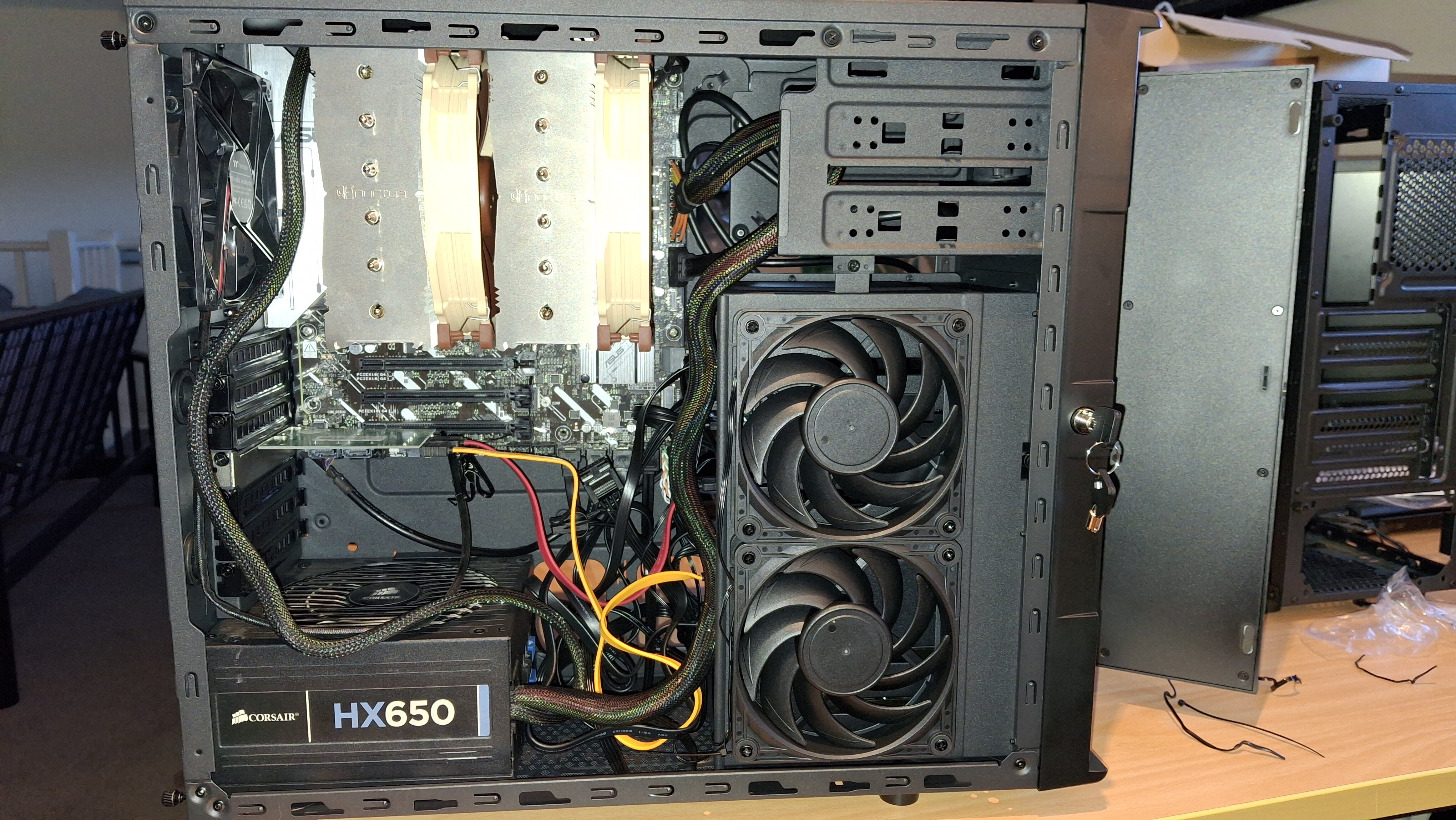

I am looking to upgrade the case for my unraid server. Been using Unraid now for a year and am happy with it and looking to grow the server.
I am currently using the Thermaltake Versa H25 Mid-Tower Classis Case which has been great as a starting point with unraid from the  hp proliant n40l microserver pre built nas i previously had.
I recently upgraded the motherboard/cpu to Asus Prime z890m wifi plus with Intel Core 5 Ultra 245k and Noctua D15 cpu cooler.
The space is now very tight and i cant access the drives docked in the top 5.25" section and i want to future proof so when i do need to upgrade the hard drives i dont need to take it all apart.
I saw in someones signature the
SilverStone CS380 Case Storage Series Black ATX Case  which looks perfect. Anyone with this recommend it or not?
My requirements is currently 5x 3.5" hdd and a couple of ssd. 8 Bays would give me room for future upgrades.
Thanks
(current setup with Thermaltake Versa)

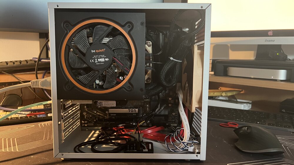

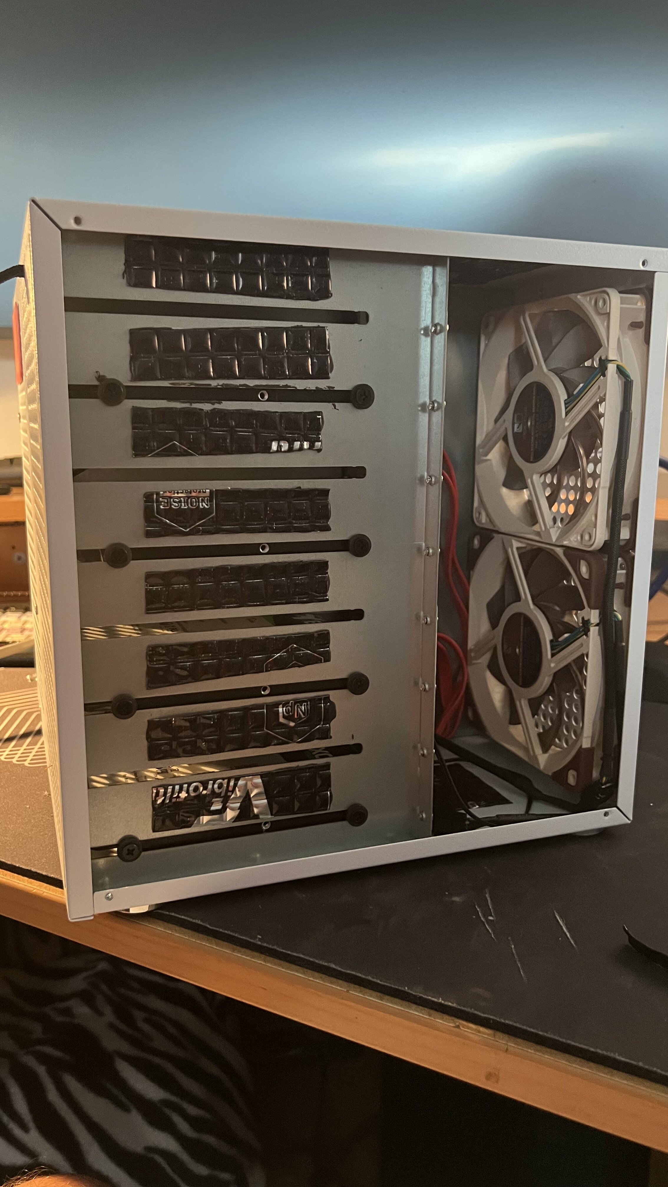

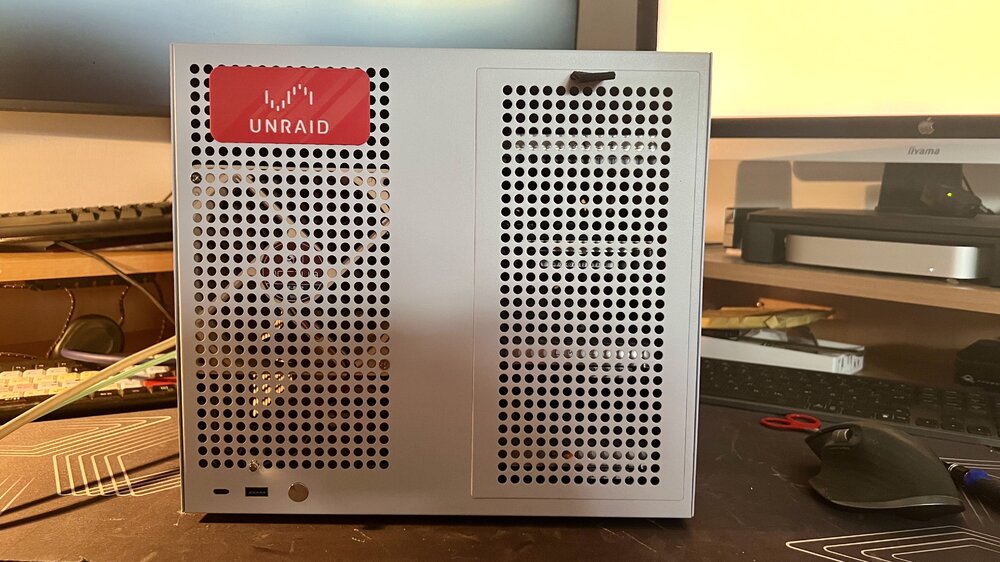

On 8/23/2024 at 4:40 AM, faxxe71 said:

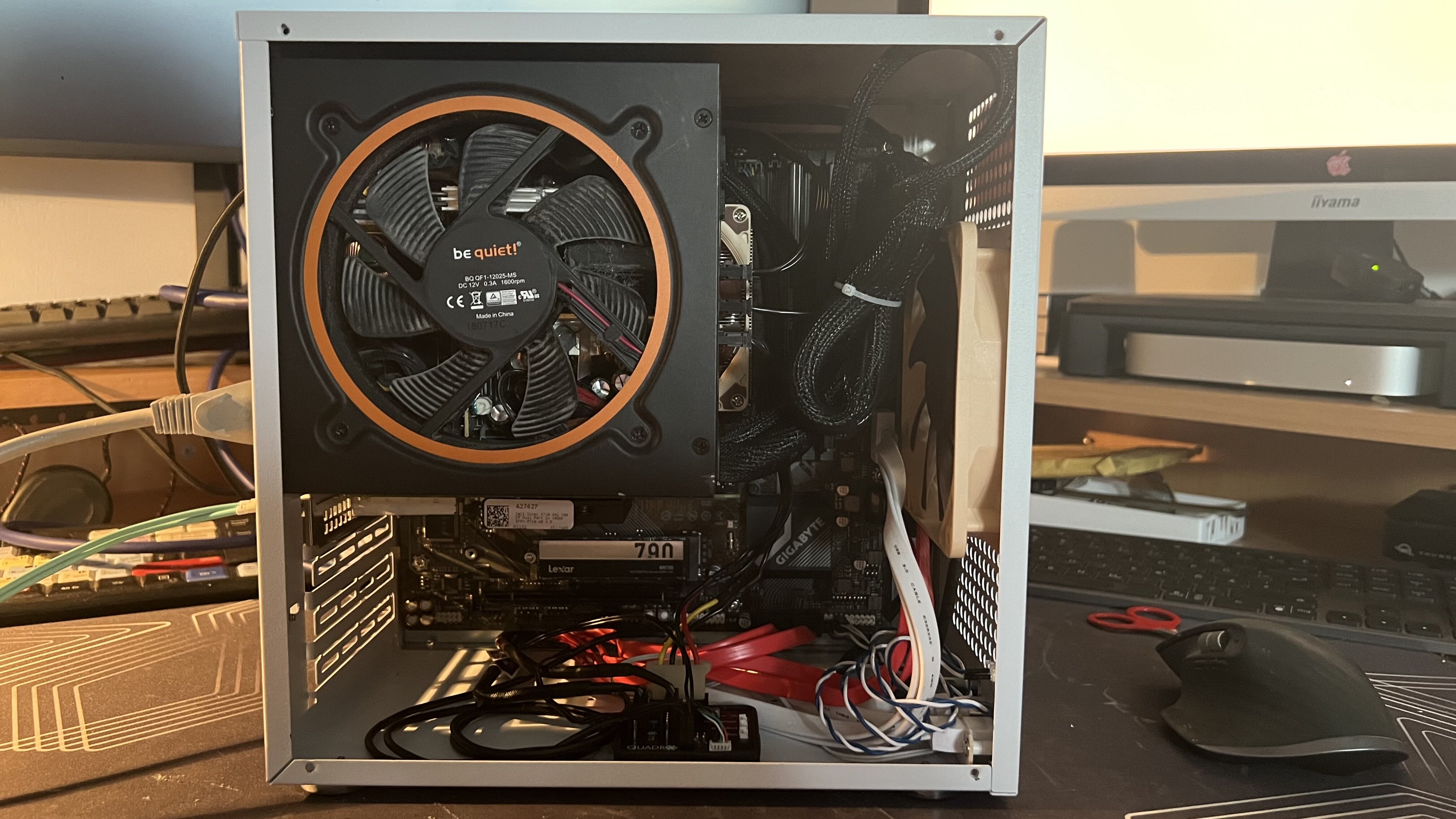

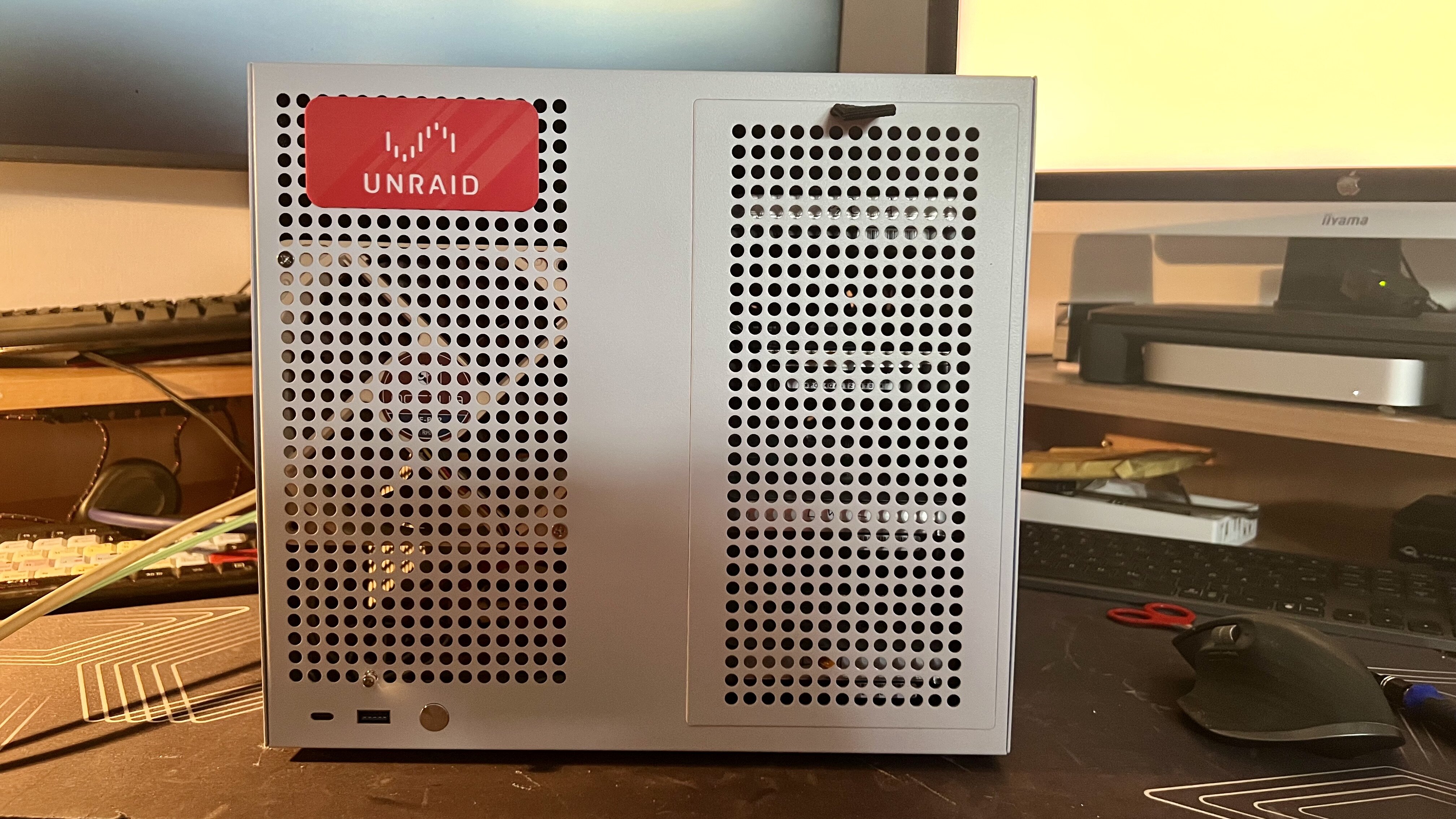

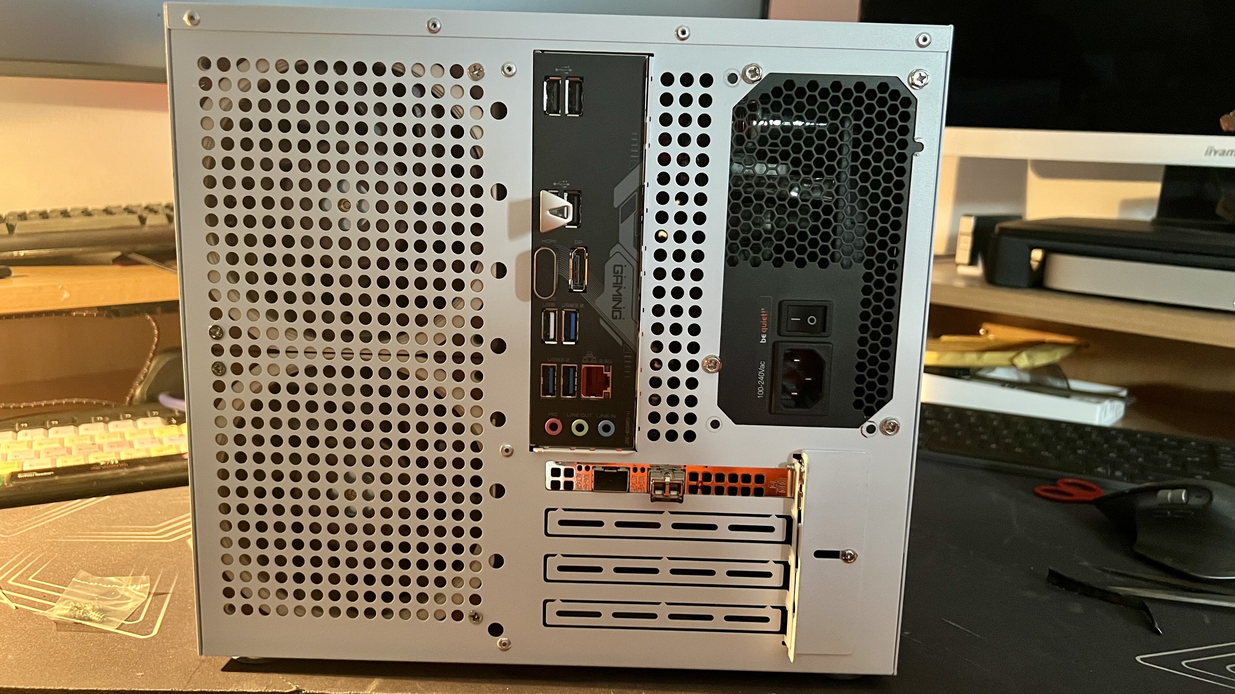

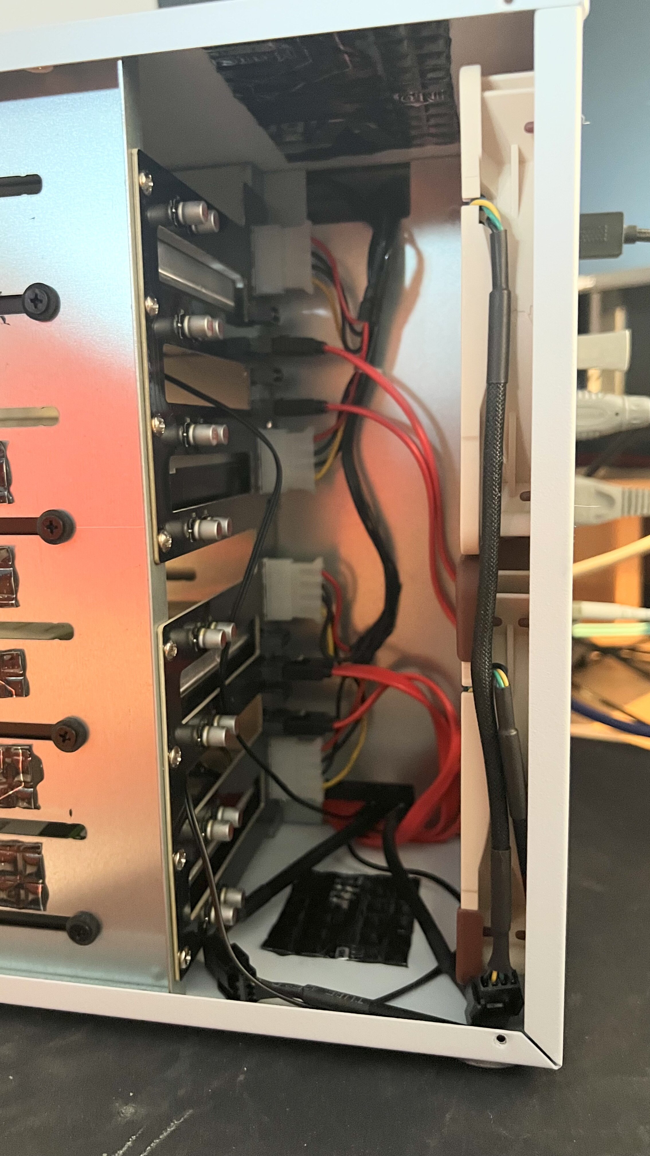

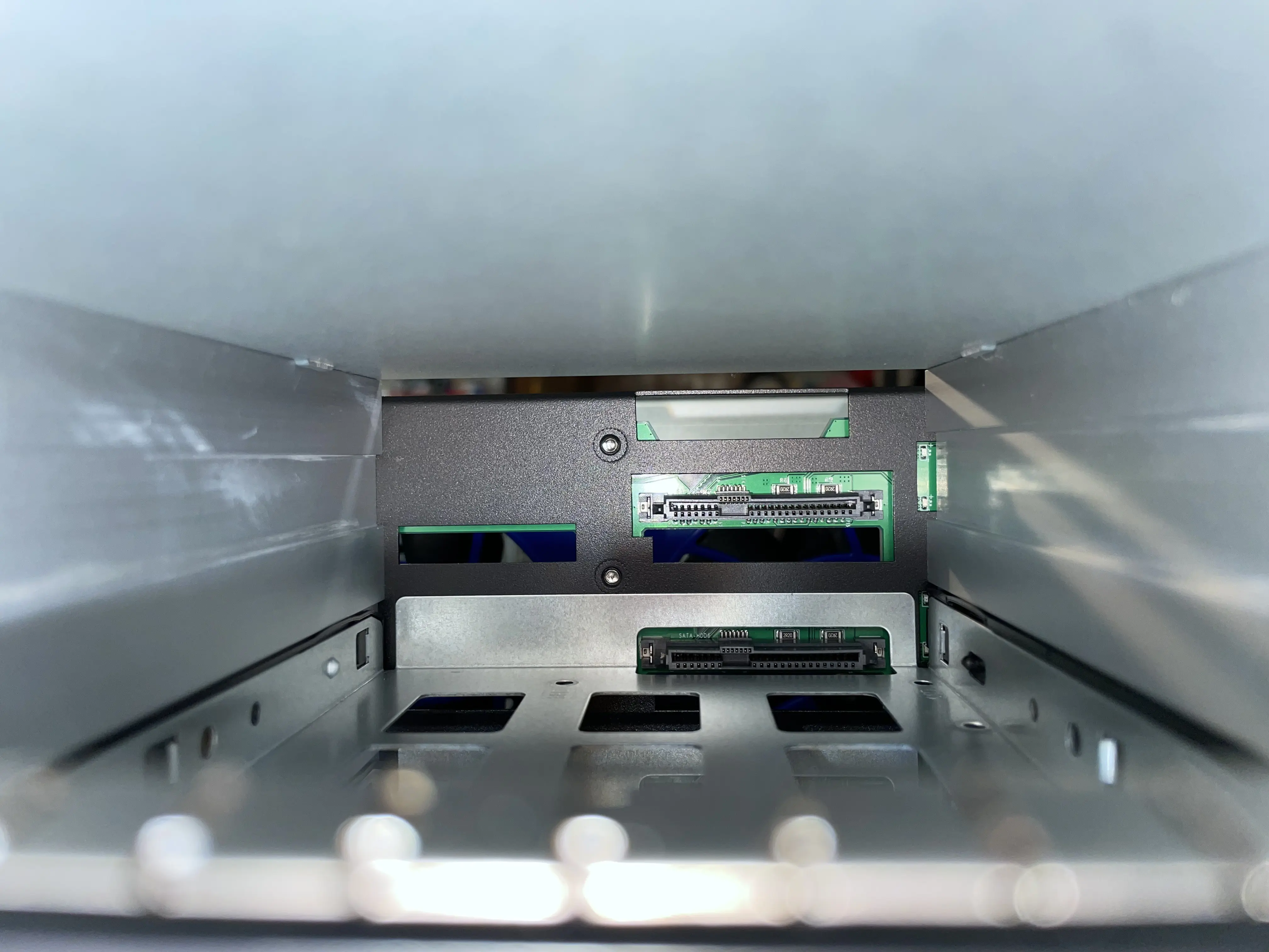

I have just moved my server from a Silverstone CS351 to a Sagittarius 8-bay enclosure.
The CS351 is pretty but a thermal time bomb for the hard disks. That's why I got the enclosure from Aliexpress, which is hardly available here in Europe.
The enclosure is not expensive but worth the price. Since I only use 4 of the 8 bays (probably soon 5) there is enough cooling air. I control the 2 120mm Noctua fans with a dedicated controller from Aqua Computer.
There is another 120 mm fan in the mainboard area which is controlled by the mainboard.
The system is an i3-13100 with 64GB Ram and 2 NVME disks. An Intel x710 10 GB network card is also installed.
The case only has a front USB port and a power button. No LED or similar. The hard disks are inserted using rubber buffers and are therefore damped. The front of the hard disks can be removed without tools and disks can be changed during operation.
The delivery time was 4 weeks to Europe and the price €130.- including shipping.
The black adhesive strips in the area of the hard disks are aluminum butyl for damping the housing. They were glued on by me.
Aliexpress Sagittarius 8-bay nas
-faxxe

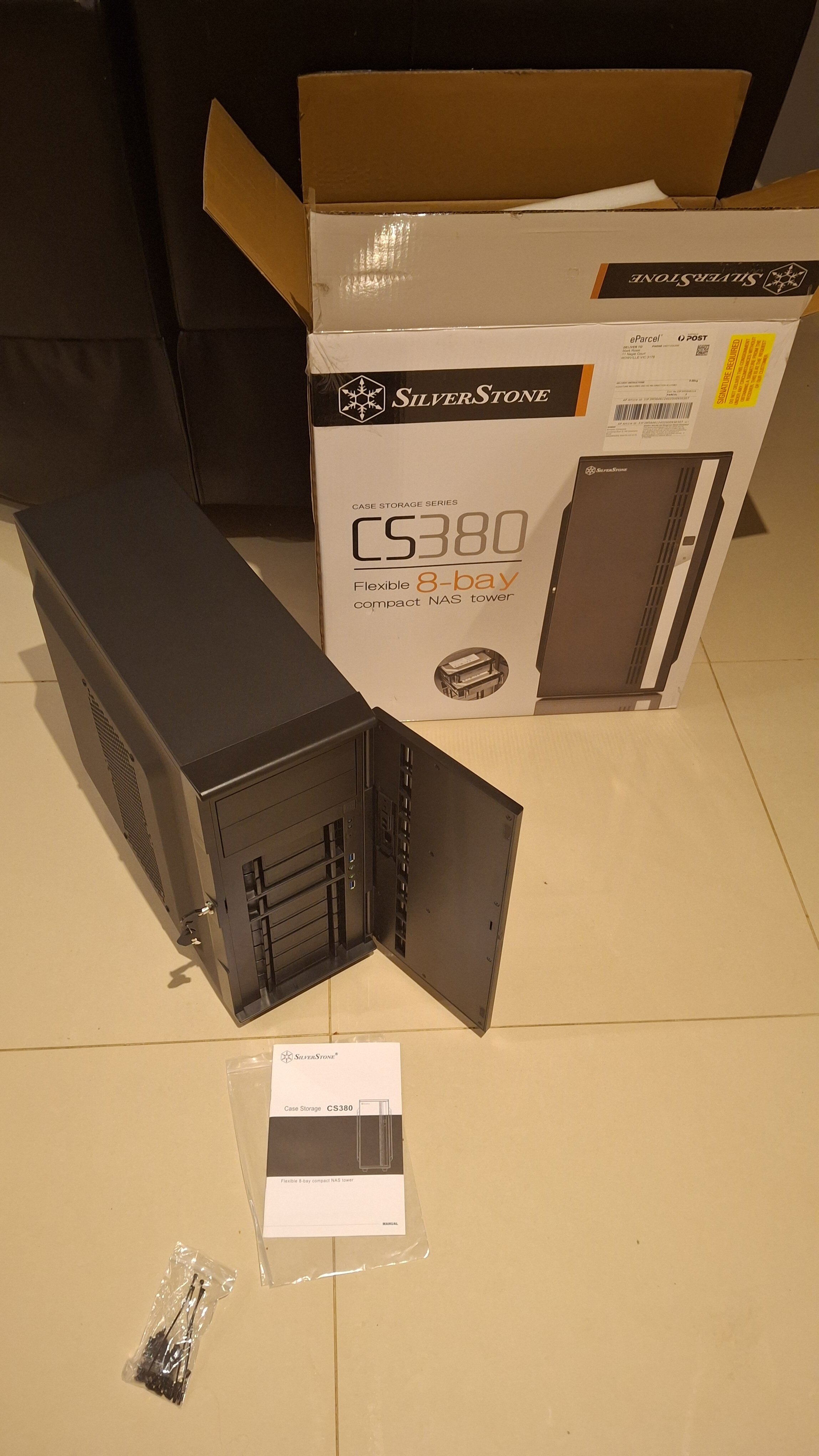

CS380 case arrived,  I just need to find the time to swap my server components into it.

On 3/8/2025 at 1:31 AM, Richard Mixon said:
Has cooling with 4 or 5 drives turned out to be OK as you expected? Also can you provide a link to the aluminum butyl strips you used?
Thanks - Richard
Hello Richard, sorry for delay.....
With 4 disks, it is extremely airy, as one slot remains free between each disk. However, I now use 5 disks and the cooling is also completely sufficient here. However, due to the application, I very rarely run all 5 disks together. But then they stay very well within the 33-36 degree Celsius range.
Here is a search link in the German Amazon:
https://www.amazon.de/alubutyl/s?k=alubutyl
Best regards,

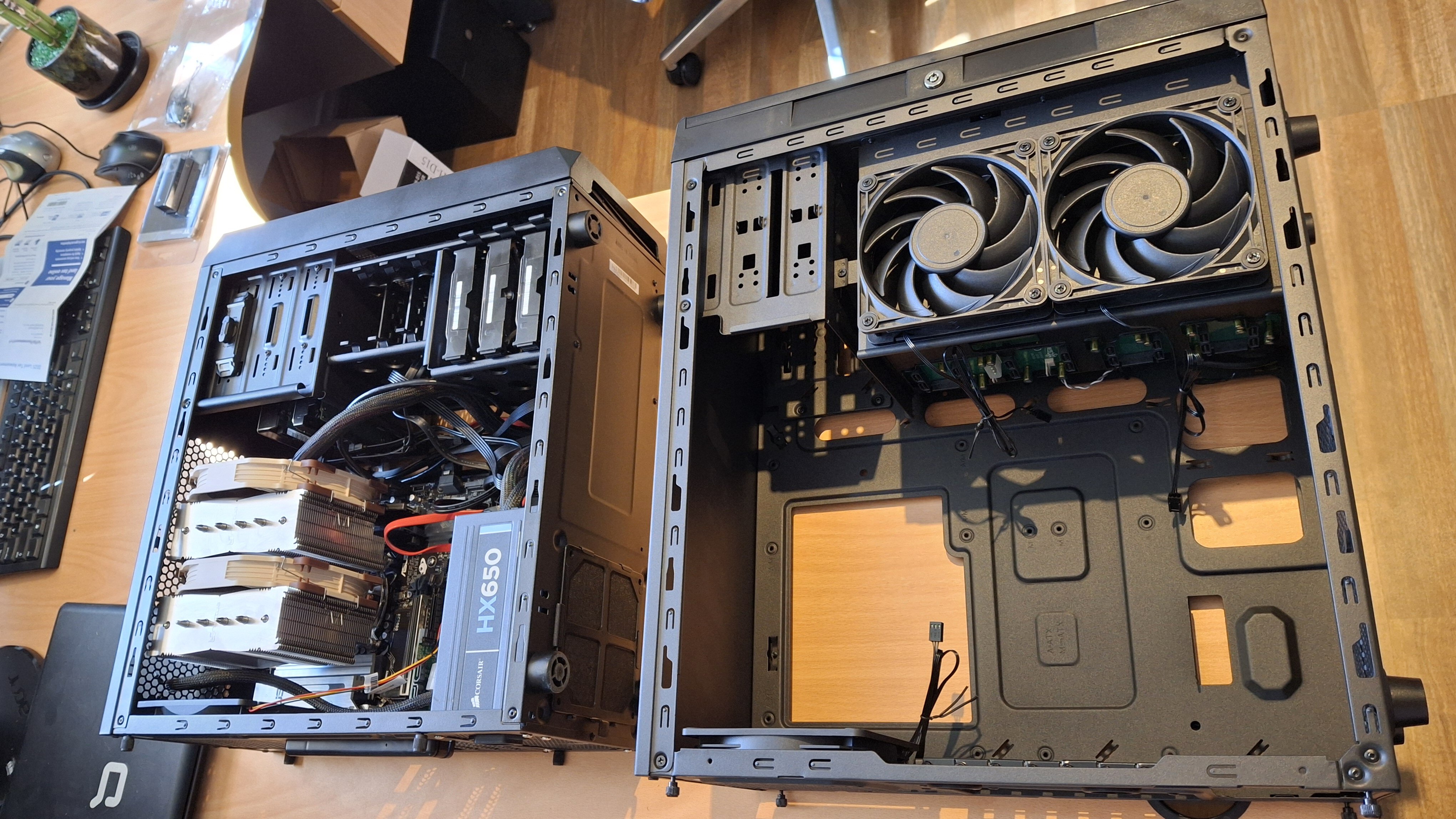

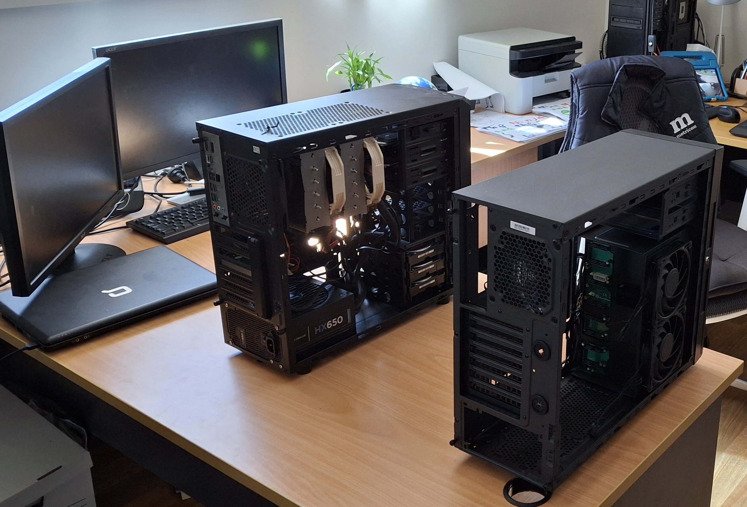

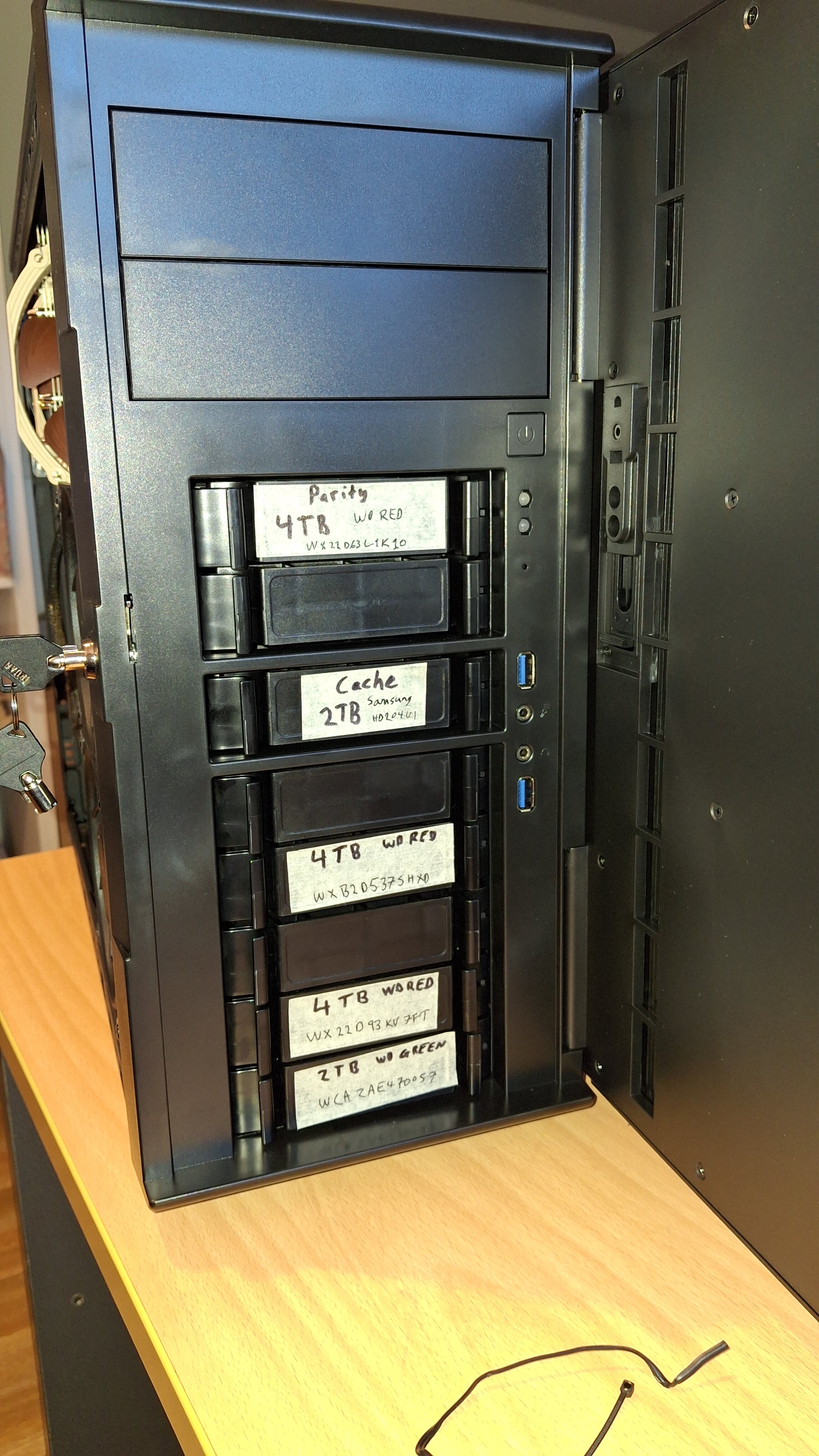

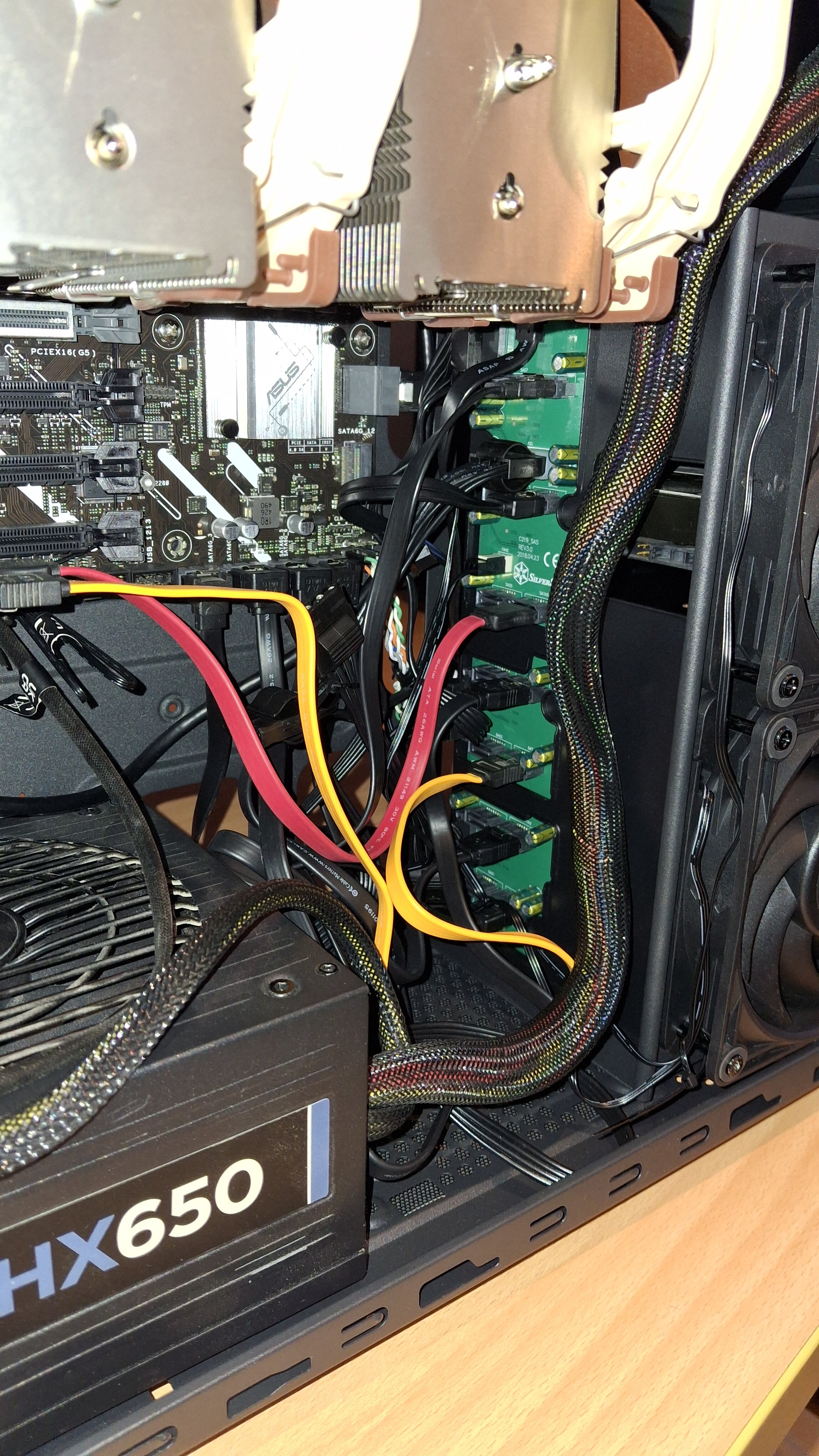

I finally found some time to change over from the old case
Silverstone CS380 , was a little tight with the D15 cpu fan, but the MB had enough space to use the 2x sata facing the hdd enclosure section, with the other 4x sata all in the drives i am using. the crest pcie sata ill change to a HBA if i need more drives, for now i just left it plugged in to the spare hdd slots.
i just bought an Asus TUF GeForce RTX 5070 Ti 16GB GDDR7 OC Edition Graphics Card & Asus Prime 850W 80+ Gold PCIe Gen 5.0 ATX Fully Modular Power Supply, but the GPU doesnt fit in the CS380 case due to the hot swappable bays :(
I think when i was originally thinking of adding the gpu i had a rtc 3060 in mind, but then allowed a higher budget for more future proofing.
What are the recommended options for an external GPU holder/stand and extension cable to connect the gpu to my server which, can be next to it as long as its connected and safely seated. I keep the case open and on the floor in its secure location.
ill try a pcie 5 extension cable and vertical gpu bracket sitting next to the server.

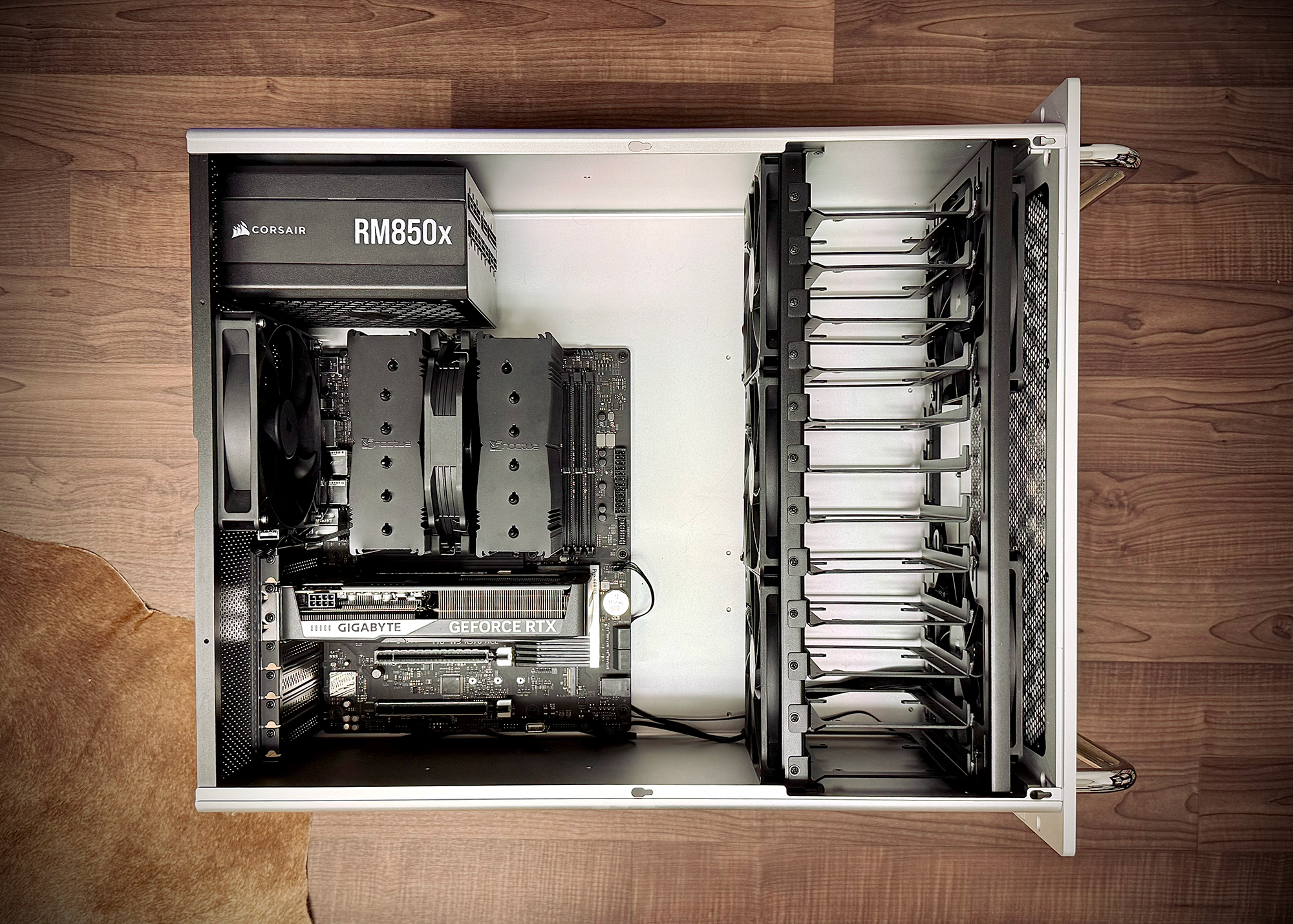

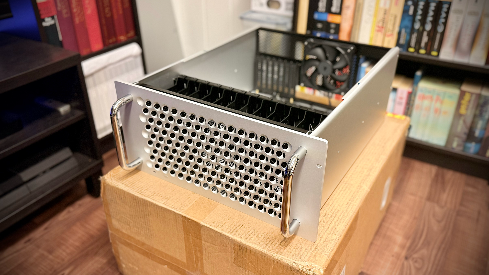

I was lucky enough to get one of the last Apollo R v2 Cases from MCPRUE.
Unfortunately, they are no longer being manufactured... It's a shame, as they were really beautiful made from quality materials.

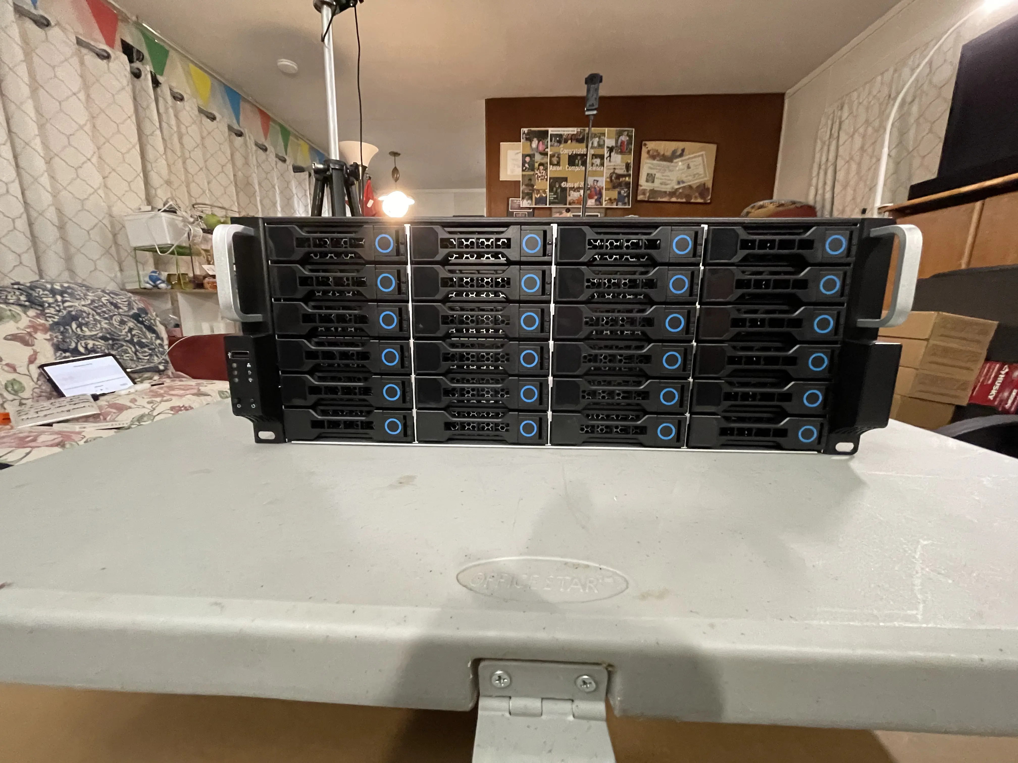

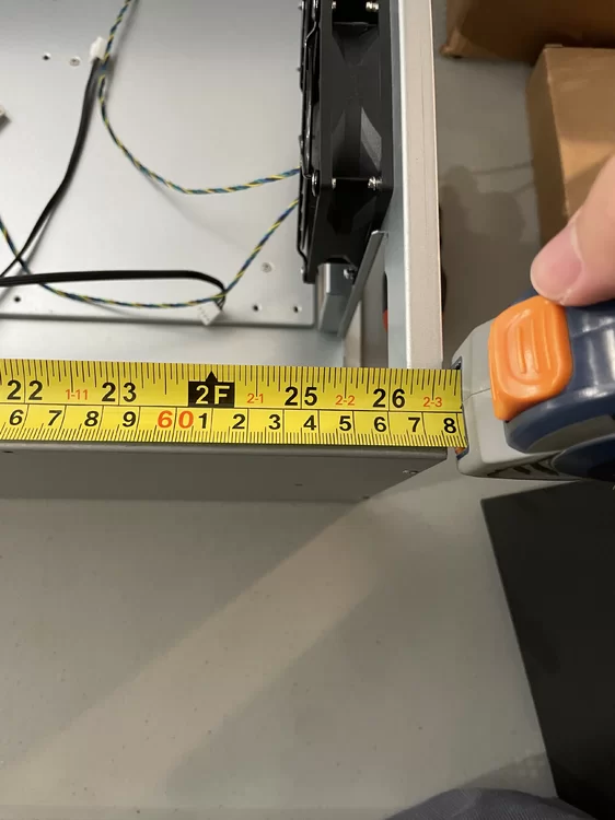

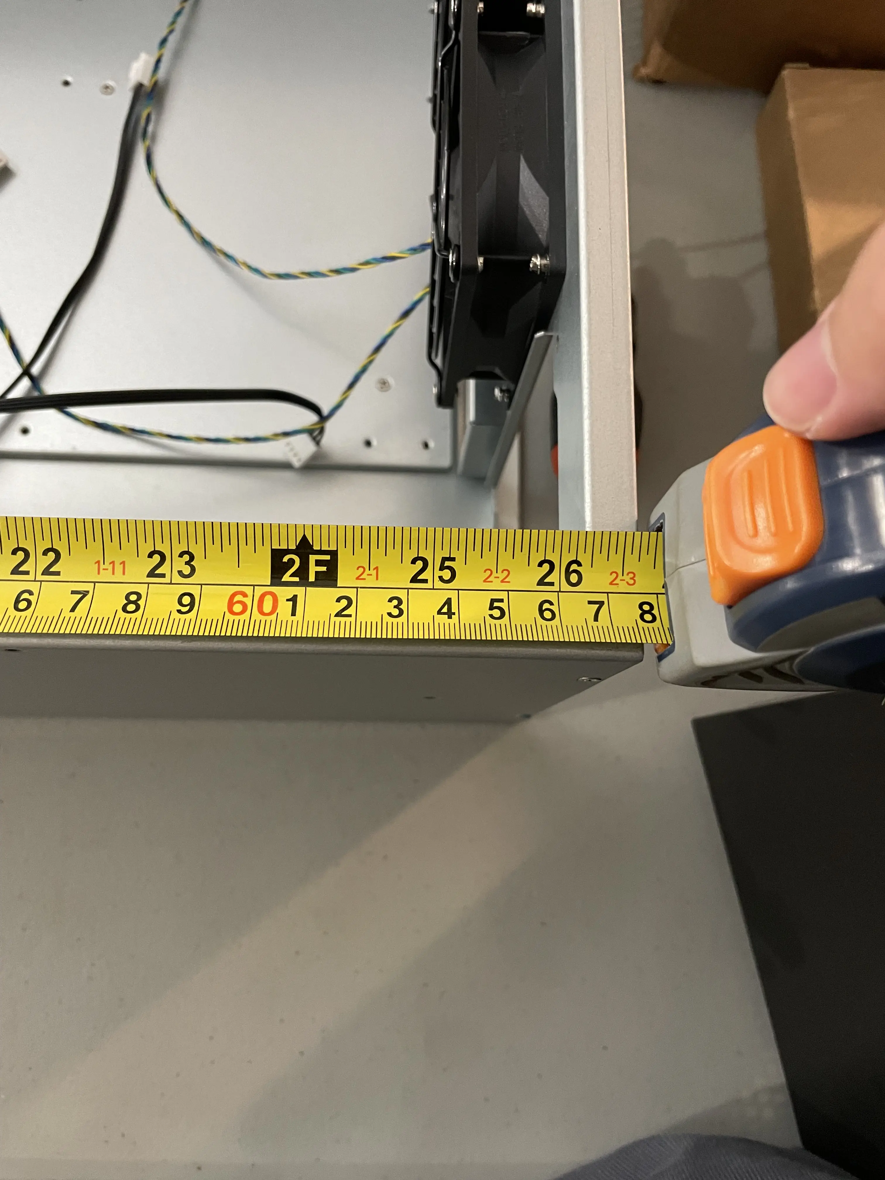

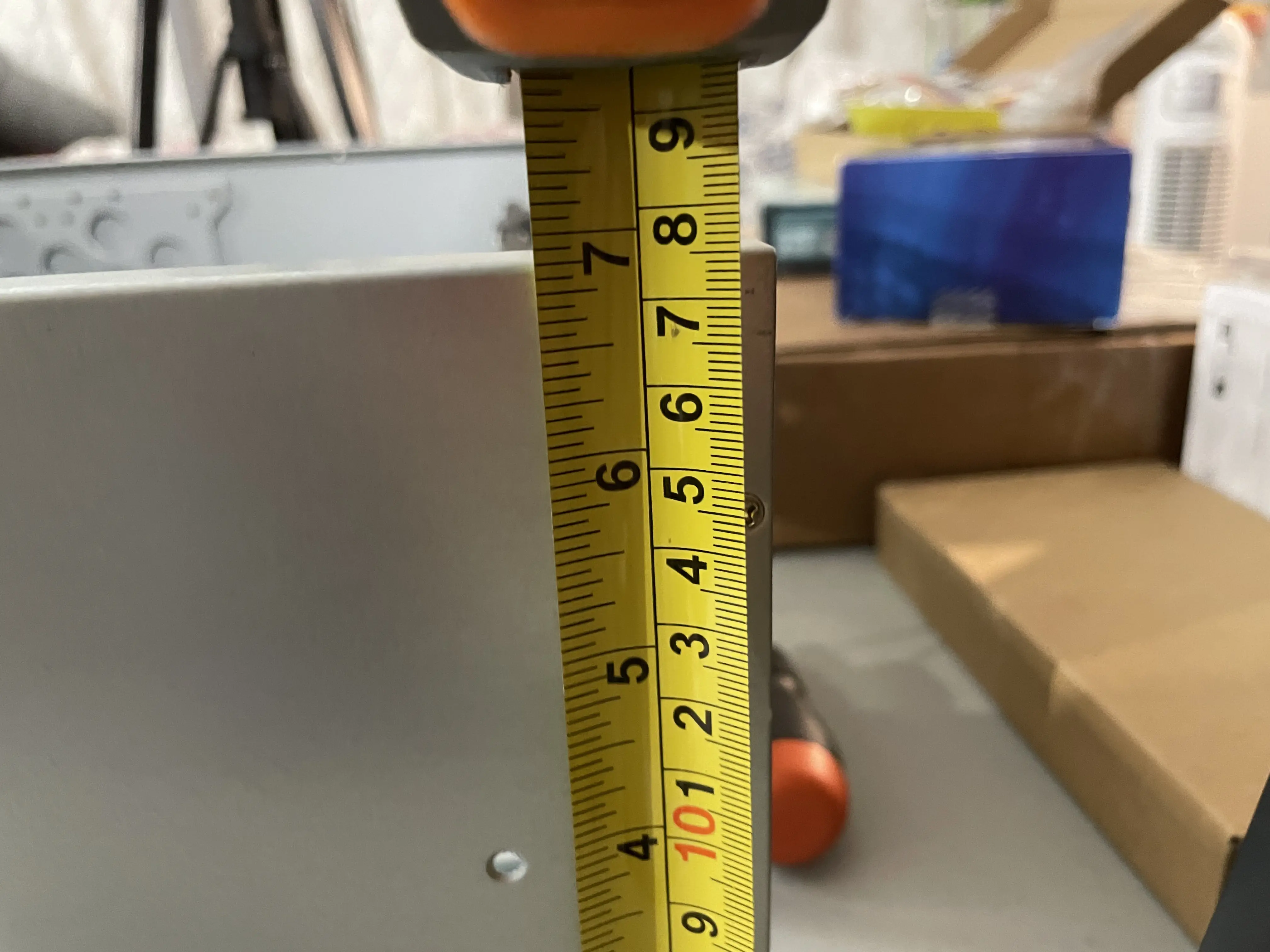

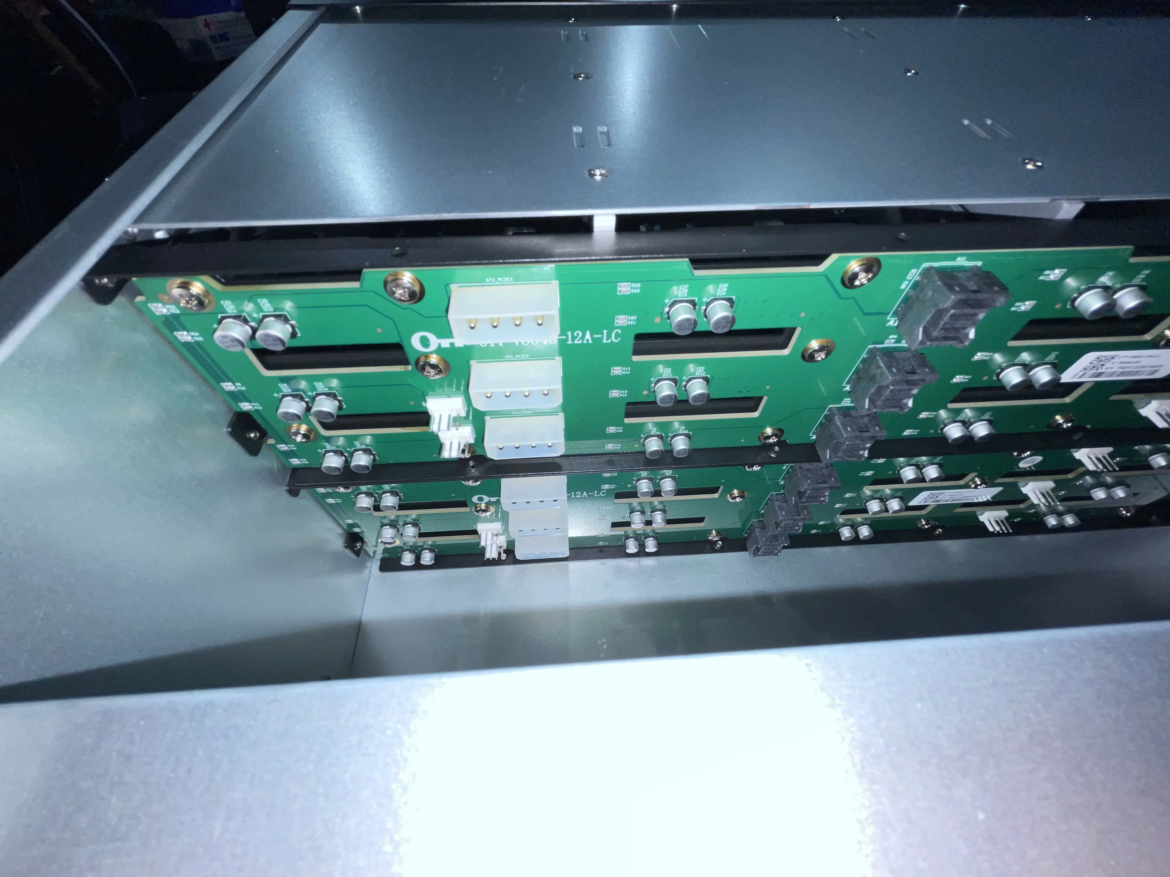

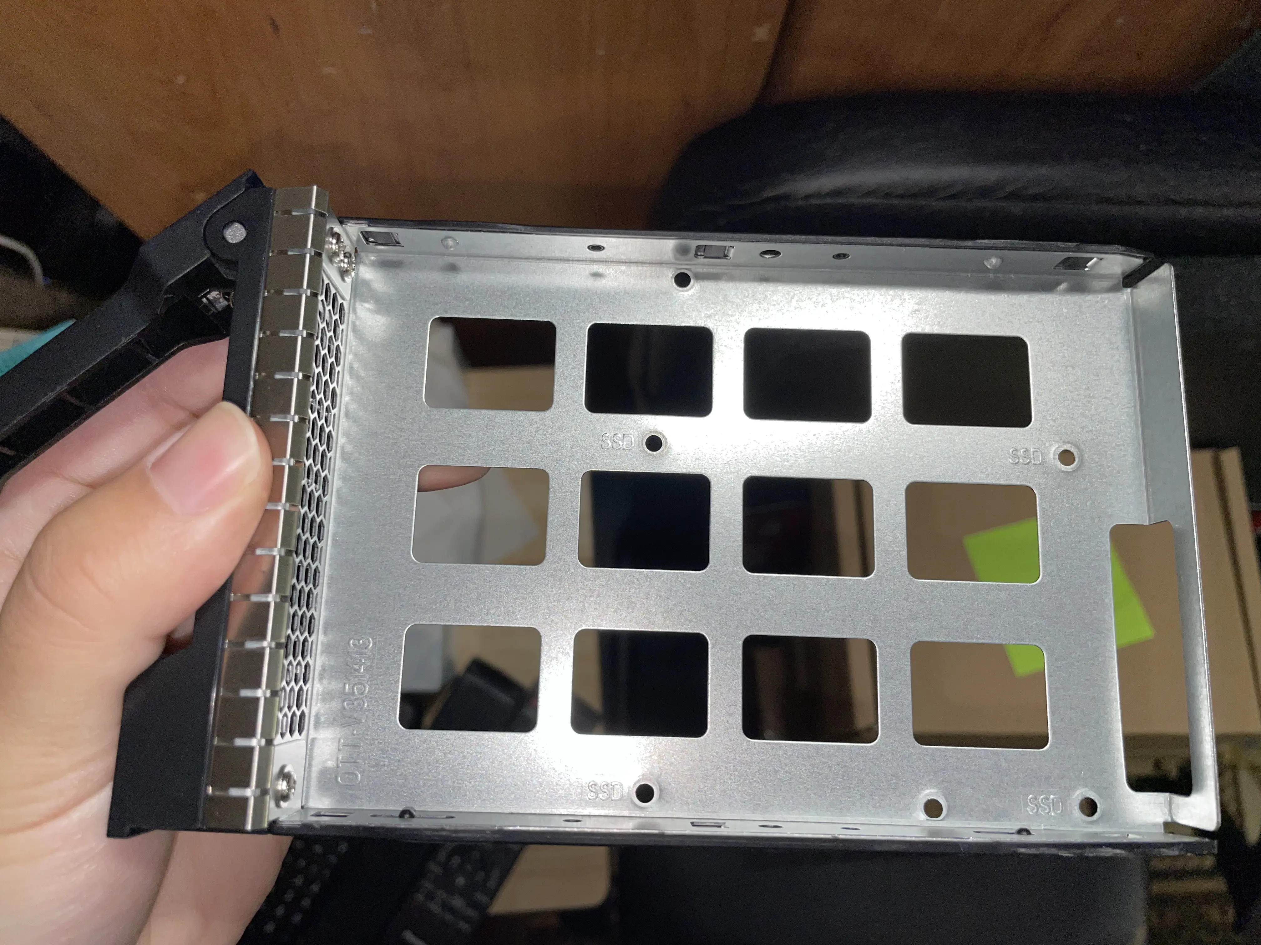

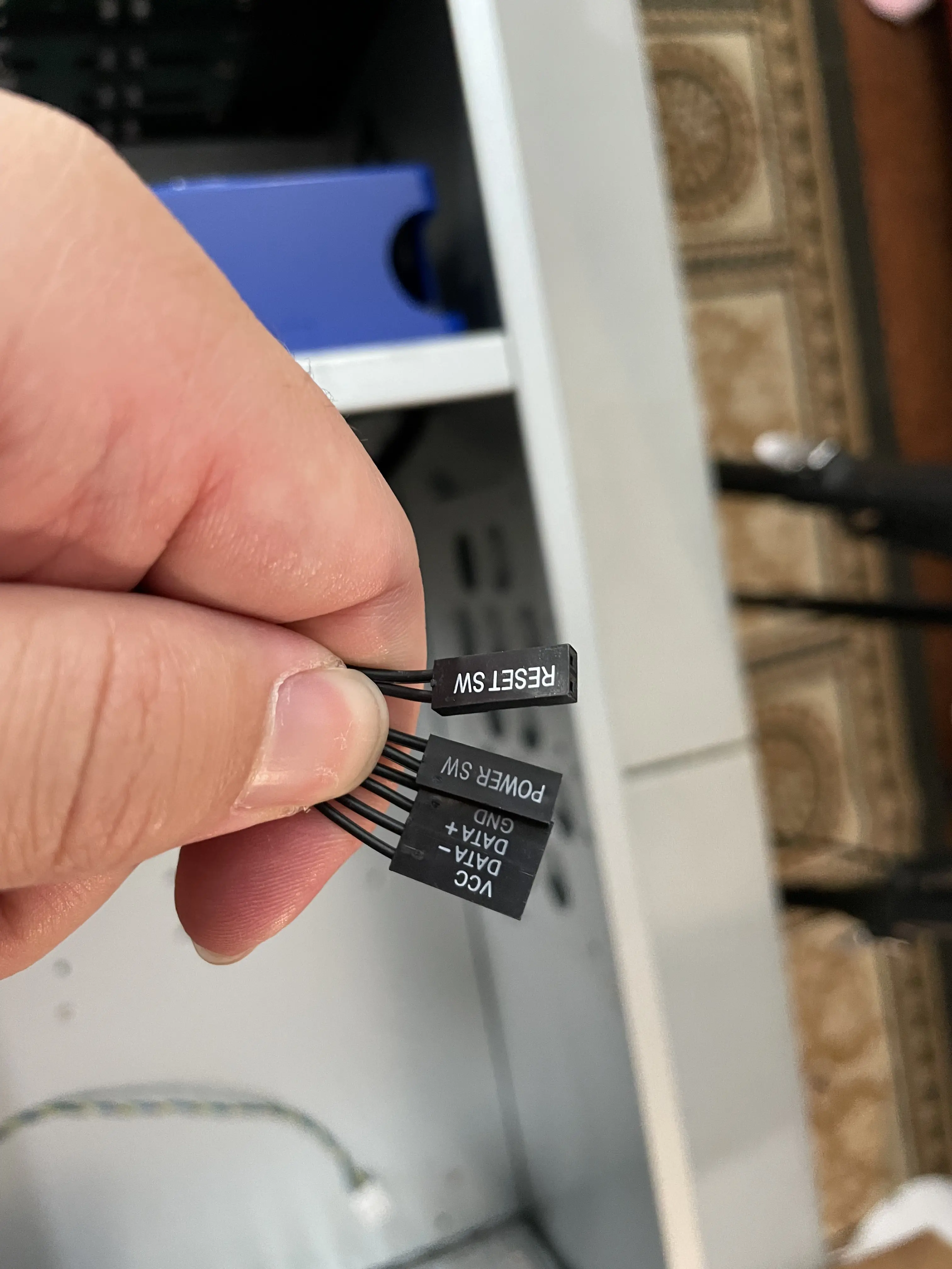

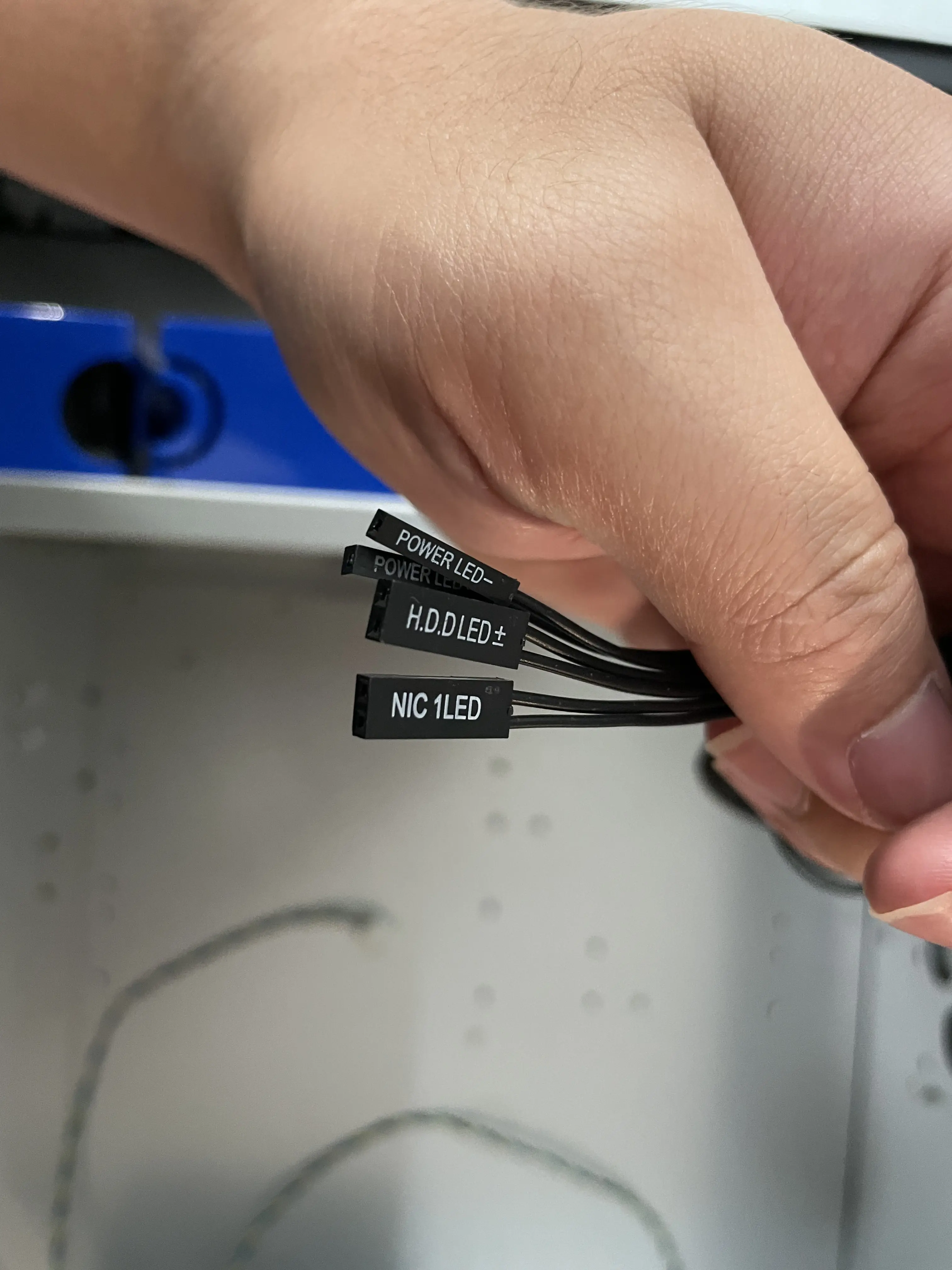

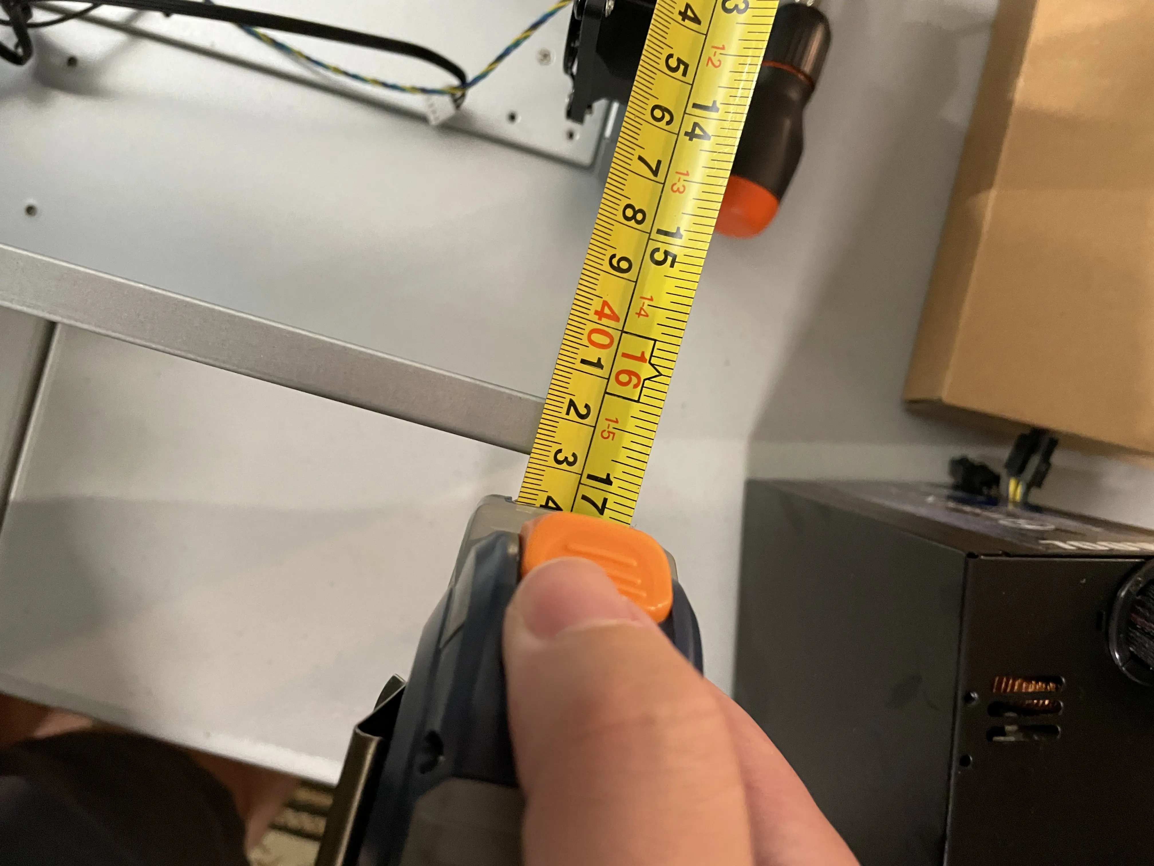

https://a.co/d/9hRZ5GJ
https://www.amazon.com/dp/B0D4ZJM1GM?ref_=ppx_hzsearch_conn_dt_b_fed_asin_title_5
Generic ZhenLoong LF24-12G 4U 24 Bay Server Chassis Hard Drive Disk hot swappable SATA SAS Rackmount Case with 12G backplane SFF8643 Interface,USB 2.0.sea Shipping and Express delivery About 40 Days

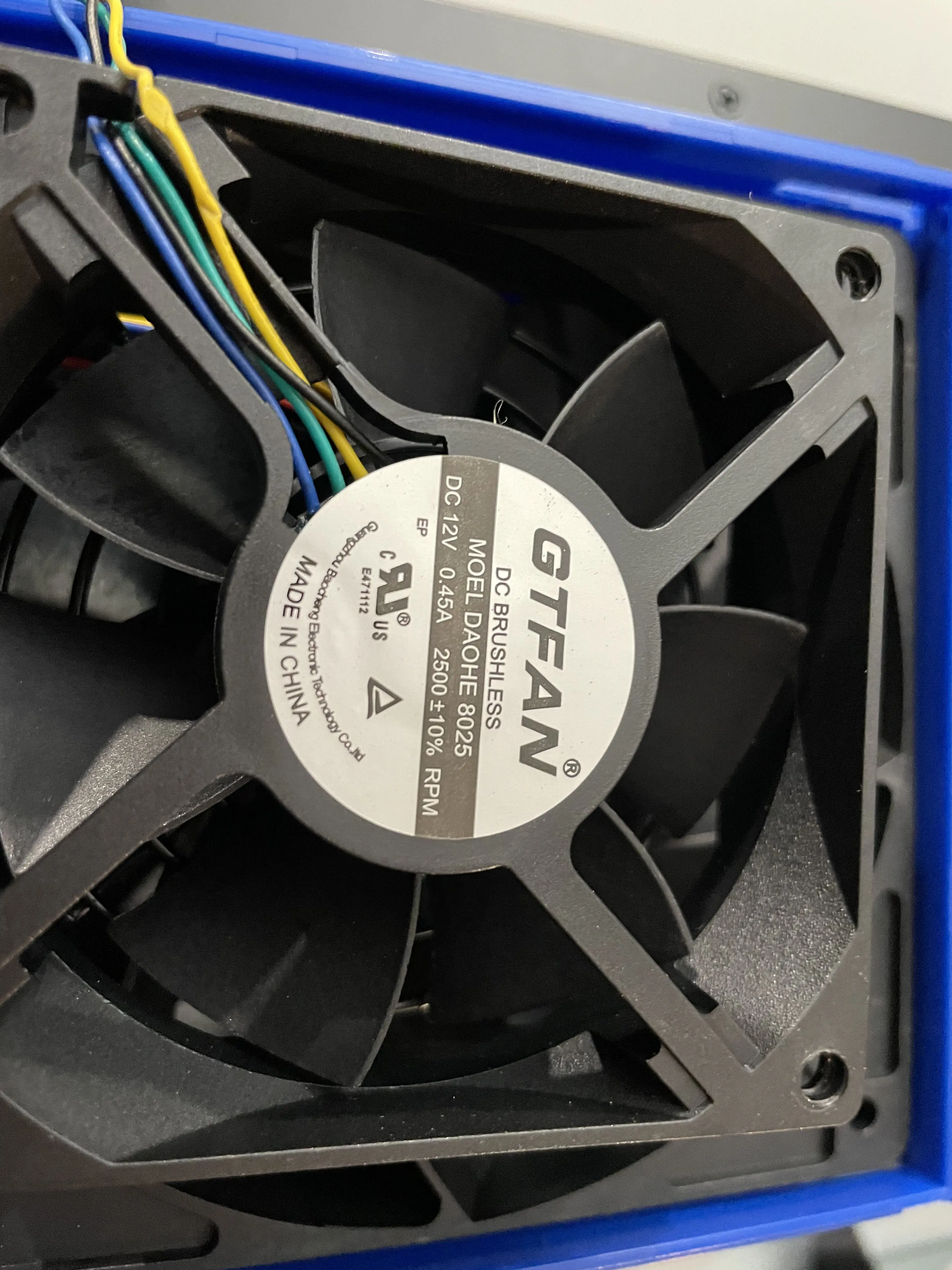

Above is a case I have recently bought and have been talk with the manufacturer about improving on.
It has 24x 3.5 bays and so far has been really easy to build in. It has support ATX motherboards and an ATX power supply, but I would advise not using the fans.
The server fans it came with are for server motherboards, so it killed the fan headers on my test motherboard and a fan controller I was using. They are also loud like server fans, so I would just advise replacing them either way.
I will be replacing the fans with these ARTIC packs
https://a.co/d/gaxOWJ2
https://www.amazon.com/dp/B0D5B2CT2M?ref=ppx_yo2ov_dt_b_fed_asin_title&th=1
ARCTIC S12038-8K (3 Pack)
https://a.co/d/izEAO3t
https://www.amazon.com/dp/B09VGW7L6Y?ref=ppx_yo2ov_dt_b_fed_asin_title
ARCTIC S8038-10K - Server Fan, 80x80x38 mm, 500–10000 RPM, PWM Regulated, 4-pin Connector, 12 V DC, Rack Cooling Fan - Black
I want to get an accelerometer to make sure that the case is under 0.2 G in force when fully filled and fired up.
I will update this post if I get around to that.
This case was a goldilocks case for me, and so far has been perfect.
And the manufacturer has been very communicative on suggestion on improving the case design and support with components.
Turn around from them has been about a month long each time since they are from China and I am from California, but for the price the case is, and the free steel parts they have shipped me, one month turn around is more than acceptable.
I want this manufacture's business to succeed, so I am sharing it here in case it might fit other's use cases as well.
Edited by Gray J
Adding photos
