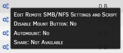

Here is the issue:
Apr 18 16:54:49 unRAID unassigned.devices: Mounting Remote Share '//UNRAID/mnt/user/'...
Apr 18 16:54:49 unRAID unassigned.devices: Mount ROOT command: /sbin/mount -o rw --bind '/mnt/user/' '/mnt/rootshare/user-pool.rootshare'
Apr 18 16:54:49 unRAID unassigned.devices: Successfully mounted '/mnt/user/' on '/mnt/rootshare/user-pool.rootshare'.
Apr 18 16:54:49 unRAID unassigned.devices: Warning: Unassigned Devices are not set to be shared with SMB.
Doesn't this show in the device Tool Tip?
Share not available.  Doesn't show 'Share: Yes".
And this when you go the device settings?

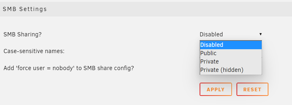

I don't know what else I can do to tell a user to go to the UD Settings and set "Enable SMB Security" to something other that "No'.  No means don't share any UD devices using SMB.
Why has this changed you might ask?  Because of security reasons, SMB is not enabled by default anymore.  It used to be that "No" meant share all UD devices Public.  That's a really bad idea to default to Public sharing.

A small point of semantics, but I would remove the word ‘Enable’ from the setting description as to me that combined with the ‘No’ setting implies no security is applied which is not the case.
Good idea.  Maybe this works better:
Definitely an improvement :)

18 hours ago, itimpi said:
Have you checked under Settings->Unassigned Devices that the SMB Security is not set to No (the default nowadays) as that will stop all UD managed devices being visible via SMB regardless of the settings on a particular device.
That was it.  Thanks a ton.
