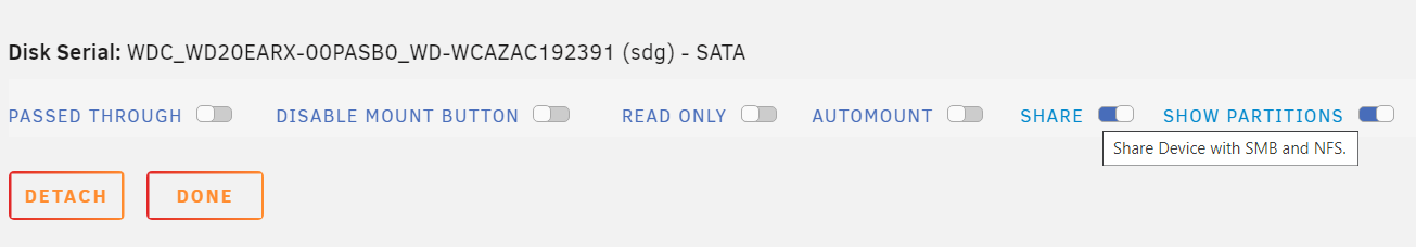

  • Major new release of UD: "Where are the switches?"  The "Pass Through", "Read Only", "Automount", and "Share" switches have been moved to a new Edit Settings dialog.  This is also where the sc

  • Added a 'Read Only' switch to remote shares so they can be mounted read only.

May  2 10:47:21 Weechflix unassigned.devices: Device '//JESTER/Music' is not set to be shared.
Set the device share switch:
27 minutes ago, dlandon said:
May  2 10:47:21 Weechflix unassigned.devices: Successfully mounted '//JESTER/Music' on '/mnt/remotes/JESTER_Music'.
I turned on sharing on all 4 mounts and they are now showing up in my Windows explorer. I've never had to set those before, are these settings being reset when I update the plugin?
What probably happened was the 'Share' default was changed to not share for security reasons.  If you've never changed the 'Share' switch, it would still be at the default.
