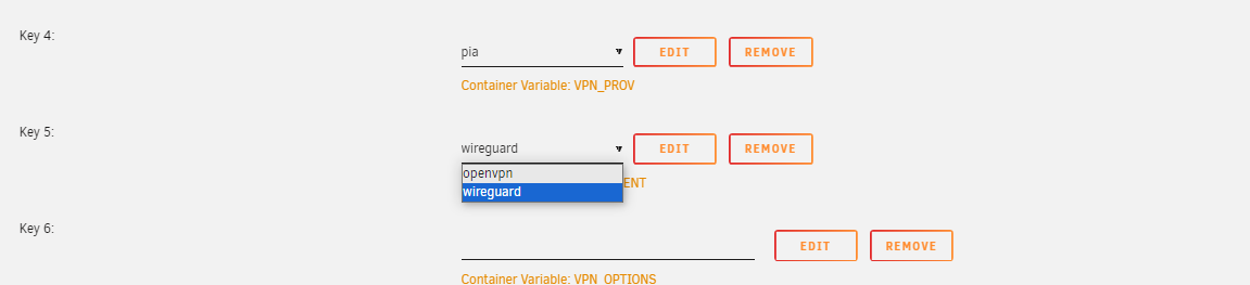

[Support] binhex - qBittorrentVPN
Thanks @binhex ... followed your advice on GitHub and switched to Wireguard ... the container is now working for me. Not entirely sure what the impact of this will be but it connects and works!

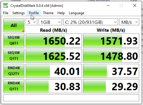

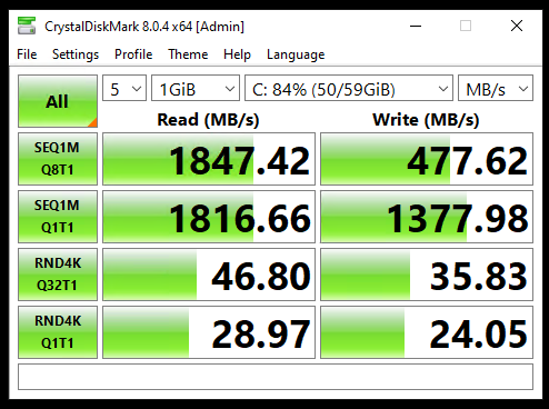

any now with the NVME drive passed though to the VM using /dev/disk/by-id/ ... interesting as I was expecting quicker ... now to see if I can pass the drive through as directly but I'm not sure its possible as its on a Z97 mobo and connected to the PCI bus with a cheap M.2 adapter card
Windows VM drive setup (2023)
Just taking you along with me if your interested and reading this a some point in the future. I've updated to 6.12 and taken the opportunity to reformat my 2 disk SSD (WD blue 500gb) from BTFS to ZFS encrypted mirror and have had some good results. No other changes to VM Setup

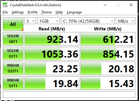

Hi All, Been loving Unraid for a few years now, lots of happy dockers and a few VMs for fun. I do have a Windows 10 VM which I use as a daily driver for email, web and general stuff. Its great but I wonder if I can get is a little more snappy .... I have a couple of WD Blue SSD's setup as a BTRFS Pool where the dockers reside, along with my other VMs and Win10 60gb windows vdisk. My question is, is this the best way? Crystal Disk figures and not the best, I am thinking is this the issue? Don't get me wrong, it's working okay, and I know it's not going to be like my standalone gaming PC but what do you think? (I have space for additional drives including nvme, pci slot) System Spec is i7-4790k on a ASRock Z97 mobo with 32gb of DDR3 Ram. Windows is lucky enough to have 8gb RAM allocated to it and 4 threads. (62% system ram utilized on 'day-to-day' use - built from lots of old/little bits 4 HDD for General Storage, VM for CCTV with HHD passed through) Thanks for any feedback Andy
