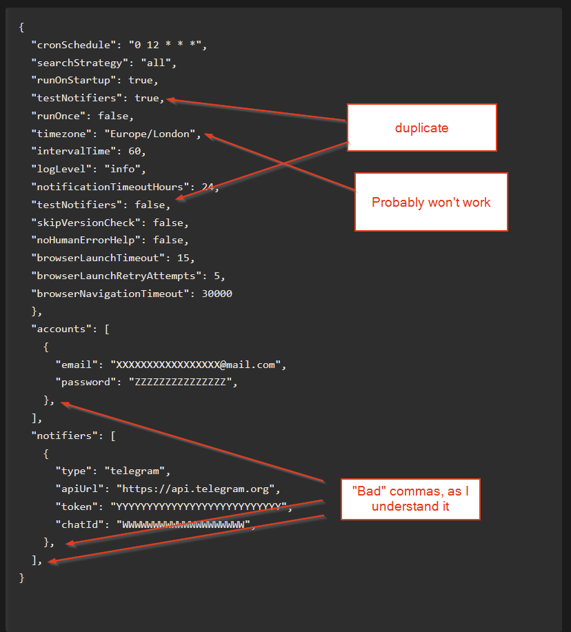

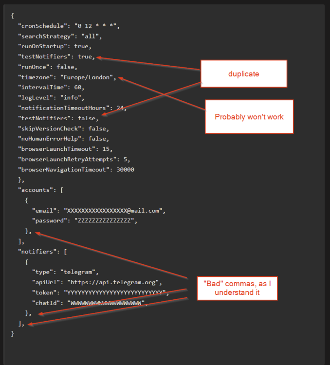

  9. Just added my comment to this thread and saw your post. Actually, the Timezone isn't working (at least not for me), as this is set not on the config side, but (at least in our case) at the moment, when the docker is created (you can check my previdous message). Hi I actually just read your error messages, and the problem in your settings files are probably the commas "JSON5: invalid character ','" If you check how json files are created, you are not allowed to use commas at the last entry. Sorry I am also a noob and can't explain it any better - just found this out yesterday. Here is an example from your code, what I think is wrong: Edit: timezone attribute will work. Have written it wrong in my setup, as I was thinking, it will also be written in camel case timeZone - it is not. Here is a config file example, which is working for me: { "searchStrategy": "promotion", "runOnStartup": true, "cronSchedule": "0 9,12,15,18,21 * * *", "logLevel": "info", "hcaptchaAccessibilityUrl": "XXXXXX", "webPortalConfig": { "baseUrl": "https://XXXXX.XXXXXXX.com" }, "accounts": [ { "email": "[email protected]", "password": "XXXXXXXXX" } ], "notifiers": [ { "type": "email", "smtpHost": "mail.XXXXX.XXX", "smtpPort": XXX, "emailSenderAddress": "[email protected]", "emailSenderName": "Epic Games Captchas", "emailRecipientAddress": "[email protected]", "secure": false, "auth": { "user": "[email protected]", "pass": "XXXXXX" } }, { "type": "telegram", "token": "XXX:XXXXXXX", "chatId": "-XXXXXX" } ] } In my case I've set it so up, that it is checking for free games during the day a few times, then notifies me on E-Mail and Telegram for captcha to be solved. I'm using a webportal config, as I am accessing those captchas from internet - so I can add games whereever I currently am. I don't think that you need the "hcaptchaAccessibilityUrl" - this was added at the first stages of the docker, where it was possible to add games fully automatically without captchas. P.S. make sure, you are writing it correctly. The amount of spaces before your entries matters a lot. There are probably some online tools to check if your json format is written correctly. Hope it helps, Cheers
