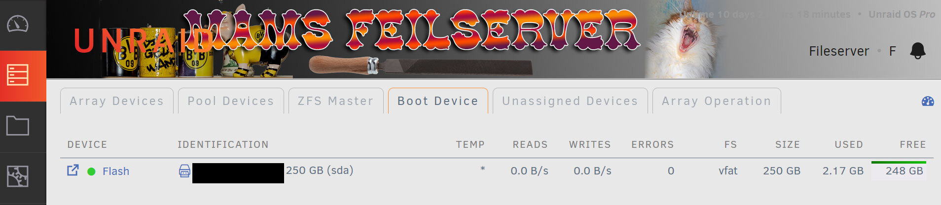

USB boot devices in 2025/UnRaid 7.x
there is no need for <32G anymore. The restriction went away some Windows Versions earlier already. Now you can create an (ex)FAT Partition with more then 32Gb and modern PCs can boot from it (keep your BIOS recent!) But one thing from the old video still is important: put the stick into an USB2.0 port even if it is a 3.x one! This will slow it down and cool it down too. It will last much longer in 24/7 operations Boot speed will be faster slightly in 3.0 port, but you will regret it if the stick wears out quite fast. Boot Time is not really important, after the boot UNRAID runs from RAM, with full speed.
