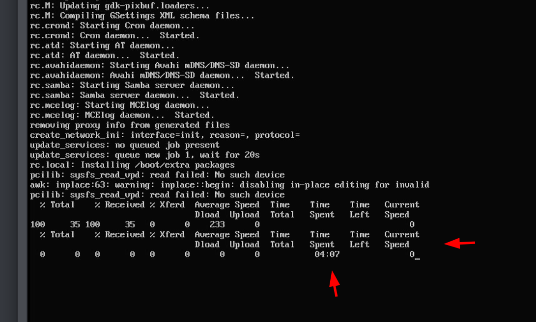

  7. ok, figured it, its been the rclone plugin which never loaded "whyever" removing the plg i can startup normally now @limetech this is more or less some serious fail in design, either set a timeout or install in background, this cant be serious a plugin "download" will fail to start the server completely ...
  8. here the attached diags, i managed to start it in safe mode at least. i almost assume somehow i915 related ... i see a fail here alsserver-safemode-diagnostics-20260707-2023.zip
  9. Hi, seems after a power issue here my 1 Server is not starting anymore (properly) i can boot, but it will stall here, counter is going up, but thats it i can ssh into the mashine, but no service is started like nginx, no mounts, no nothing last entrys in syslog (see attached), copied from terminal now syslog.txt
