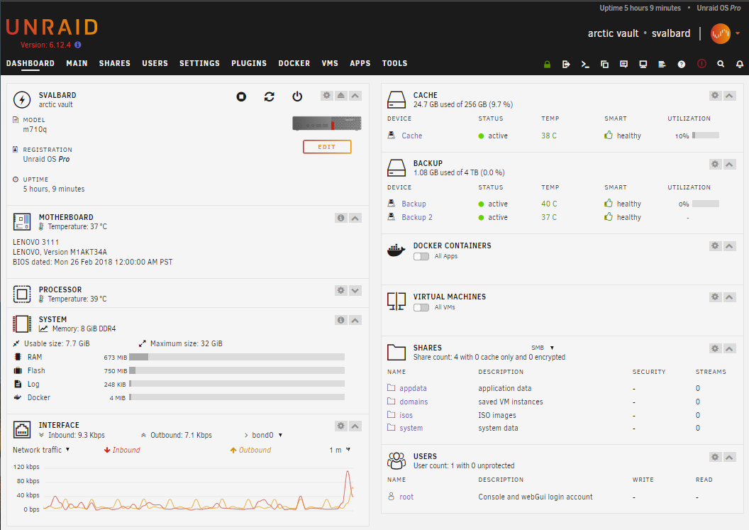

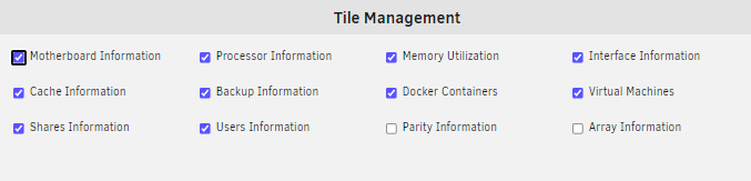

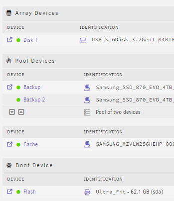

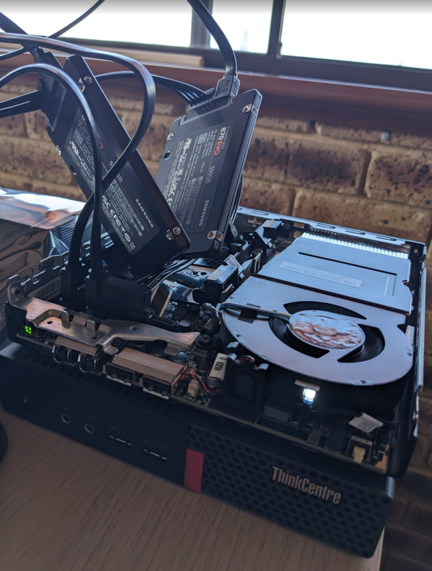

I don't mind being challenged on the setup, this was all whipped together over a few days, even though I wanted to do it for ages The M.2 is a 250GB NVME that came with the unit from auction, its a freebie I wouldn't of bought for this but it'll get used for appdata etc for convenience + separation of roles, the pool name "cache" is the default first pool name and I've haven't sought fit to change it yet. I was able to setup what I wanted out of Unraid in about 5min, but I'm not afraid to nuke and pave this to get the format right. The targets for this server will be backups of vms, appdata, user docs, photos, music etc... basically all the important non-video media from my main servers. A mirrored 4TB will be plenty for now, and its really just a +1 safeguard given existing data is already mirrored and/or parity protected on other respective servers. Once first backup is done, I'm not expecting the backup deltas to use a lot of bandwidth... and if it does I won't notice anyway. Main array is a spare thumbdrive, next release should remove the requirement for it to exist. In release 6.12 you can customise the visible panels, I've simply hidden the array + parity panels (see below).- M710q Tiny 1L Backup Server

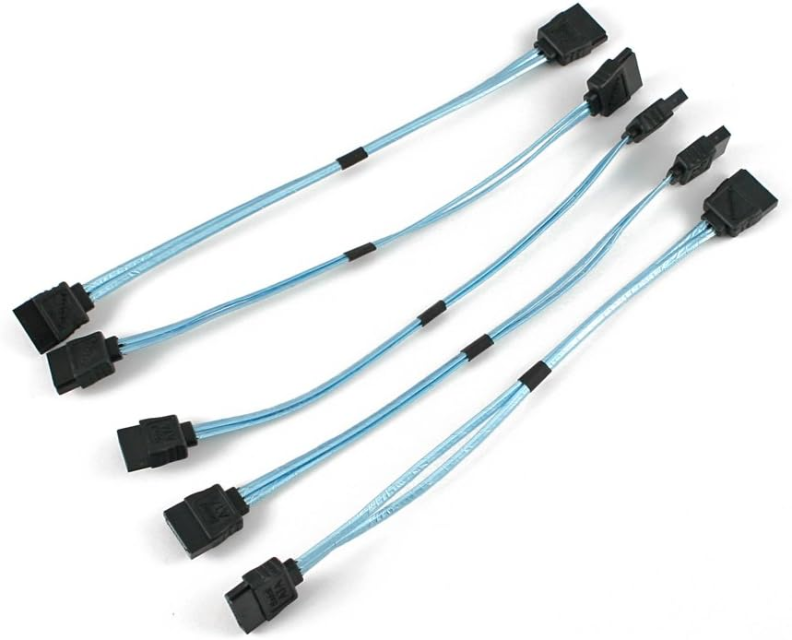

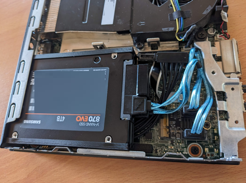

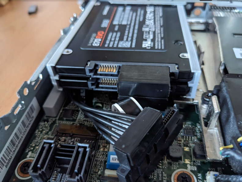

Final ingredient was small + thin sata cables, which came today! Took the time while waiting to reprint drive carrier and riser/spacer in ASA black filament Happily running on 6.12.4 at the moment Looking forward to testing out subvolumes and snapshots plugin as part of this backup server journey- M710q Tiny 1L Backup Server

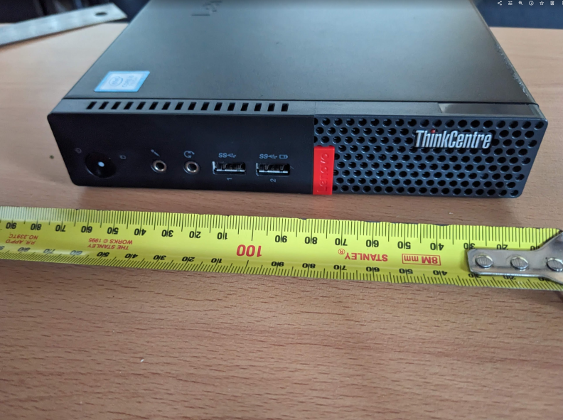

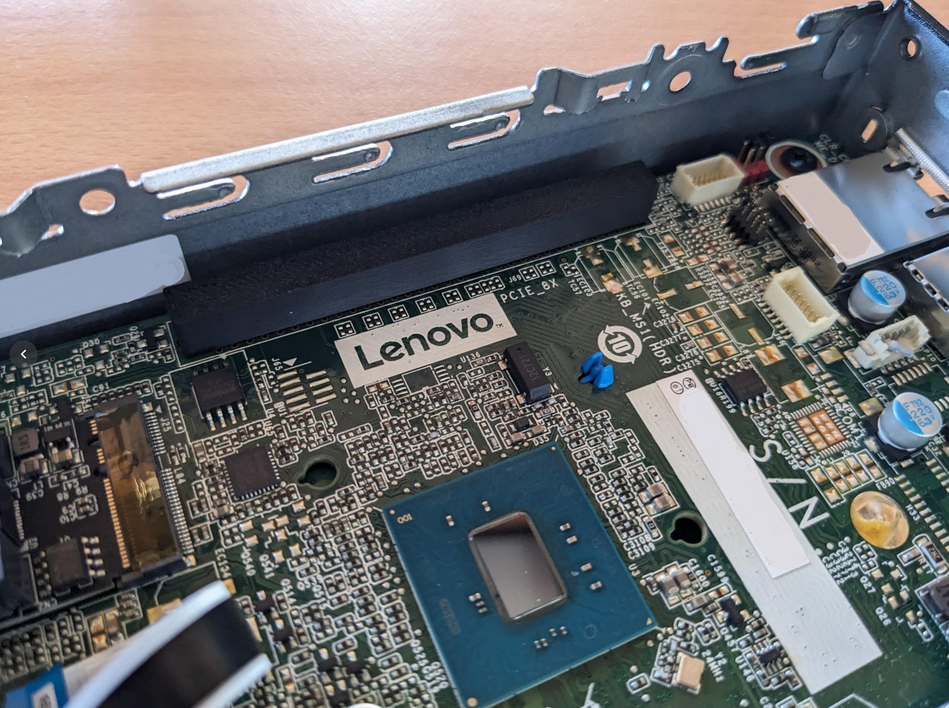

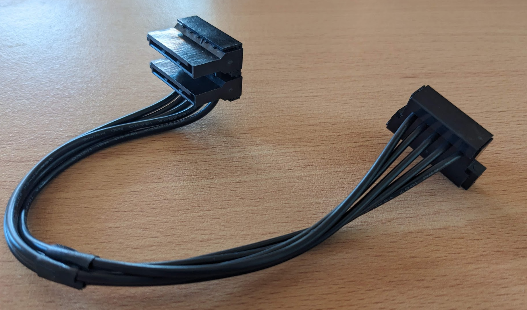

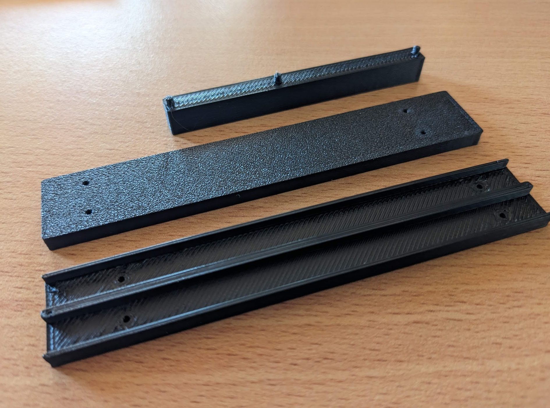

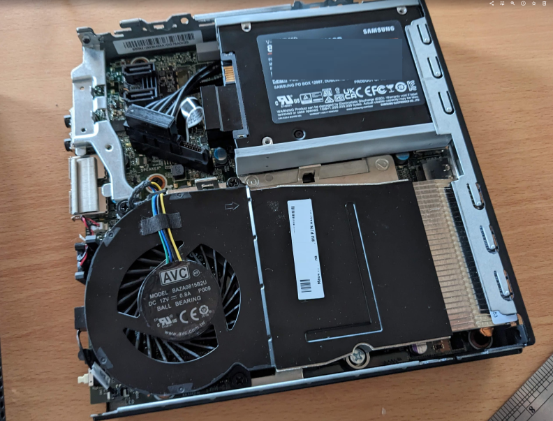

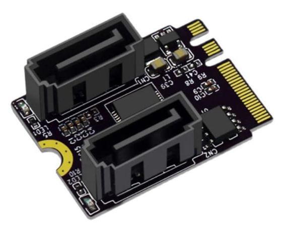

A project server that I've been meaning to do for some time is a small backup server, able to be located seperately from my main rack. I came across the M710q at local auctions and eventually picked one up for under AUD$100. Out of the box it is well specced, with one m.2 slot and one 2.5" drive... but I really wanted 2x 2.5" so I could run a raid1 pool for backups. Enter a slew of additional purchases, modifying a sata splitter, and a couple hours on the 3D printer to prototype a solution:- Dynamix File Manager
