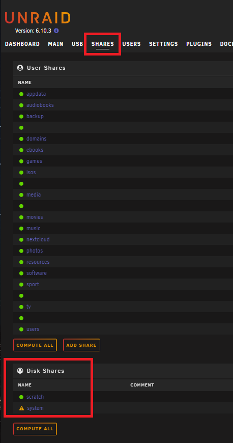

Renaming 'system' share to something else allowed me to create the 'system' pool. From there I could migrate the files in the existing system share to system pool, and delete the original 'system' share. This wasn't really a bug, but just an annoying series of steps and my lack of understanding on collisions this warning was protecting me from. I believe @trurl was spot on with the assessment of it being an SMB export conflict IF the pool was used as a disk share. Thanks. -

When creating a new pool with the name 'system', I get an error telling me I can't name a pool the same a share. This is curious as there doesn't seem to be any possible collisions, you would just get something like /mnt/system/system/ where there is commonality. Strangely, I have created pools in the past that share a shares name, but these were not what appears to be a reserved name. Is this a bug, or just a poorly described error (reserved names?) Secondly, if I remove the existing 'system' share, will I be able to create this named pool ? Or is there some hard coded values that will prevent me from using this naming ?
