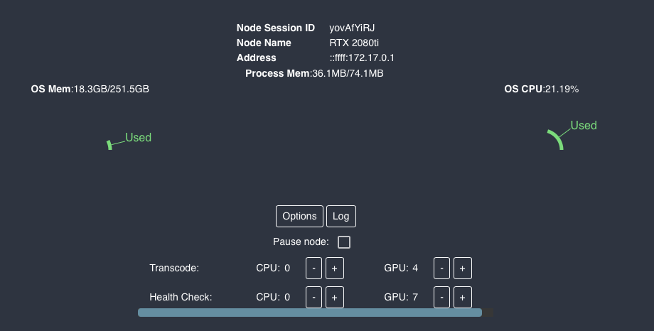

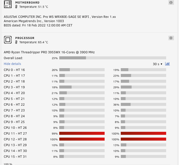

[Support] HaveAGitGat - Tdarr: Audio/Video Library Analytics & Transcode Automation
Tdarr dockers (server) is pulling about 30% from the CPU when having a GPU doing the transcoding. Giving the docker only 4 cores, they are constant 100%. I double checked my setting again @SpaceInvaderOne tutorial several times. Is this as expected? Happy for any comments.
