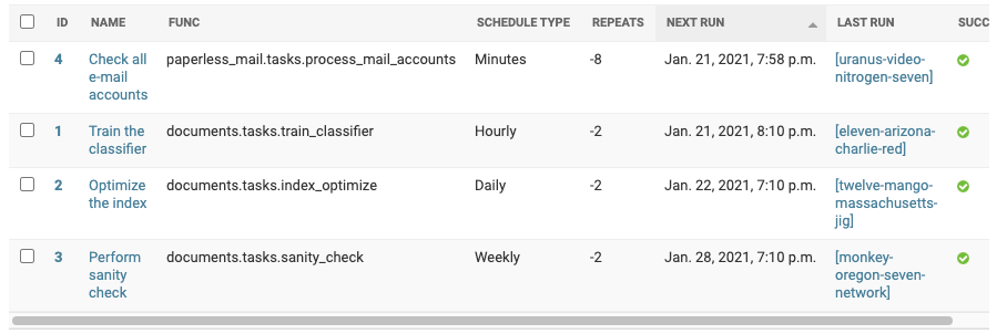

As for the names, I am not sure, all the completed task show a similar name formula instead of a date/time:

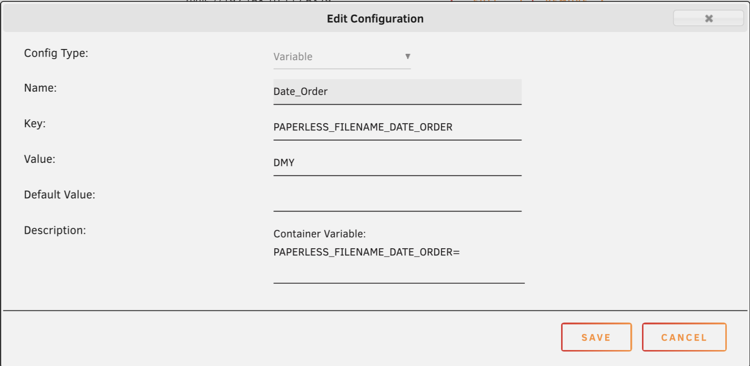

Two questions:
1) How does file name handling work via unraid config? Is this something i do via the command line or gui? I can't feally find the instructions in the docs, only an explanation on how the principle works.

Yes you are completely correct. I hadn't thought to look at the original project. Thanks!

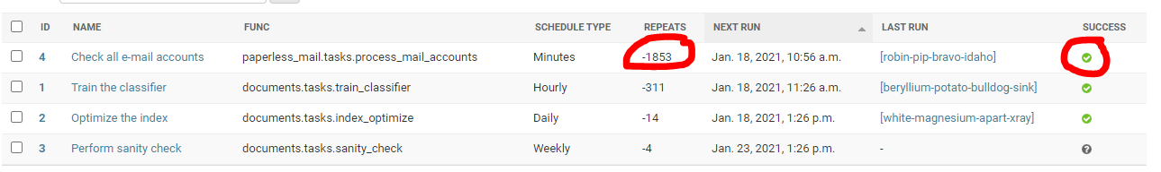

thanks for the container, is working fine for me, but the mailchecker checks and says everything is fine but is not importing any documents. are there any hints what to to?

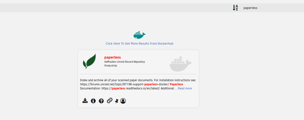

Hi, I want to install paperless-ng but it appears the template is no longer in the CA App store? When I search for paperless I only see the old paperless, and when I search paperless-ng I get nothing. I can see it if I click "get more results from DockerHub" but then the template has no pre-filled variables and paths. Has it been removed for a reason? Or am I doing something wrong?
I have the same issue and I ran into (my own created) trouble and removed the container with the purpose to re-install and now the template is missing.
The online app store lists it as available (https://unraid.net/community/apps?q=paperless#r). I haven't removed it. So, I have to investigate once I'm home.
Update 1: I broke the template with the latest update :( Should have checked before submitting the changes. Will fix it now and try to get the changes to the CA ASAP
Update 2: I submitted the fix for the template. We wait for getting it merged. Sorry for the trouble guys
Update 3: The template is available again
Edited by T0a
5 hours ago, T0a said:
The online app store lists it as available (https://unraid.net/community/apps?q=paperless#r). I haven't removed it.  Have to investigate once I'm home.
Update 2: I submitted the fix for the template. We wait for getting it merged. Sorry for the trouble guys.
Many thanks!
