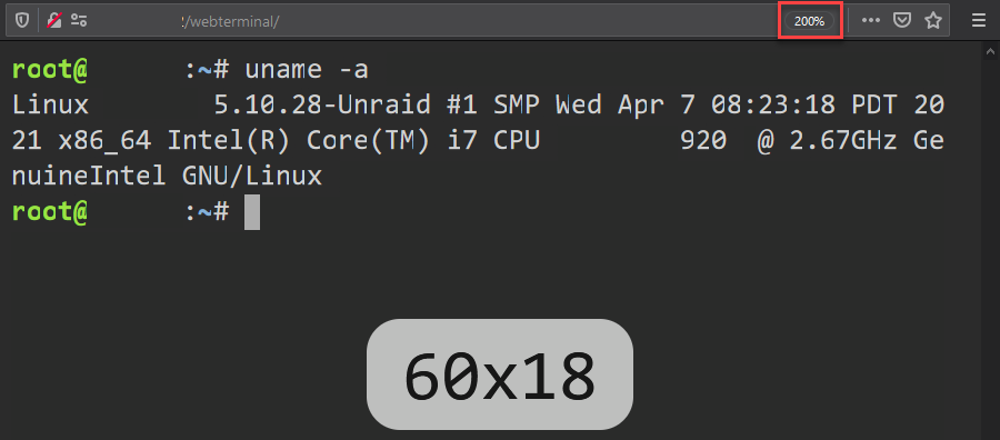

April 15, 20215 yr This is the webterminal in the GUI. The text in the webterminal is difficult to read at default zoom. (my monitor resolution is 1920x1200) Increasing zoom to 200% makes it more readable, at the expense of less displayable text.
April 15, 20215 yr Yes the window can be resized, but the font size and scaling remains the same. Yes you can zoom to 200% and then maximize the window, but it also applies to the main GUI as well as the web terminal. Hopefully I explained well enough. Using an SSH client works fine, but there are times when it is much more convenient to use the web terminal. It used to work fine in the previous version, but since the major update to 6.9 the web terminal hasn't displayed well in certain situations such as mine.

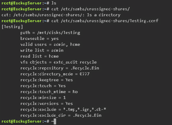

April 23, 20215 yr I'm experiencing the same issue. I have two servers, one on 6.8.3 (no issue) and the other on 6.9.2 (issue). 6.8.3 server 6.9.2 server

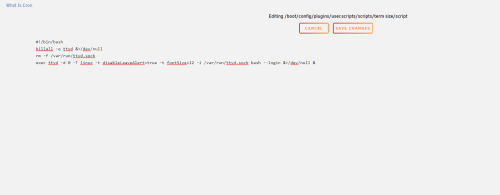

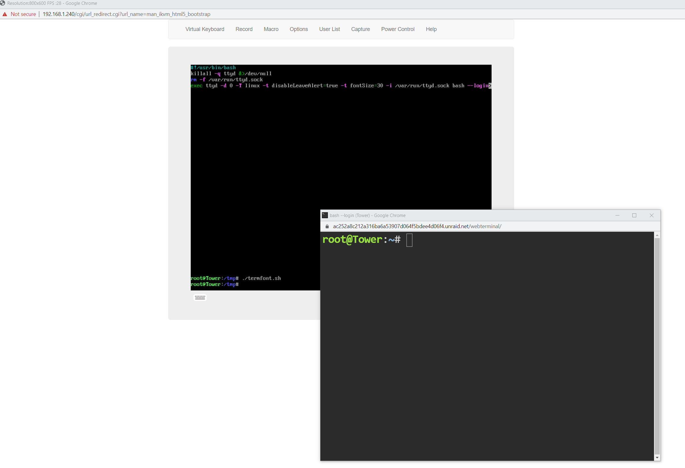

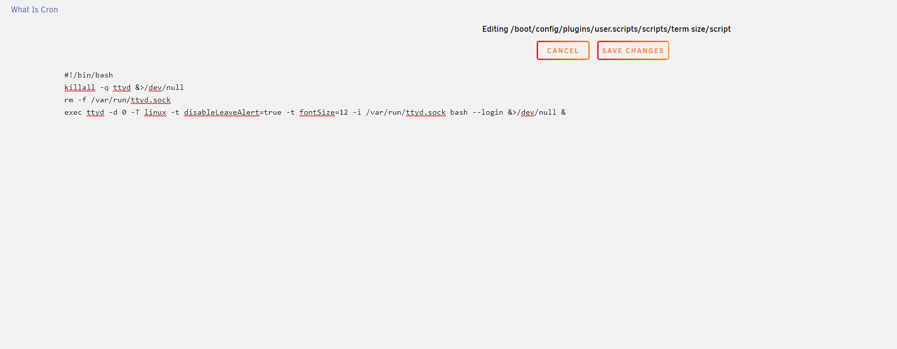

May 1, 20215 yr 15 hours ago, JokesOnYou77 said: @ljm42 My PHP isn't very good, but it doesn't look like there's a place to inject logic for this in the UNRAID webGUI on github. That leaves browser plugins or greasemonkey scripts as the best way to distribute this in an easy to use fashion. If I were to build such a thing, what would be the right forum to announce it in? Nice find. The rc.nginx needs to be updated. or another script to be called on size changed as needs to stop ttyd and reload. Created a little bash script to test. Fontsize=12 looks to be the default. Note that you cannot run from Term as it ends the sessions. #!/usr/bin/bash killall -q ttyd &>/dev/null rm -f /var/run/ttyd.sock exec ttyd -d 0 -T linux -t disableLeaveAlert=true -t fontSize=30 -i /var/run/ttyd.sock bash --login &>/dev/null & Or you can use User Scripts Edited May 1, 20215 yr by SimonF

July 22, 20215 yr Other sites report that the strange font in terminal is due to fingerprint blocking added to a number of browsers recently. Brave browser which I use, has a demo site which you can check your browser against being fingerprinted but it appears that their fingerprint mitigation is causing this. If this is the case, I'd prefer a solution in the server since I don't want to turn this off in my browser. Here are the other discussions people are having and for the record, this definitely happens in brave browser. Discussions here and here. Here's an article describing the fingerprint mitigation added to Brave browser
August 21, 20215 yr I found that if I open the terminal from the HTTPS local IP address the webterminal is perfectly readable. However if I open the terminal from the HTTPS unraid.net address then I'd get that unreadable font. I only find this issue when using Brave browser.
