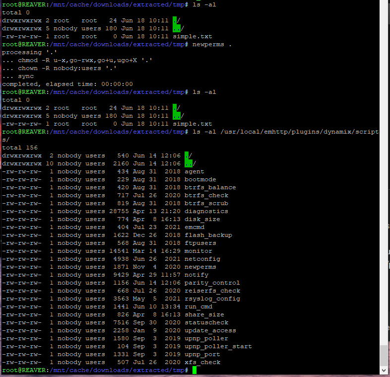

I didn't notice this until today, but has the syntax to "newperms" script changed after  unRaid 6.8.3 ?
I used to always use "newperms ." to change the permissions on the current directory I'm in. Doing so on 6.10.3 results in the permissions of /usr/local/emhttp/plugins/dynamix/scripts/ changing instead. This breaks things.
Edited by BRiT
newperms only operates on user content in /mnt, it doesn't touch internals.
