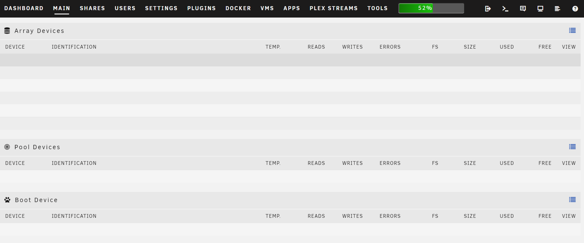

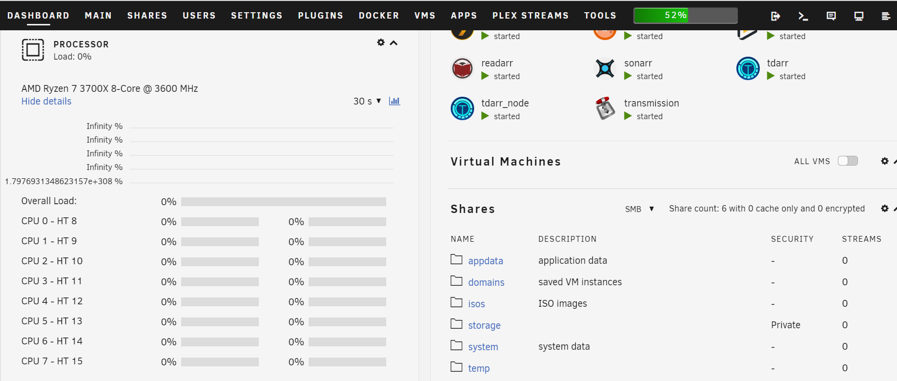

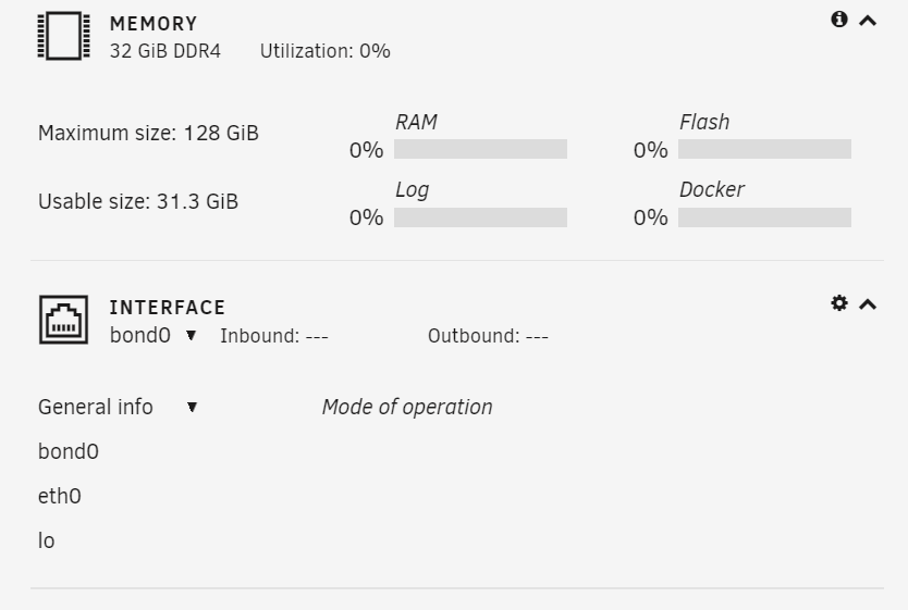

On 6/16/2022 at 2:35 PM, Jamaica1985 said:
Everything works as expected however, both the main page and the dashboard show no hardware information whatsoever. I see no disks, no CPU stats, no Fan stats, no array however everything else is working just fine. Not sure where to start to troubleshoot this...
I have exactly this issue as well.
Tried rebooting several times no different.
Powered down for a hard reset - no different either.
Anybody else suffering from this issue? Any suggestions for resolution?
Thanks
1 hour ago, trurl said:
Thanks for the reply.
It is all on the local network and direct to the Unraid server, so no reverse proxies.
I have also tried the closing of all the browsers and then booting back up - still no joy.
Stumped...
I think I might have to revert back and possibly try the update again.
28 minutes ago, Krushy said:
Stumped
Have you cleared browser cache or tried other browsers?
