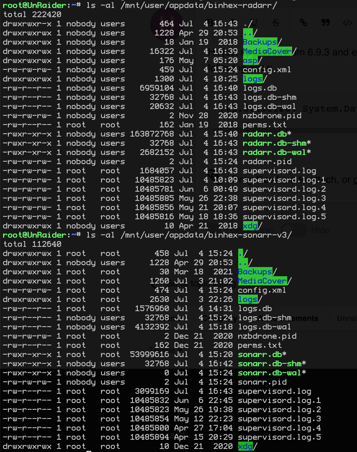

Hi, just upgraded from 6.9.3 and everything seems to be working fine so far except for what seems like a permissions issue with Sonarr.
Whenever I try searching I'm getting the following error:
[v3.0.4.1126] System.Data.SQLite.SQLiteException (0x80004005): attempt to write a readonly database
Looking at the permissions in the appdata folder between Radarr and Sonnar I noticed that Sonarr has more files owned by root/root vs nobody/users (specifically the .db file which I'm assuming is the cause of the error)?
Searching led me to suggestions to use "Docker Safe New Perms" but that doesn’t appear to touch the appdata folder.
Should I just manually chmod the files/folders?
I had permission issues with my dockers after the upgrade and fixed the problems by running the following:
chown -cR nobody:users /mnt/user/appdata/*
chmod -cR ug+rw,ug+X,o-rwx /mnt/user/appdata/*
