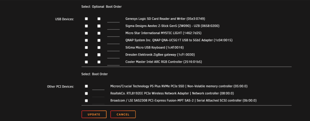

36 minutes ago, craigr said:
Thank you!
So if you were to check your NVMe drive in form view, what line(s) would be added to your XML?  I really don't want to have to parse through all my XML customizations when they get wiped out, and then potentially fiddle with the OVMF BIOS as well :/
The should be nothing different to your current setup. If you specify a boot order for the NVME drive the the boot order='value' will be added to the pci device example below of me adding 3.

9 hours ago, Kilrah said:
The checkbox is for USB only. I have one VM that runs from a passed through USB drive and didn't need any change though.
From NVMe it should run without change since you'll already have boot order right if your VM works.

I had to screw with it a little bit, but it wasn't bad.  I upgraded unRAID successfully and everything is working well (VM's and Dockers).  Remember, I did not have any "boot order" defined in my xml before (it was in the OVMF BIOS setup I think).  If I tried to use boot order before, my VM would not start.  I had to work around this way:
  <os>
    <type arch='x86_64' machine='pc-i440fx-6.2'>hvm</type>
    <loader readonly='yes' type='pflash'>/usr/share/qemu/ovmf-x64/OVMF_CODE-pure-efi-tpm.fd</loader>
    <nvram>/etc/libvirt/qemu/nvram/2c4db39b-fc53-1762-d1ba-9c768e033e45_VARS-pure-efi-tpm.fd</nvram>
    <boot dev='hd'/>
  </os>
This VM was built on Windows 10 and spaces_win_clover.img to load the NVMe bare-metal.  Upgrading from Windows 10 to 11 and then removing the clover image caused unique issues for me I suspect.
Anyway, I upgraded unRAID, put a check for my NVMe in the new Windows template, defined its boot order as "1", saved the template, compared it to my old xml, modified my old xml to remove the <boot dev='hd'/> lines and add <boot order='1'/>.  Everything started up on the first try.
No issues to report so far.  The unRAID update is working well.

If you boot a VM from a passed physical USB device there is a new setting called Enable USB boot which must be set to Yes. This is due to feature change in the latest OVMF component.
Changes:
  • Add boot order for USB and USB Boot option. Using 'boot order' field VM can boot from a passed-through NVMe controller/device.
