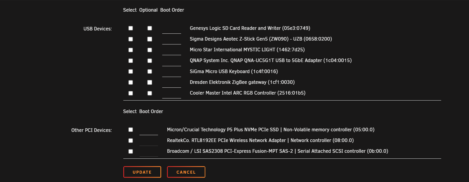

On 11/4/2022 at 5:02 PM, limetech said:
VM Manager
If you boot a VM from a passed physical USB device there is a new setting called Enable USB boot which must be set to Yes. This is due to feature change in the latest OVMF component.
Changes:
  • Add boot order for USB and USB Boot option. Using 'boot order' field VM can boot from a passed-through NVMe controller/device.
I'm a bit worried to update due to this.  I have Windows 11 booting directly from an NVMe already.  Had to fight this boot order thing a long way to get the VM back before.
I've attached my current XML.  Anyone think I may have a problem after this update?
Thanks!
craigr
win11 NOV 16 2022.xml
Edited by craigr
updated xml
Thanks!
craigr
The change is to expose the boot order on the gui.  USB Boot option sets boot dev = 'fd',  which for the new firmware it is required or a boot order for the USB device.
if no boot orders are specified the boot dev = 'hd' is used.
There is a update to the OVMF firmware so not sure if that will change anything for you. But you should be able to set boot order for the nvme to get it to boot, not sure why it didn't work for you.
I cannot see your existing being changed by this update, but there is always a chance it may.
Thank you!
So if you were to check your NVMe drive in form view, what line(s) would be added to your XML?  I really don't want to have to parse through all my XML customizations when they get wiped out, and then potentially fiddle with the OVMF BIOS as well :/
