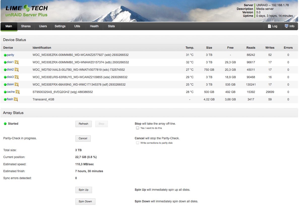

Still haven't removed SF to test the new WI.
Currently parity check in progress. No issues in check speed.
Screenshot attached.
