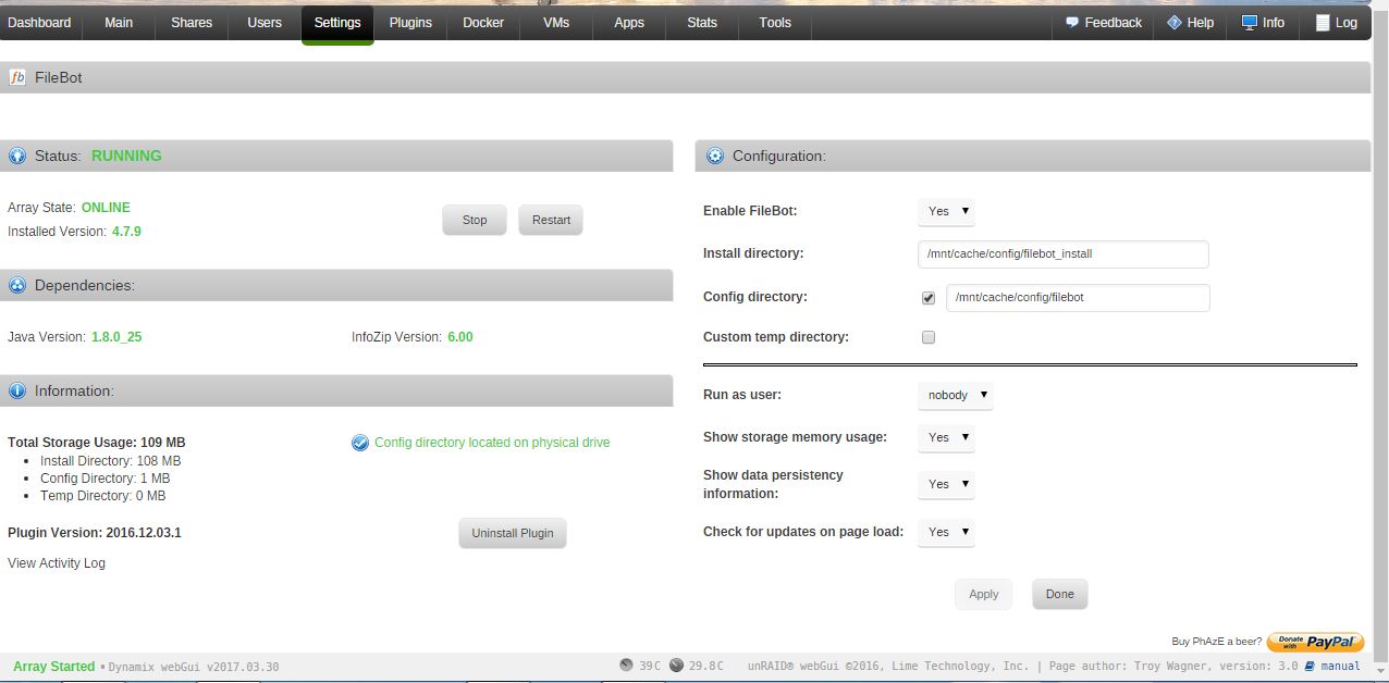

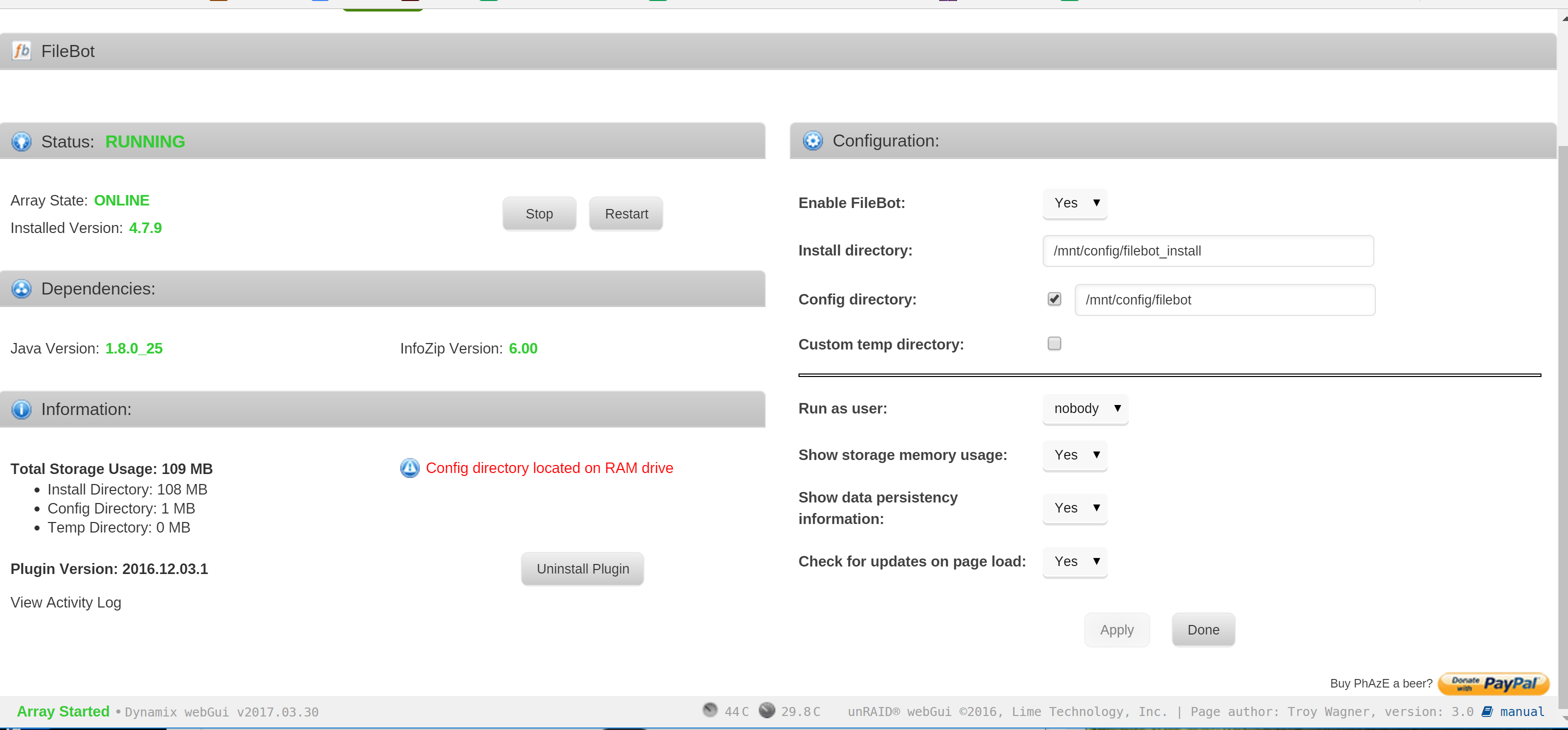

Hello, I have 2 questions please;
1) I've installed the Filebot plugging, see config attached, its running, but where do I configure, folders and actions please?
2) I see a warning about only installed in RAM, I have a large cache drive, how do I put this onto the cache drive rather than the RAM please?
Appreciate the guidance
Edited by huntjules
wrong attachment
Change your install and config path to include cache drive, ex: /mnt/cache/config/filebot...
Make 'config' a cache-only share.
Sent from my ASUS_Z00AD using Tapatalk
thank you unevent I now have Filebot running on the cache drive.
Any guidance on how do I configure what folders filebot watches, and which folders filebot renames and moves? As I can only see this screen below and doesn't seem obviously how to setup Filebot to do its tasks.
