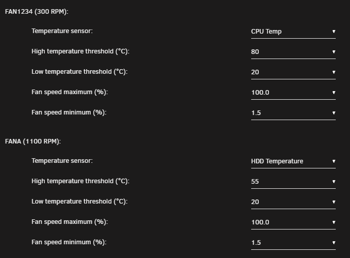

If I can just run through what I've done to make sure I'm not being very stupid, as this is a bit new to me...
My Unraid system is built on a SuperMicro X10SL7-F motherboard inside a SuperMicro SC846 chassis. Up until last week it was running stock fans and quiet PSU, but after a year of working from home, I decided it was time to make it quieter.  I replaced all the fans with...
  • 3 x Noctua 120mm 3000RPM PWM industrial fans in the fan wall.  All plugged into FAN A using a 3 way PWM molex-powered splitter
  • 2 x Noctua 80mm PWM exhaust fans in the rear, plugged into FAN 4 with 2 way PWM splitter
  • 2 x Noctua 92mm PWM fans on a Noctua CPU cooler plugged into FAN 1 with 2 way PWM splitter
As you probably know, this then resulted all fans cycling between low and full every 10 seconds due to the bios-set fan thresholds being crossed.  After researching, I arrived here and was able to tweak the lower and upper thresholds to what I think is OK using the config editor (non-critical, critical, non-recoverable)...
  • FAN 1 (2 x 92mm CPU) - Lower: 0, 100, 300. Upper: 2200, 2300, 2400
  • FAN 4 (2 x 80mm exhaust) - Lower: 0, 100, 300. Upper: 2400, 2500, 2600
  • FAN A (3 x 120mm fan wall) - Lower: 400, 500, 600. Upper: 3200, 3300, 3400
These are broadly set using the Noctua website specs, and stopped the constant cycling.  Haven't yet found a guide on what these values should be.  They were still running fast though, so I enabled fan control, which is now whisper quiet and cooler than before.  Hoping it's OK...
  • Left polling times as default
  • Unchecked my two SSDs in the "hard drives to poll" option
  • I've set FAN1234 to track the CPU temperature with temp/speed ranges left.  This bought down speeds massively, but not sure it's the right thing to do
  • Set FANA (the fan wall pulling air across the hot swap bays) to track HDD Temperature and set the temp limits to 55 high, 20 low
Just spun up all hard drives.  The CPU is at 35C, system 33C, HDD 35C.  Fans 1, 4, A are spinning at 400, 500 1200RPM.  I'm honestly over the moon about how my house is now back to normal noise, and I haven't had any temperature warnings yet.  Just looking for reassurance/guidance.

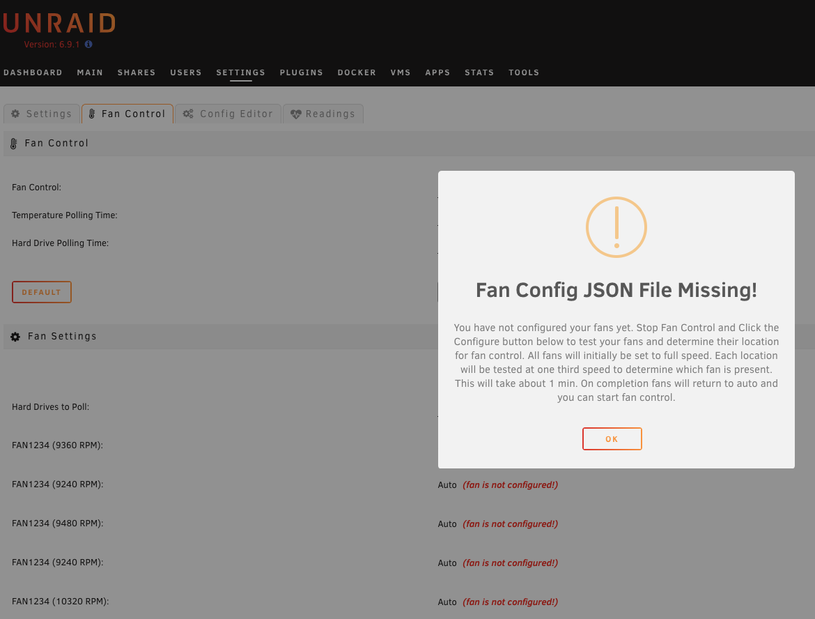

Any idea if you can use the configurator on a Dell PowerEdge R730XD?  I have the 10G NIC installed and the fans go absolutely ballistic.  I've ran the manual ipmitools command which drops them down to 9,500 RPM (ish) which is still VERY loud.  I was rather hoping that I could use this tool to set the speeds lower to say like 7-8k RPM.
I always Get this message when I go to Fan Control Tab.  It tells me to click on configure button but there is no configure button.
Any ideas?

Is there any chance of this plugin controlling the fans, or is it still only for those 2 boards mentioned in the OP?
EDIT: Also, I'm doing something wrong, since when I run any "ipmitool" command from the terminal, I get the output "bash: ipmitool: command not found".
What key step have I missed?
Edited by Elmojo
Many thanks to @wgstarks @TexasDaddy for their assistance. Embarassingl for me, on opening my case to look for BMC mac address 'sticker' i found that IPMI jumper setting was set to 'disabled' (why oh why!) so when i moved the shunt everything was revealed, voila!! An easy mistake to make, oops!
So ... with ipmi set up correctly ive moved on to fan control via this plugin and i havent a clue. Anyone care to post up a couple of screenshots of their settings on a SM x10 board preferably? I think i've managed to get through the screens but i fall down when it comes to the fan control config editor which when i pick 'sensors' from the dropdown list shows absolutely nothing to edit, should it? Or do i have to populate an empty base file. If so, how?
As my board has dual cpus how do these work alongside this plugin? There are nine fan inputs (1-6, A-C) with two currently unused but to be allocated to onboard coolers as a second fan on each.
Assistance so far has been invaluable, thanks.
