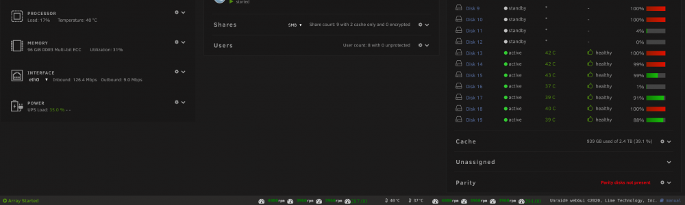

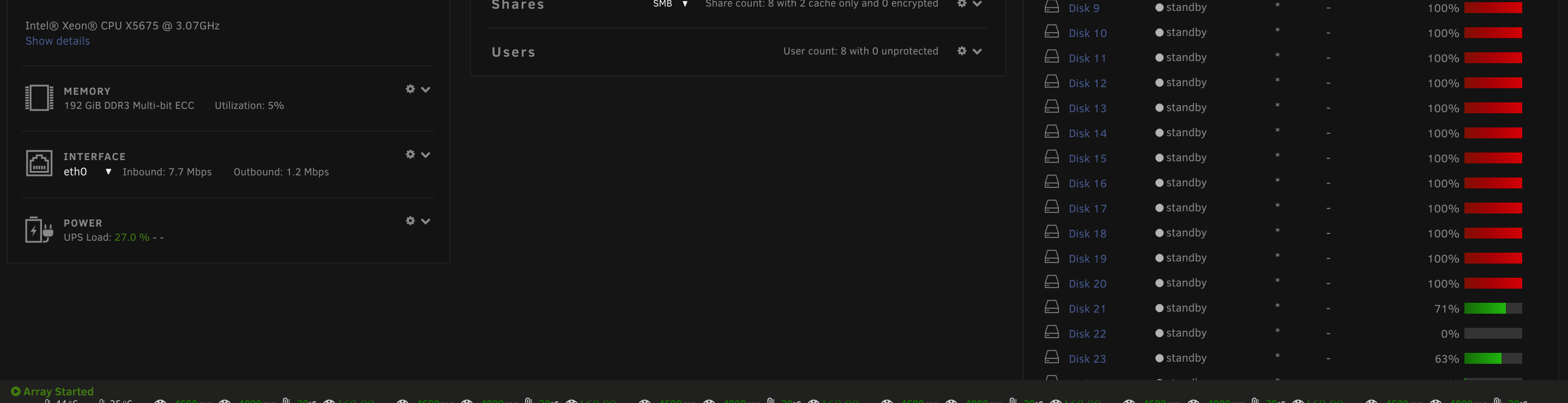

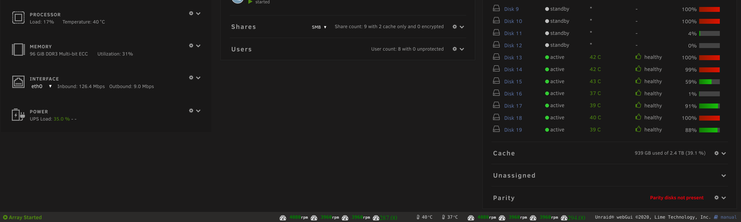

problem with footer display since update. it doesn't look like its refreshing properly, it just keeps duplicating itself. does it both in Chrome and firefox
screenshot #1

screenshot #2262596865_ScreenShot2020-09-15at9_36_52AM.thumb.png.39cfb609fdbdc6999f0693d552d2851b.png
screenshot #3

Fixed one typo but forgot the other. I'll fix when I get home. Until then you can run this to fix.
sed -i 's/impitemps/ipmitemps/g' /usr/local/emhttp/plugins/ipmi/IPMIButton.page
worked! thanks
