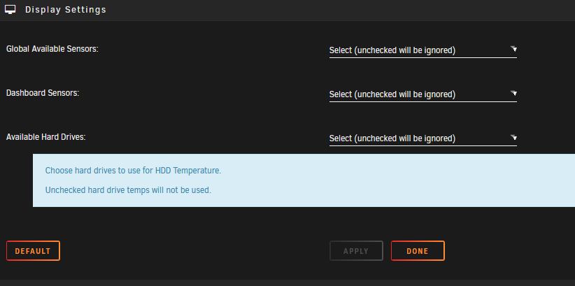

Is there any way to separate SSD HDD temp readings from spinning disks? Because it seems 50C is hard-coded as a red-alert temperature on the footer and the dashboard page even though this is fine for SSDs.
At idle, my HDDs sit at about 47C and my SSD at about 55C. However, the only information I see on the dashboard and in the footer is the max temp (55C) which I'm not bothered about. I never get to see whether my max HDD temp has crept into the 50s.
you should be able to de-select the ssd's from the list here.
