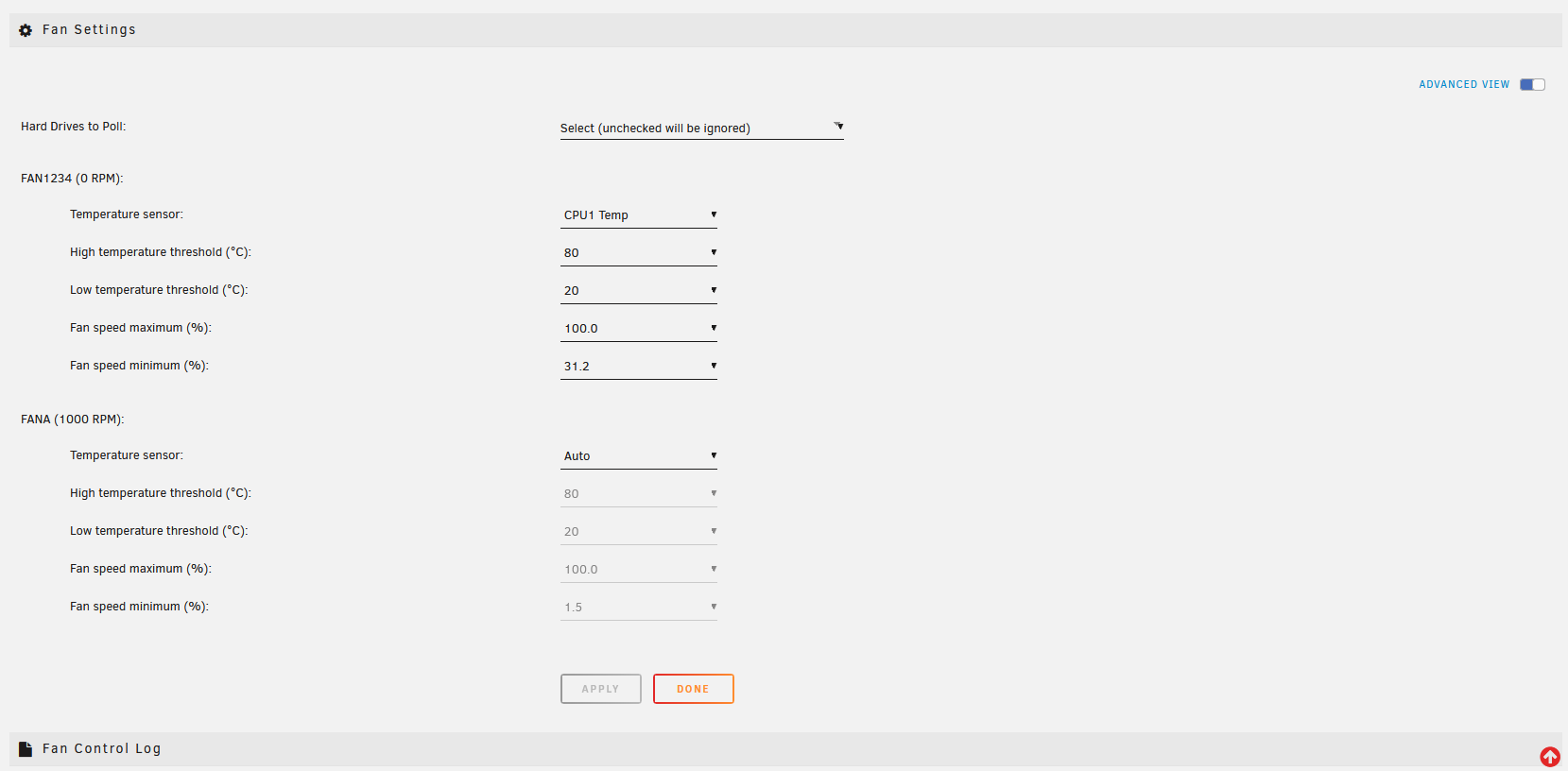

is there now an option to split the FAN1234 and FANA groups up for fan control? I would like to control each fan individually.
My Mainboard is a Supermicro X10DRi.
Thanks.

Welcome to the world of stupid Supermicro IPMI controls. They group fans together and there's not a way you can change that. I haven't seen anyone come up with a code to fix that.

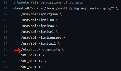

I was wondering how I can reset the plugin, since the IP of my BMC controller has changed. Reinstalled the plugin, which didn't do the trick. Tried also to edit the config and changed the IP there, still the old IP is shown under "settings".
Any advice?
Any advice?
I would start with checking those links to where some people have modified the plugin to see if there are settings files there. I'd bet there is a few ways to figure it out but it depends on where and how far you wanna dig. Probably easier would be to check the plugin page on github and look for the path there.
edit: just a quick look in the install script make this look like a good place to start

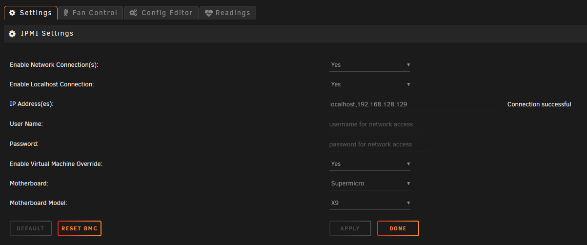

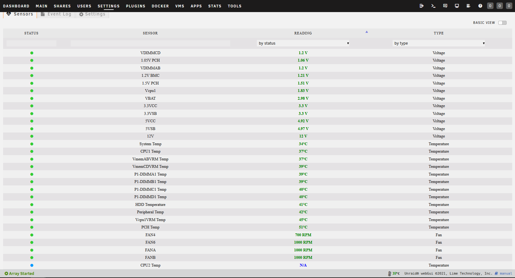

Got it working but I can't see any of the sensors. Using Supermicro X9DRL-3F/iF board. I have Supermicro X9 board selected but won't show anything.

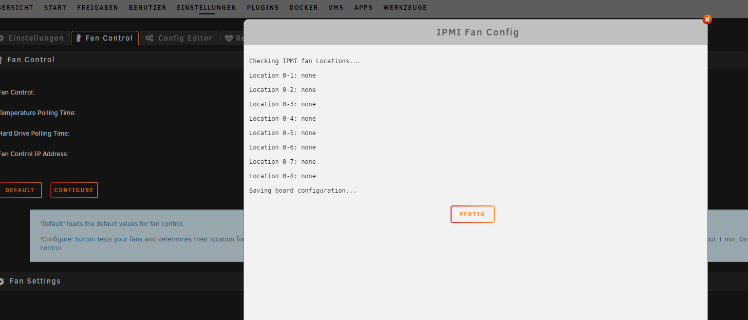

Hello,

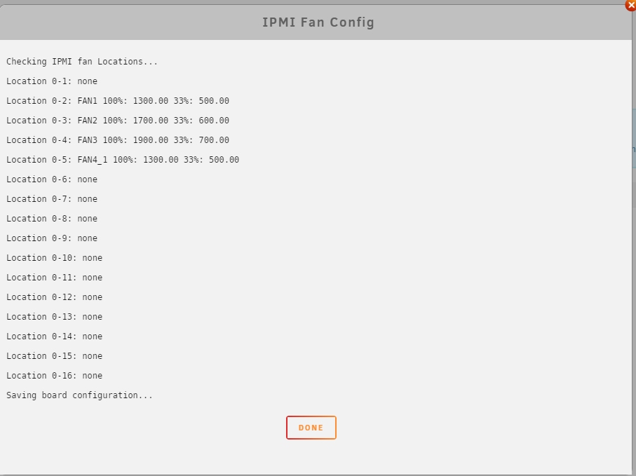

i have a X570D4U Board and the plugin does not change the RPM of the fans. (Fans are in manual mode)
I installed the plugin and executed these two commands:
curl -o '/usr/local/emhttp/plugins/ipmi/scripts/ipmi2json' -L 'https://raw.githubusercontent.com/lucasteligioridis/IPMI-unRAID/master/source/ipmi/usr/local/emhttp/plugins/ipmi/scripts/ipmi2json' && chmod 755 '/usr/local/emhttp/plugins/ipmi/scripts/ipmi2json'
curl -o '/usr/local/emhttp/plugins/ipmi/scripts/ipmifan' -L 'https://raw.githubusercontent.com/lucasteligioridis/IPMI-unRAID/master/source/ipmi/usr/local/emhttp/plugins/ipmi/scripts/ipmifan' && chmod 755 '/usr/local/emhttp/plugins/ipmi/scripts/ipmifan'
Then i run configure and configured the fans to a sensor and temperature.
This is the configure result:
board.json:
    "ASRockRack": {
        "raw": "00 3a",
        "auto": "d8 00 00 00 00 00 00 00 00 00 00 00 00 00 00 00 00",
        "full": "d6 64 64 64 64 64 64 64 64 64 64 64 64 64 64 64 64",
        "fans": {
            "FAN_POS1": "01",
            "FAN1": "01",
            "FAN2": "01",
            "FAN3": "01",
            "FAN4_1": "01",
            "FAN_POS6": "01",
            "FAN_POS7": "01",
            "FAN_POS8": "01",
            "FAN_POS9": "01",
            "FAN_POS10": "01",
            "FAN_POS11": "01",
            "FAN_POS12": "01",
            "FAN_POS13": "01",
            "FAN_POS14": "01",
            "FAN_POS15": "01",
            "FAN_POS16": "01"
Does somebody has any idea?
Thanks. I asked Supermicro Support and they confirmed there is no way :(
Dear ***,
Thank you for contacting Supermicro Computer's Technical Support
[Q] I would like to set up multiple FAN groups for precise FAN speed control. Alternatively it would be fine to control each FAN individually.
[A] Unfortunately, no. User cannot set up multiple FAN groups or control each FAN individually.

I tried several things, but i cant get it to work with my X570D4U Board :(
Since it works for others here, I think it's because of the board.json file.
